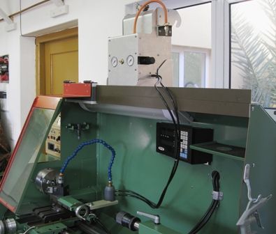

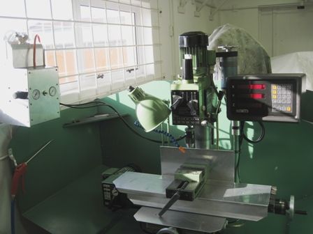

      This weekend I finally sorted my fogless coolant applicator. After many side roads with all sorts of pumps, peristaltic included, I finally resorted to the all compressed air driven system. Previously I could not get the coolant fluid flow rates finely controlled – the problem turns out to be the needle valve flow reducer. I made a few versions and variations, even used an old air-brush, and then used the handle grip/flow valve parts of a hand-held gas blowtorch – and what do you know! It worked beautifully! So, its all done, very nice coolant and air flow rate control, solenoid valve on/off, etc. I made it as a portable unit, so it can be traipsed between the two lathes or the mills. Works a treat!
      Does look as though it should distill something though…

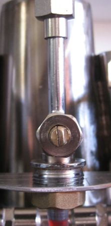

      Gas Torch Flow valve
      In its enclosure
      Flow rates – Air on, about 1 drop of coolant every 4 to 5 seconds
      Air on, 1 Drop every 2 sec
      Air on , 1 drop every sec
      2 Drops per sec
      3 drops per sec
      No Air, about 1/3 max stream flow rate
      Next – fitting and swapping between machines
      Edited By Joseph Noci 1 on 11/06/2017 21:31:44

        My coolant applicator is swappable between all my machines, with not to much trouble…
        Fits above the V10 splash guards

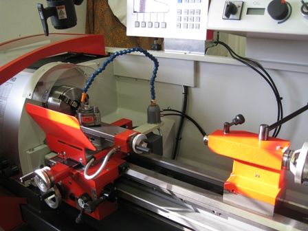

        The nozzle feed assembly has a magnetic base and clips onto the cross slide extension.
        Two pipes are air and coolant.

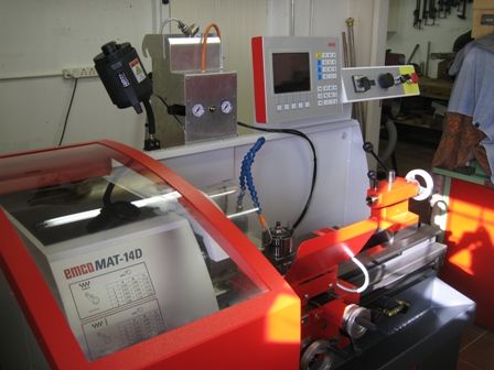

        Nozzle assy on similar extension on the EMCO 14D cross slide
        Unit fits on 14D splash guard, just left of the DRO
        on the EMCO FB2 mill, the unit hooks onto the window burglar bars next to the mill…
        With the nozzle applicator clamped onto the vertical head.
        Glad that is done!
        Joe

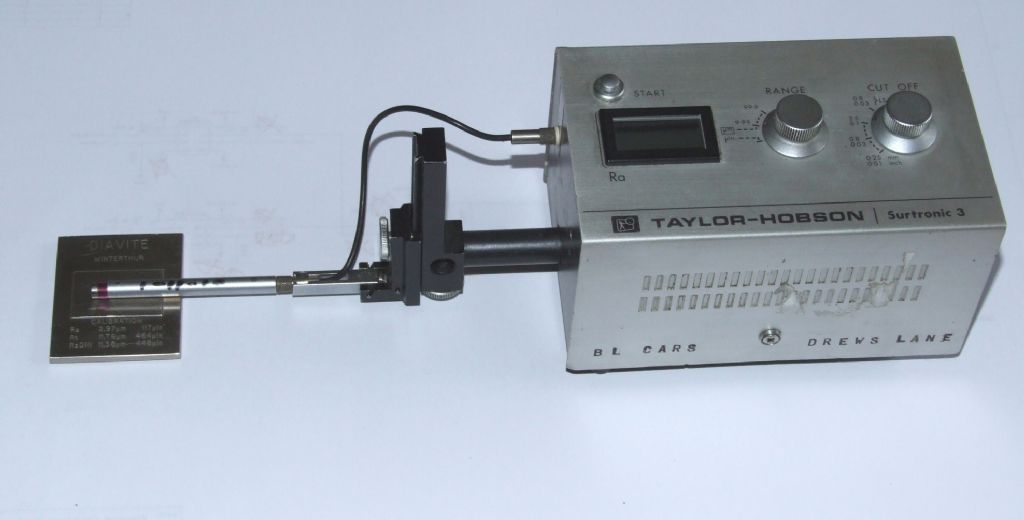

                  Out of idle curiosity I did a quick trial this afternoon. Material is EN3B, which can be tricky to get a good finish, diameter is 1¼". The HSS tool was one I dug out of the toolbox, hasn't been used for 50 odd years, and is probably 70+ years old. I gave it a quick lick on the hand grinder and added a small radius with a diamond hone. The results:
                  Right most was 0.05" DOC, 4 thou per rev and 540rpm. Moving left was 0.03" DOC, 2 thou per rev and 370rpm. Roughness measurements are:
                  Right: 5.43µm Ra
                  Left: 3.11µm Ra
                  To me the finish isn't great, especially at 4 thou per rev, although the swarf was curling and breaking beautifully, just like an insert should do, but at lower feedrates.

                          Correct that surface roughness measurement ideally needs a special instrument. Basically it's a record stylus and a measurement circuit. Mine was secondhand and measures Ra (average) as that was simple to do with the electronics of the day. Here's the kit, complete with comparator coupon (and the name of the original owner):
                          Surface Roughness Measurement
                          Measurement of Rz (peak to peak) is now popular, and easy to do with modern electronics, and possibly a more useful measure.
                          You can also get Rubert sets which are electroformed plates of varying roughness and with the characteristics of various machining techniques:
                          Rubert Set
                          Mine was also secondhand, but they are still available new:
                          **LINK**
                          For the sort of finishes one would expect from turning the fingernail is surprisingly sensitive and perfectly capable of assessing roughness in conjunction with a Rubert set.
                          Of course it isn't essential to be able to measure surface roughness. I just like to be able to put numbers on parameters so that I can make sensible comparisons.

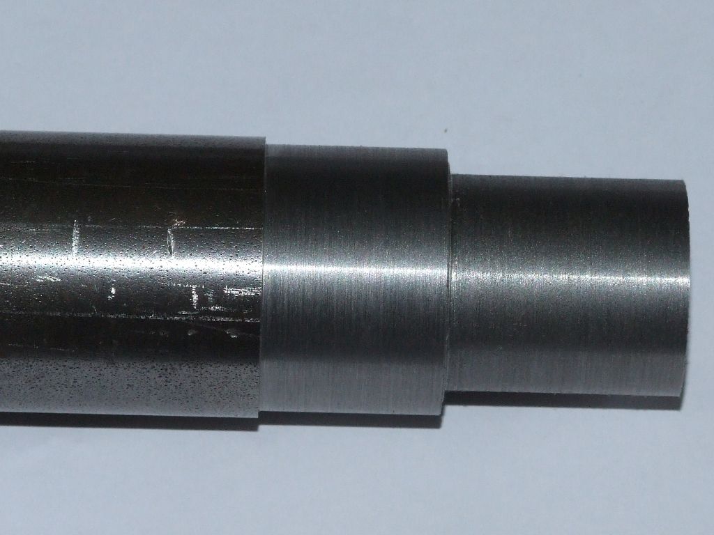

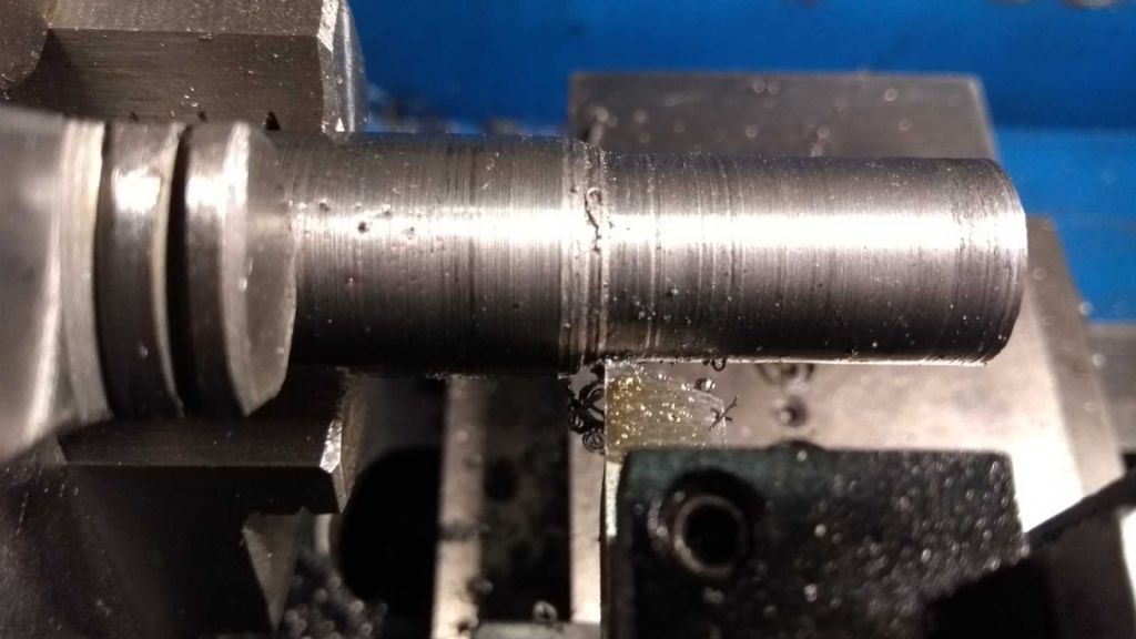

                            I've put the leadscrew gearbox back in with 20/80/20/80 which I reckon gives me 5 thou per revolution (0.125mm).
                            5 thou cut (0.125 mm) and about 400 rpm. I ground a fresh tool.
                            What I find interesting is that the middle bit isn't bad (well, by my standards). There's a very fine groove and then suddenly it goes messy. All this is under power and me not touching it (apart from the press the half nut bit down securely).
                            after an earlier attempt I tightened up the lock nut on the spindle to add some preload. But its as tight as I want it to go for now as I don't want to risk damaging the thing (well its as tight as I can make it without grunting seriously).
                            It seems clear that there's something loose somewhere, but where?
                            I've not had the saddle off, but it seems firm. The cross slide has some backlash, and one of my jobs is to re-adjust the screws holding the screw and this time put some loctite on as they loosen up very easily.
                            Just keep pissing around with it until it works better, I guess.

                                    I don't think that the evidence supports that. My Harrison has at least 10 thou backlash on the cross slide, and I can move the cross slide back and forth by hand. But I can still achieve a good finish.
                                    While rigidity helps, and has an effect on the metal removal rates, it has less effect on the finish. The key is achieving a stable cutting action. It doesn't matter if the lathe moves a bit under the cutting forces, as long as the movement is stable.
                                    I've had cuts produce results exactly like what you are getting. I think the issue is within the cutting action rather than with the lathe overall. Some materials, especially EN3B, seem prone to tearing if the cutting parameters are wrong.
                                    Your DOC, speed and feedrates look fine. So there are two other aspects to look at. One is the material; what is it and where did it come from? When I first started with my Harrison I had a similar problem with an inconsistent finish, and got quite down about it. Then, for work, I visited a local machine shop and as an aside asked them about material suppliers. I mentioned that I'd bought steel from a well known supplier in Cambridge. They said don't buy their steel it's inconsistent and gives a poor finish. I bought some more steel from a larger stockholder; and got a good finish straight away.
                                    The second issue is the tool. It is difficult to tell from the picture but it doesn't look like it has much in the way of top rake? While the angles on tools are not critical they do need to be in the right ballpark. Top rake is the one thing I changed on the toolbit I picked out to get the finish I showed. From the box the top rake was only a few degrees and didn't give the finish I was looking for. So I reground it to be around 10° or so. That gave a better finish and much better chip control. The chips then curled round and forwards, and broke off in front of the tool in the direction of travel.
                                    Ultimately, and not withstanding my waffle, it's all down to experiment. And the more experiments you do the better the heuristic database you form for speeds, feeds and DOCs that work.

                                      Posted by Andrew Johnston on 13/06/2017 09:03:10:
                                      Posted by Iain Downs on 12/06/2017 21:22:22:That gave a better finish and much better chip control. The chips then curled round and forwards, and broke off in front of the tool in the direction of travel.
                                      Andrew
                                      I'd go along with that. Certainly something I didn't appreciate for a long time. If the chip is being forced into the newly cut surface it is going to be detrimental to the finish. I'm currently on a big George Thomas drive in that I have spent several months going through his books and building quite a lot of his workshop equipment. In the course of this I have taken note of many more of his comments than I would have otherwise done. One aside regarding screwcutting was when using the set over technique at one stage he was getting a ragged surface on the flank opposite to that being cut. He tracked this down to the chip passing over the tool and rubbing on the flank of the tread and spoiling the finish. His answer was to change the geometry by setting to slightly less than 27.5 degrees (whitworth form) and allow the tool to take a small cut from the back flank which cleaned up the whole thread.
                                      So as Andrew says take note of where the chips are going and relate that to the surface finish.
                                      Happy turning.
