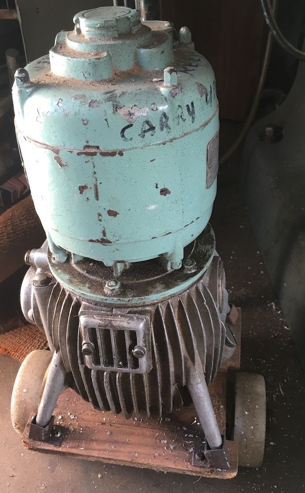

                        The Binks-Bullows Hydrovane compressors, once used to run continuous air flow sprayguns, are an excellent quiet running source of moderate pressure air. Come in 30 psi and 40 psi varieties. Industrial quality 1/3 rd hp motor and tank level build quality. I imagine they deliver around 2 or 3 cfm. Mine is just the job for running the Bjur Spraymist units on my lathes and mill. One day I'll find 2 more so I don't have to share! Typically £40 to £60 on the used stuff market and, apparently, impossible to wear out in a normal lifetime. Unless you run it dry of oil.
                        Hydrovane also made a boxed unit for the pub and hospitality industries. Higher pressure output, may be 1 or 1.5 hp motor in a box around 18" cube. I've never seen one in the flesh but it looks to be a potentially useful device.

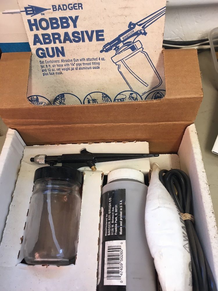

                        Sandblasters, like compressors, come in a wide variety of sizes and abilities.
                        For folk like us the distinction is between the smaller, lighter duty ones most suitable for surface preparation before painting or heavy duty cleaning and those able to shift substantial corrosion, strongly adhered paint et al. Realistically something in the "overlap" range is where most model engineers will be shopping.
                        This little chap is basically a Badger airbrush on steroids. Air consumption is minimal and it will do a nice job of putting a matt finish on shiny metal ready for painting. Good luck with shifting anything much more than a felt tip pen mark or (very) poorly adhered paint tho'.
                        I'd regard Jasons unit as being around the top end of the paint preparation range devices. As Jasons pictures shows it will quickly shift modest surface corrosion and similar. Dealing with deeper corrosion and such like, as in vehicle restoration, is really above its pay grade. Occasional use on small parts maybe but it will be very slow.
                        If you need to shift deeper corrosion et al with a limited air supply the spot blast guns with a sleeve surrounding the nozzle that pushes against the part to constrain air, and media, distribution are pretty effective. Takes a while to do a reasonable size part in 1/2" diameter spots but they do use less air and are less messy. The nozzles tend not to last well and finding replacements can be difficult. I have one for spot work on big stuff.
                        My Guyson cabinet is bottom of the pro range. It will cope with most things but would go much better with a larger compressor and nozzle. Tends to be overkill for surface preparation.
                        As ever its a matter of finding the best balance between what you want to do, what you can accommodate and what you can afford. The latter usually rules.

                              A reasonably modern Hydrovane in clearly un-abused condition at a fair price is hardly a risky second hand buy. Reasonably modern tank mounted units in sizes we are likely to use means 501, 502 or HV01, HV02. Maybe a 15 in "one lady owner, only driven to church on Sundays" condition. But the 15 is getting pretty old now. Basically round, painted, air end style. Fair price is maybe £400 and up. Air controlled solenoid valves and motor coupler are the most likely issues. Relatively easy to sort but rarely reflected in the price. Look for a better one.
                              Three phase 501/HV01 compressors are often rebuilt into single phase 502/HV2 versions of double the output by fitting a 2,800 rpm motor instead of the 1,400 rpm one. Safe enough as its basically what the factory do but if this has been done its clear evidence that someone has been fiddling. At pushing £200 for a motor you have to wonder at the economics of the job and condition of the donor air end. £600 plus from a reliable supplier or walk.
                              You don't get owt for nowt and bargain shopping around the elderly, sort of oval shape, unpainted aluminium body Hydrovanes is basically asking for serious grief. Parts pretty much can't be got and reassembling one is the sort of jigasw puzzle not to be attempted by the untrained.
                              Three phase variants run fine on a decent brand inverter as supplied by the likes of Inverter Drive Supermarket. Following their advice I've set 502's up on Schnieder and Eaton DE inverters with very satisfactory results. One in a cold barn needed the high torque setting to cope with sub freezing conditions tho'. Which suggests that a low price no name import might not quite be up to the job mid winter. Compressors in general need the torque boost setting on inverters unless the inverter is oversized.

                                                      Iain
                                                      Can't recommend your new strategy.
                                                      As I rarely need air in the garage mostly for air over hydraulic bike lift, tyres an odd blow gunning, I picked up a "not quiet" SIP oil free Airmate 215/25 at the right price to sit in the corner. 1.5 hp, 6.5 cfm displacement = about 4 cfm FAD and 8 bar pressure sounded good. Specified noise level is 97 dBA. I didn't realise just how loud that was.
                                                      Bad move. The racket is horrendous. Impossible to work when it cuts in. Even with my very poor hearing.
                                                      Hafta remember to turn it off once up to pressure to operate the bike lift lest it make me jump out of my skin by starting up unexpectedly.
                                                      Turns out that all the piston type compressors I'd built over the years were pretty quiet.
