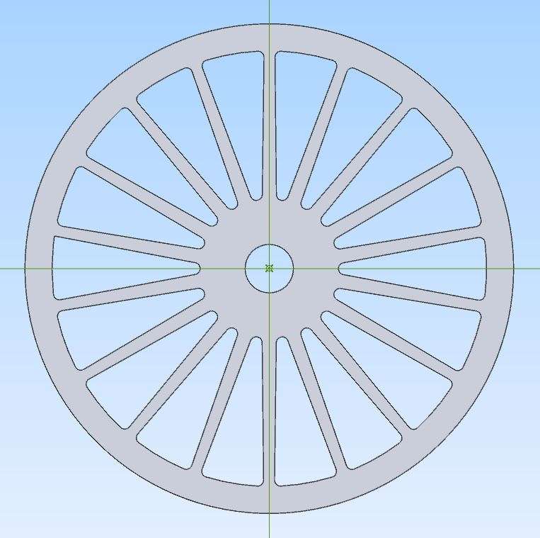

      I am trying to cut the spokes for a 1 gauge Green arrow driving wheels.
      the wheel size is (old money values sorry) 2.530″ OD ,18 spokes ( so thats 20 degrees on the table) to finish at 0.055″ at the rim to 0.077″ at the hub.
      At a loss on how to correctly machine the angle.
      everything is centred and i can get the correct number of spaces but the angle has me stumped.

        Basically you offset the rotary table centre relative to the cutter path to get the spoke width and tweak the actual angle setting to get the taper.
        So using round numbers and assuming the cutter is of zero diameter to make it easier to see what’s going on. Think laser cutter I guess. If the spokes were parallel and 0.100″ wide you’d offset the RT centre by 0.050″ to one side and go round cutting one side of the 18 spokes. Move it over 0.100″ so the RT centre is 0.050″ offset the other way and cut the other side of the spoke.
        As the spokes are tapered set the offset for the wide end and adjust the angle on the RT so the line of cut is deeper on the narrow end giving the desired taper.
        In the real world you have to add a further offset of half the cutter diameter to get the cut line in the right place.
        If your trigonometry and geometric visualisation is less than wonderful this is the sort of thing that is likely to net you a whisky bottle size hangover headache without the pleasure of emptying the bottle first.
        Playing with CAD makes it all much easier.
        Good idea to mock things up on paper with pencil or slender felt tip pen / sharpie in the spindle and a suitable backing board in the RT to support the paper. Draw out something simple, four spokes are plenty, and try to trace over it. When the penny drops after 3 or 4 goes you will wonder what the problem was. But until it does …
        The trigonometry involved is fairly straightforward. I imagine Jason or one of the other CAD jockeys can easily show you that. My trig is well up to such things but I found getting the visualisation straight for the moves needed first time through tricky.

                Playing with what the ID of the rim may be and how far towards the hub you can get with a 1/16″ dia cutter this is what you will likely end up with. Angle is between 0.6 and 0.7 deg so I would be inclined to use 40mins as it’s an easy number to read off the R/T. But give the numbers I asked for and you can have it exact but will have to wait until the morning.

                      Bit of trig or CAD will give the taper angle, Rotate rotary table to that angle, offset according to cutter, cut. Then assuming it is a 90:1 R/T just 5 full turns and cut the next and so on.
                      At this scale one only needs scribe any hub shape or counterbalance at the rims and then stop the cuttes at the lines. Yes CNC will make it easy but best to have the underlying ability to do it manually. In pravctivce looking at the image I posted the cutter diameter leaves a far larger diameter hub than scale so you can just stick the driving pin where you like.
                      If the OP comes back with the dimensions or better still posts an image of the wheel drawing then I will show how the angle and offset can be worked out but not worth going into detail with assumed sizes.
                      As for the Nice drawing I worked out a hub dia of 0.441″ and assumed an inner rim dia of 2.25″. Until teh OP chips in I’ll leave you to work out how I got the 0.441″

                            For th esize being dealt with it would not be hard to produce something like this with just a basic rotary table and mill. 1 setup for the spokes and a couple more simple operations to do the hub and integral balance weight.
                            green arrow 1
                            I based it on the cast wheels of a larger scale model but with the machined spoke area little more than 2″ across is any more detail needed?
