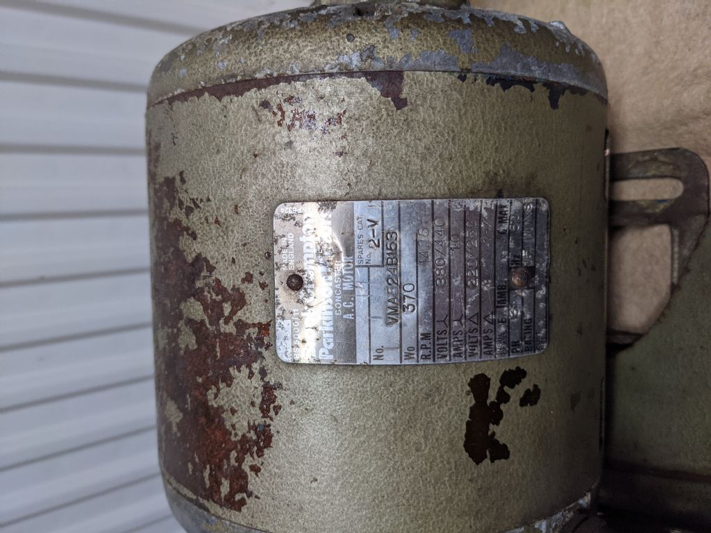

        I would like to mount a VFD on the side on the motor of my Startrite Mercury pillar drill. The motor has no points to attach onto apart from its own mount which is welded onto the casing. The middle part of the casing is not cast (the ends are alu castings) so I guess mild steel. I have not been able to get the end castings off, so I'm thinking about making a mild steel bracket and spot welding it on with stator/rotor/windings in place.
        I have a stick welder and would drill a couple of 3-4mm holes in the bracket and spot weld it onto the motor casing. Is this a feasible approach or do I run the risk of damaging the insulation on the windings?

          The windings will be on the inside of the laminated stator, which is probably pressed into the outer casing. So long as you stay away from where the wires go from the junction box to the end of the stator you should be fine.
          I actually had to weld up a crack in the casing of the feed motor of my lathe. The cast iron casing had been split when the end bells were pressed into it.

            I have done a similar stick weld. On my motor the windings were clear of the outer shell, it go warm, I didn't linger, did a short run, left it for while to cool then a little bit more. I was fixing the mount for small 3 phase motor on my Fobco drill and I was also going to use VFD. John

                    I've welded stuff to motor casings several times never had a problem. I welded ally feet to an ally cased motor with a 200a tig welder and even that didn't cause any problems.

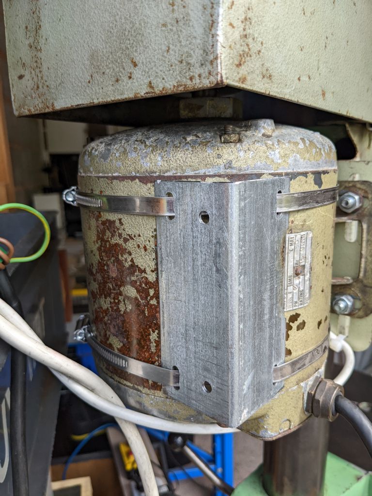

                      Hi all, I finally got around to this job. In the meantime I thought about using a couple of large hose clips, so went ahead and tried it. It is very solid when the clips are tighten up and just need a plate to mount the VFD on then and bolt onto the bracket. Should it ever come lose it will get 4 tack welds to sort it.

                        Big hose clips like that do just fine holding up chimney liners and the like so you should be OK.
                        The big ones are cheap from building supply places and very useful for strapping stuff together when doing the common temporary the becomes permanent job. Handy for welding positioning too 'cos they don't melt like the plastic zip ties.
                        Couple or four of the big hose clips and a packet of the big, lever release, zip ties are an essentail foundation of any self respecting bodgers workshop.

                          I like that solution much better than welding. Looks good and solid and can be adjsuted or changed if need be.
