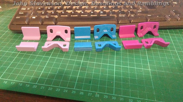

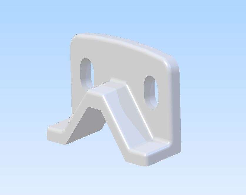

              Got a 3D printer? if you use one of the flexible filaments then you can print a set of wipers. This is one I drew for the late JS to go on Debs Colchester Bantum
              wiper

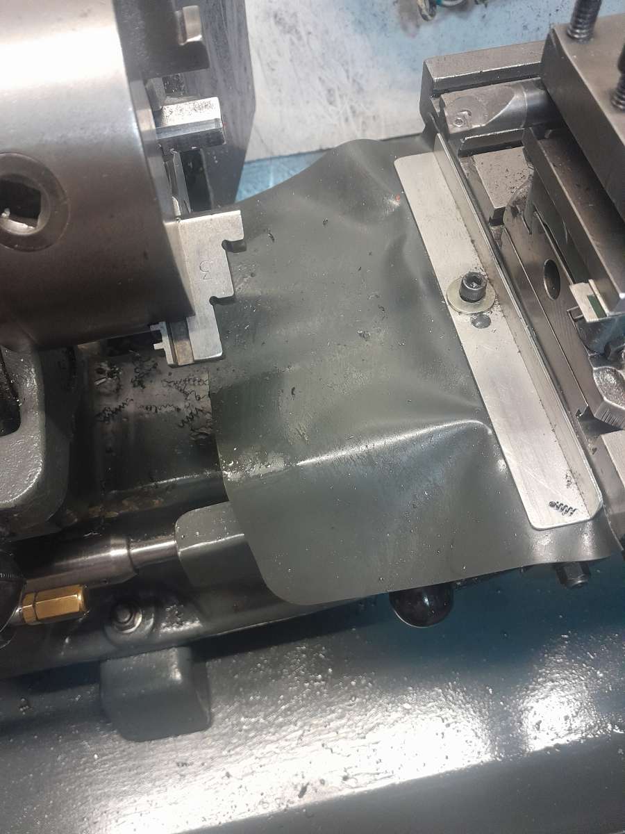

                  A sheet of neoprene attached to the leading edge of the saddle keeps 90 per cent of the swarf away from the ways. Mine is about 120mm wide and runs full width of the saddle, so it protects the leadscrew to some extent too. I just replaced mine with a sheet of silicon oven mat, about 2mm thick, so red hot chips off carbide tooling don’t melt into it.
                  On the Myford it is easily attached by a strip of metal laid across the front of the saddle and held down by a screw into the hole provided for the travelling steady.
                  20250908_184632

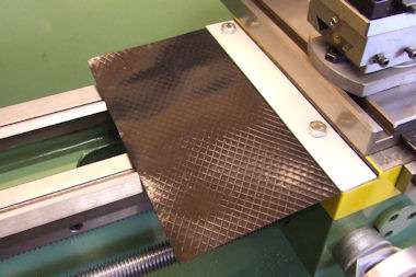

                    Similar on my WM250 using a length of plastic DPC material sandwiched between two bits of aluminium flat.
                    waycover
                    I have just used a couple of hex head bolts to hold it in place but you could make a couple of knurled head screws. The bolts / screws use the mounting holes in the saddle for the travelling steady and serve the other function of preventing ingress of swarf to those holes.

                            • I use both. Regulation felts plus the plastic “bib” to minimise chips getting into the felt. It’s not a new idea, just an update of the sheet metal trays that were described in many of the old books by Sparey, Duplex etc. I tried them but they always seemed to get in the way, catching on extended chuck jaws etc  and needed removing for many jobs.
                            The sheet of silicon baking mat sits down flush with the ways, drops down into the gap, and can be rolled up out of the way if needed. Very handy. It is only 0.5mm thick (not the 2mm I wrongly said earlier) yet seems to be indestructible. Earlier versions using bits of rubber and even vinyl cut from an old handbag all did not wear or age so well.
                            PS. And using a piece of aluminium angle to retain the silicone sheet, with the sheet wrapped around it up the vertical side, swarf is kept out of the cross- slide moving surfaces, an added bonus.

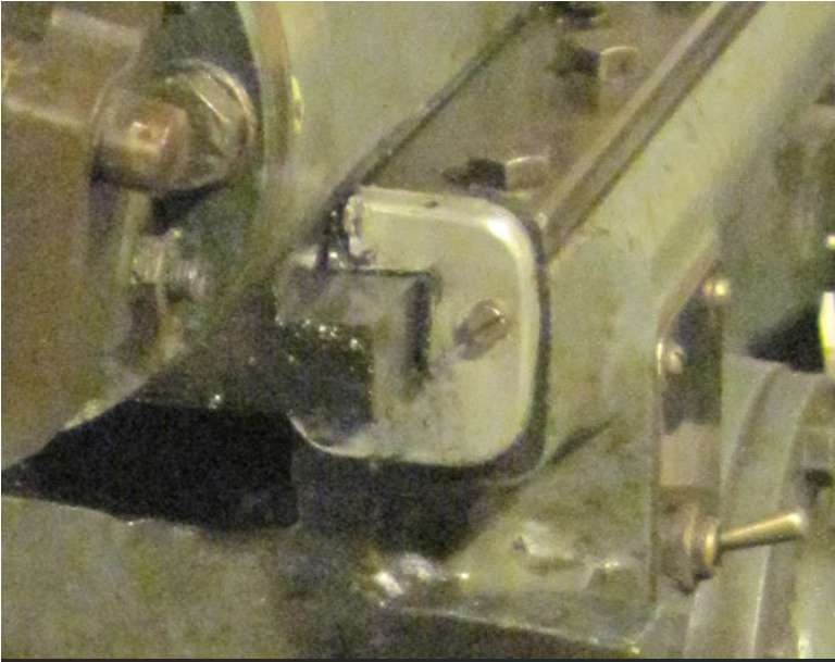

                                        To answer Dave H’s comment about being able to keep the felt oiled, the aluminium covers have an oiling point in the top. Below is one such wiper fitted to my Atlas 7B. They work very well. I do remove the covers occassionally to clean/wash-out the felt (it gets dirty over time) but there is very little swarf (if any) present.
                                        Regards,
                                        IanT
                                        Atlas_Wiper
