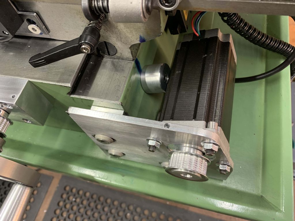

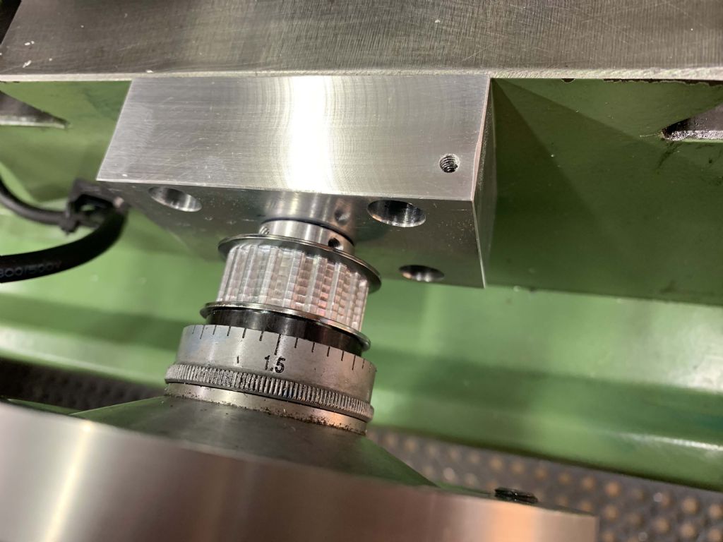

      Have not seen the done to many Warco milling machines and have wanted to do this for a while. After I decided to replace the Nema 23 on the Z axis with a Nema 34 stepper motor I then had a spare Nema 23 and Controller for the Y axis project.
      So, you need a Name 23 Stepper Motor, I am using the 3Nm one and the controller bought from Stepperonline –HERE–
      I already have a power supply, 48v so going to use that. You will also need a PWM like this –HERE–, a change over relay, a double pole double throw on/off/on switch to control forward and reverse of the motor, a on/off power switch, a LED light (Optional) and some sort of limit switch.

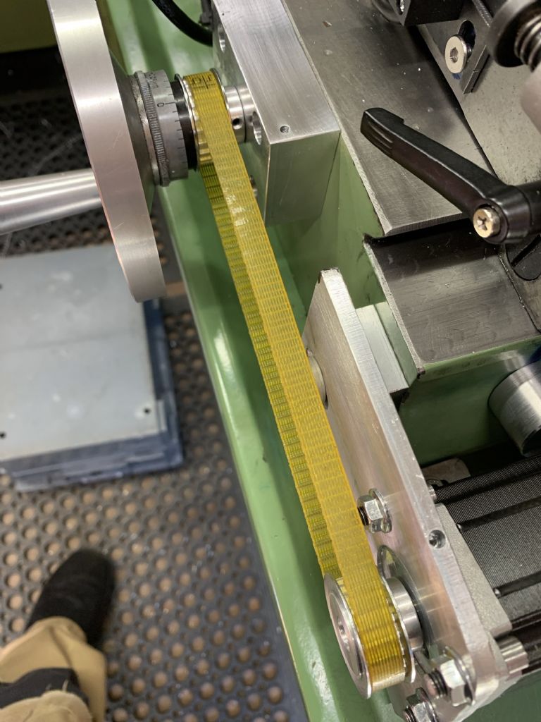

      I decided to go with 1 to 1 ratio pulleys and belt which I bought from CNC4U. So everything would fit I bought the 10mm pulleys.
      Here is where I am up to today, I am awaiting the PWM and a replacement belt and the one I got was too short (Schoolboy error)

            Nice project !
            I’m happy to accept that it’s a trick of the light, if you say so … but those timing pulleys look rather rough.
            Ref. __ https://www.cnc4you.co.uk/Pulleys-Pre-drilled-with-Grubscrew

                Posted by Michael Gilligan on 14/04/2023 10:51:11:
                Nice project !
                Ref. __ **LINK**
                Edited By Michael Gilligan on 14/04/2023 10:56:18
                Crap phone photo. They are nice

                    Got the belt this morning and its the correct size this time, YAY

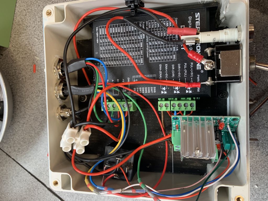

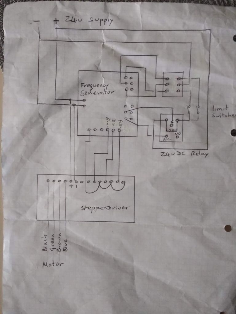

                      As a matter of interest what is the reversing switch doing? It should NOT be in the wires to the motor because if the motor is energised (even if stopped) and you throw the switch the inductive kick from the coils may blow the driver. Reversing should be done by changing the logic state on the DIR input of the driver which only needs a simple one-pole changeover switch, or an on/off plus a pullup resistor.

                          Posted by John Haine on 14/04/2023 11:41:10:
                          Its done via the PWM
                          As this is my second stepper power feed, i know what i am doing
                          this is the wiring
                          The push switches on the frequency generator board were removed and wires soldered to the points shown.
                          A double pole double throw switch with centre off was used to control the direction and on/off. Shown top right.
                          A relay was necessary because to start the motor the switch wires are opened not closed as expected.
                          Edited By petro1head on 14/04/2023 15:21:00
                          Edited By petro1head on 14/04/2023 21:38:25

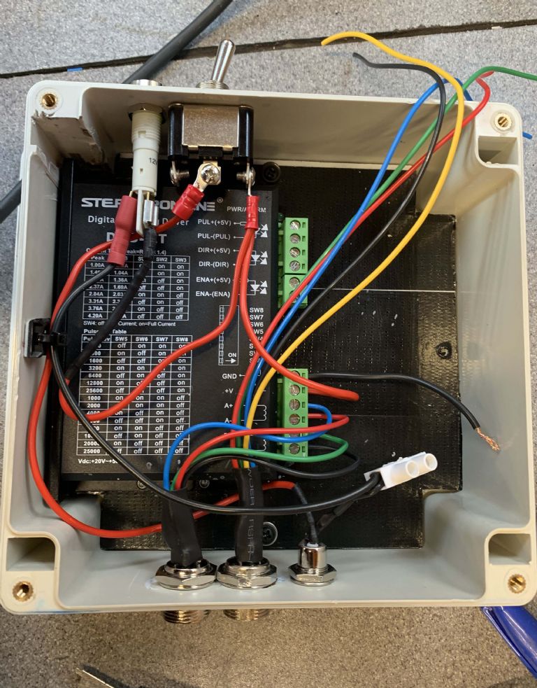

                              Wohoo, just finished the wiring and done a quick test, it works

                              John Haine
                                @johnhaine32865
                                Posted by petro1head on 14/04/2023 14:58:20:
                                Good.

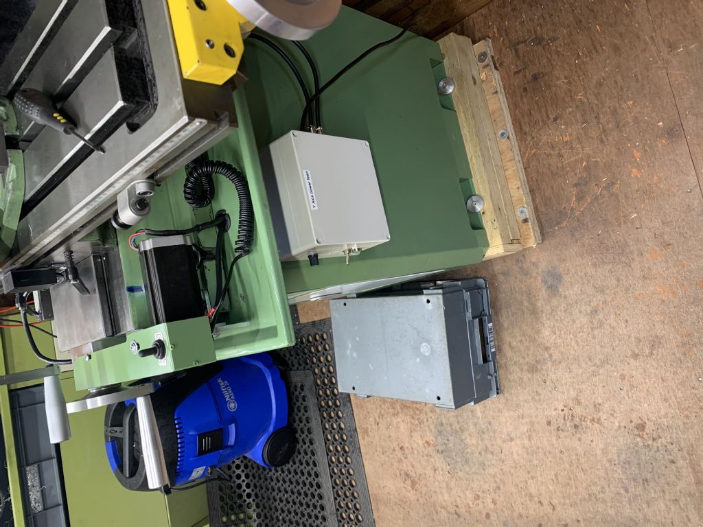

                                  Fished control unit wiring
                                  All i need to do is tidy up the external cables etc

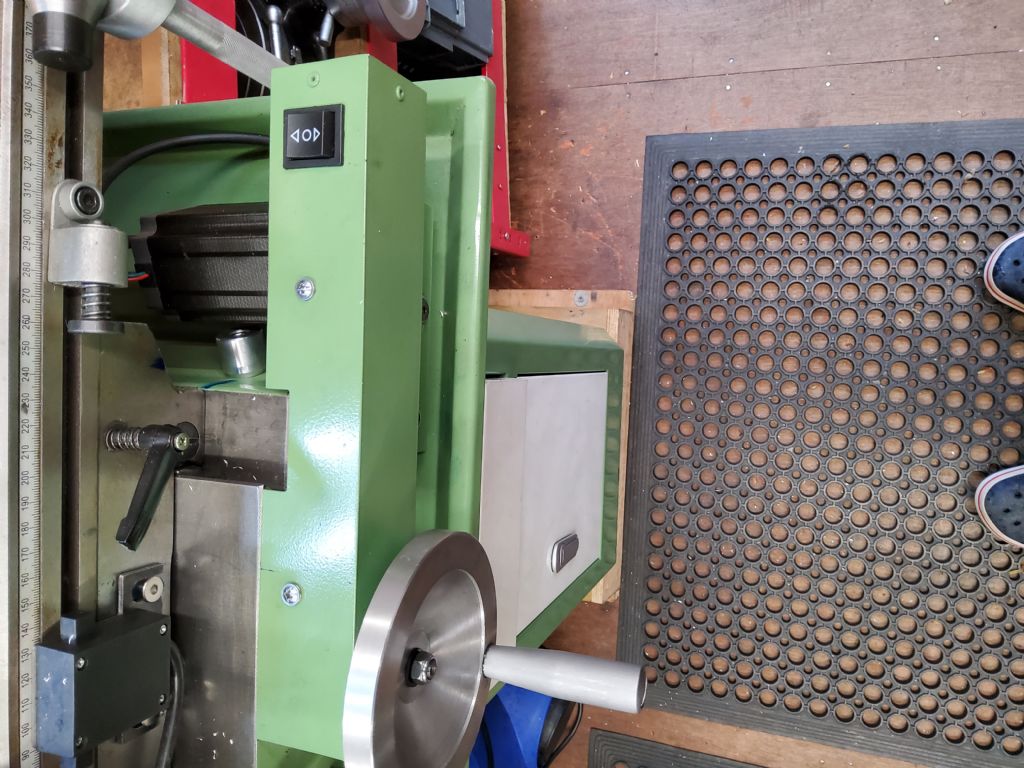

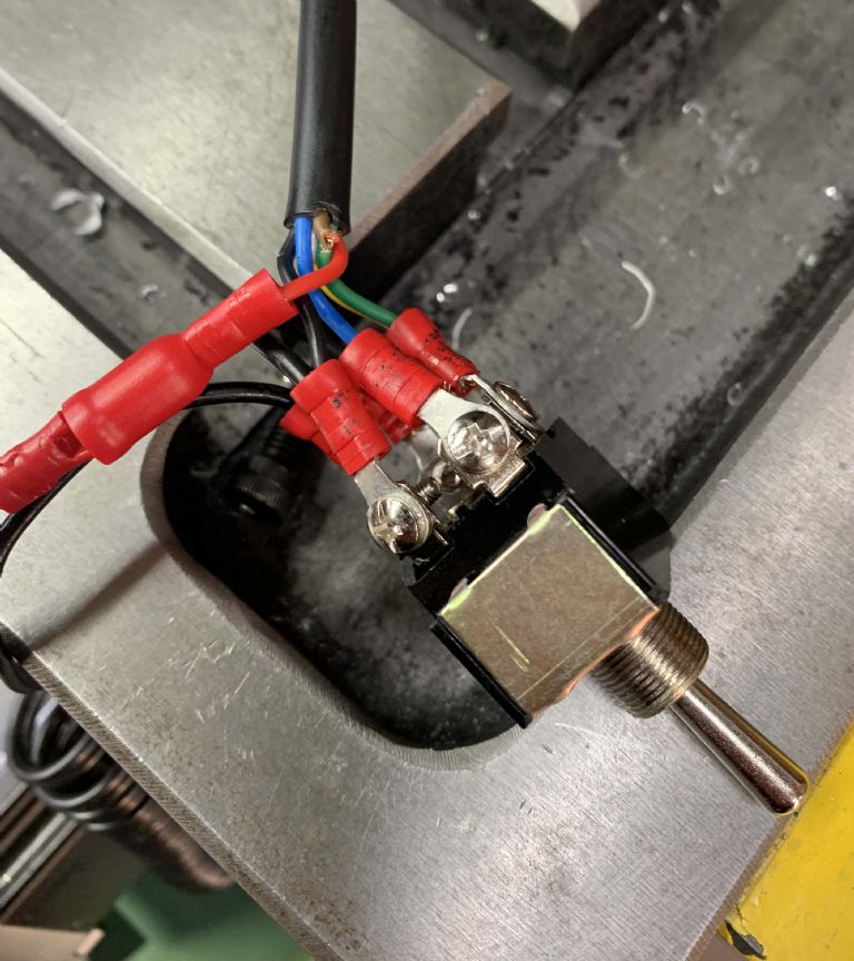

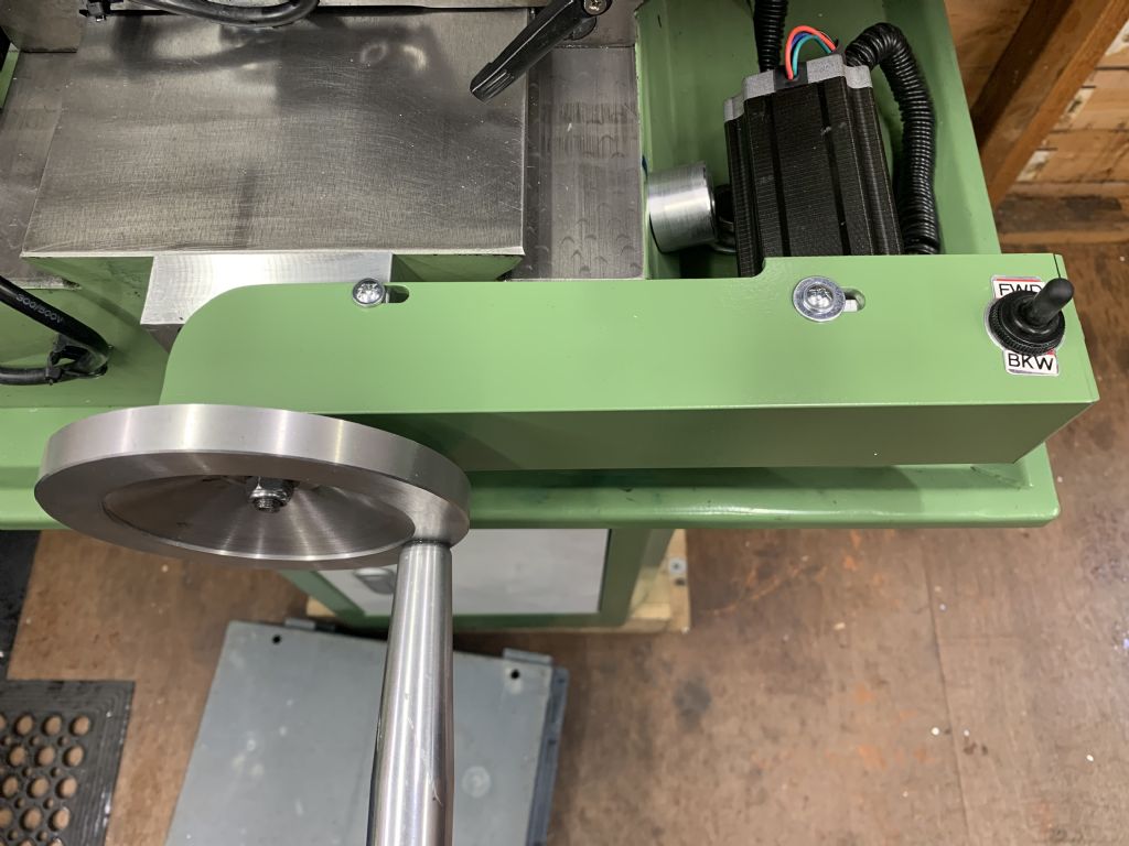

                                    Just an update. So far its been excellent. The only mods since the build is I replaced the toggle switch with a rocker one as i sometimes caught the toggle with my coat and the cover.
                                    Edited By petro1head on 12/05/2023 11:18:45

                                      I assume you have a DRO on the Y axis and that is why the dial is obscured?
                                      Can you disengage the stepper motor and if so, how did you do that please?
                                      Bob

                                          Posted by Speedy Builder5 on 12/05/2023 12:29:52:
                                          Bob
                                          Yes DRO fitted x, y and z.
                                          No, i dont dissengauge the handwheel

                                            #644907
                                            John MC
                                              @johnmc39344
                                              Nice project !
                                              Ref. __ **LINK**
                                              Finish has that faceted look associated with hobbed teeth, gears and sprockets like these.
                                              #644914
                                              petro1head
                                                @petro1head
                                                Posted by John MC on 12/05/2023 15:29:31:
                                                Nice project !
                                                Ref. __ **LINK**
                                                #644922
                                                John MC
                                                  @johnmc39344
                                                  Posted by petro1head on 12/05/2023 15:42:59:
                                                  Nice project !
                                                  Ref. __ **LINK**
                                                  Its the characteristic finish when the tooth form is generated rather than formed.
