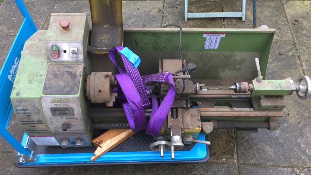

      Hi, I have bought a Warco wm250 today , its a 2012 model and has not been run for a couple of years. I have started the clean up on it and have drained the oil( and scrapped the gel from the bottom of the gearbox) and have order some new oil from warco. My question how do you change/ check the oil on the apron and is there anything else I should look for ?
