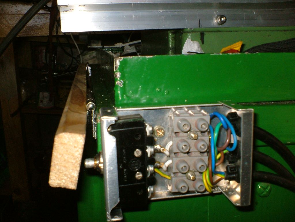

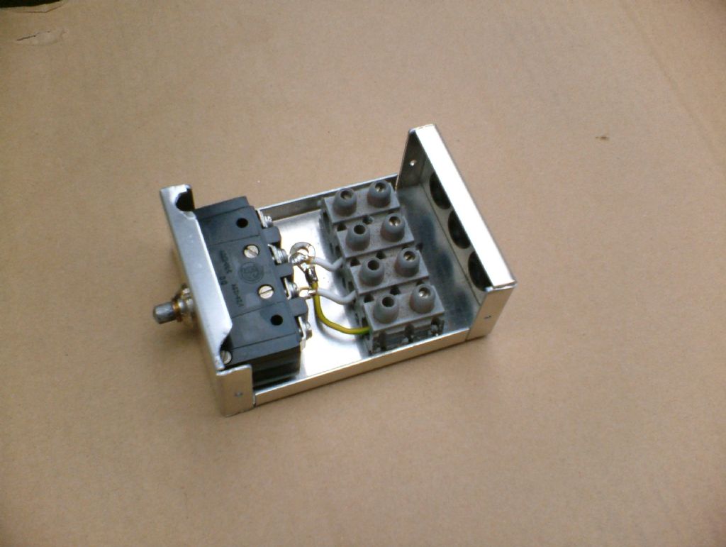

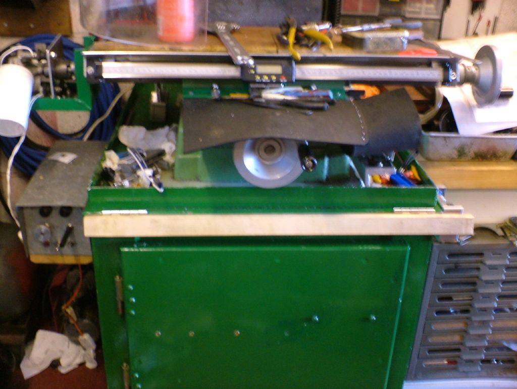

                  mill emergency stop 3.jpgmill emergency stop 2.jpgHi Terry,
                  It looks as if the simplest method is to interupt the mains feed to the milI. I have done this on my mill by by inserting a 40A microswitch in the live feed to the mill. This is operated by a strip of wood hinged to the mill base in easy reach. When operated this knocks out everything and resets the no volts switch. Please see attached photos.mill emergency stop 1.jpg

                    #132043
                    Roger Mountain
                      @rogermountain33705
                      Hi Jason,
                      Yes that is right the auto traverse will move when the microswitch is reset if you do not switch the auto traverse off first.The only way to solve this problem would be to power the auto traverse from the other side of of the no volts switch but this would mean getting into the internal wiring of the machine.
                      Regards, Roger
