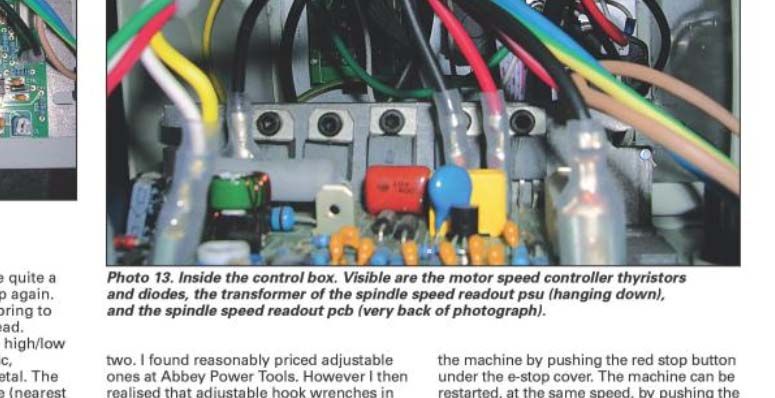

                              Peter G. Shaw
                                @peterg-shaw75338
                                Hi folks,
                                Well I had a look at my controller. Assuming that the largest devices are for the power output, then the mystery deepens even further.
                                I have: 2 off A69108, and 3 off D8010L.
                                The A69108 is a SCR (Silicon Controlled Rectifier whilst the D8010L is a rectifier both confirmed by the PCB legend. But… (there’s always a but!) the D8010L has THREE legs which makes me wonder if it may be a dual diode.  I did also find a reference to the Chester Conquest which also had two SCR’s and three three-legged diodes.
                                So, it  looks as if my MiniMill does not have mosfets!
                                Regards,
                                Peter G. Shaw

                                  Keith Wardill 1
                                    @keithwardill1
                                    Peter,
                                    Just saw your note on the controller board – you are confirming what I have also found out the hard way – there are several versions of the controller boards – some with SCRs some with Mosfets. As I noted earleir, I have seen at least three different board types. I wonder if they are interchangeable (connections, ratings, etc). Makes life very confusing if you need to source spares, or replace controller boards.
                                    D8010 is a high current rectifier diode. One of the three leadouts is unused.  Sounds like Conquest is the same, but I have no personal knowledge of that one.

                                          In MEW No. 145 on Page 33 we can clearly se that also tha machine beeing tested, WMD25LV , has the information on the semiconductors grinded away, this seem to be very common amongs chinese steeringcards and I think this will be a large problerm if the semiconductors brake down.

                                                      It will be exciting to what my mill has for board when it arrives maybe this week or next week.
                                                      If it is a KB-board made in USA, then it will probably be easy to get infomation on exactly what type of semiconductors it is equipped with.
