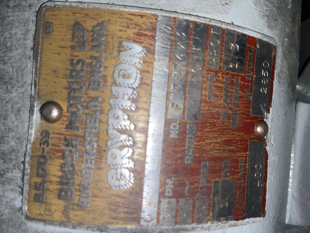

      looks like I got myself a new toy on eBay (surface grinder) but it’s 3 phase and I only have a standard 240v mains supply. I’ve been looking into VFDs but it seems complicated,
      Could somebody knowledgeable please tell me what a suitable 3 phase conversion device might be. I’ve tried to get a pic of the motor plate but it’s in the most awkward place. Hopefully its readable.

          As you've already spotted, the issue is that it's a single voltage motor, which precludes the use of the cheapest Chinese inverters, but there are other solutions.
          The motor can likely be re-connected internally to allow delta, rather star winding, to allow for the cheaper inverters.
          I believe some firms who supply inverters, such as Newton Tesla, will assist with that so long as you buy the inverter from them.
          You can get static and rotary 3 phase converters, from such as Transwave, but they might be a bit over the top pricewise for a single machine. Machine Mart used to do a cheaper one.
          Many UK based inverter suppliers now offer a 240v in – 415v 3 phase out inverter/VFD, though they are more expensive than the 240v in – 240v out ones, but they seem to have vanished off ebay of late. I think you need an AT3 type for the higher voltage output. Again Newton Tesla, or maybe Inverter Supermarket.
          Premier Machine Tools also offer a suitable package, though I've not used them myself.
          Plenty of options there, without needing to replace the motor; I'm sure others will be along soon to chip in.

            From the nameplate it seems like a 400V motor, it may be possible to open up the motor and re-connect it for 230V as Bill says. Is it possible to replace the motor with a newer one that can be connected either star or delta so you could use a cheap VFD? There are solutions that provide 3-phase 400V out from single phase 230V, one example here.

              Looks like it is either a Hammond or an Eagle.
              Guessing it must be the Hammond – because a simple search on the forum would have provided oodles of info on the Eagle.
              Go on, don’t be so secretive with the details. Which machine is it?

                its the Eagle. I didn’t think to search the forum on VFDs for the Eagle.

                  Great idea, I just picked up a “new/other” one – 2hp version, on eBay for £80.
                  Problem solved – hopefully! Thanks!

                    That converter should get you running.
                    Note however that they don't produce a proper 3 phase supply. They can cause quite a bit of torque ripple from the motor. This in turn causes vibration, not a good thing with a surface grinder. So if you are getting vibration or poor surface finsh don't automatically blame the mechanical bits.
