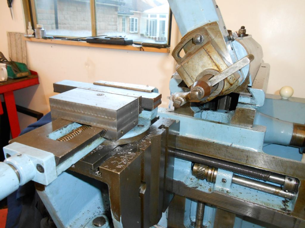

      Hi.
      I'm not a total novice and own a good array of machines, lathe, vertical mill, shaping machine etc,
      At the moment I'm in the process of making a 5" gauge loco "Speedy".
      I have just started to fabricate the crossheads out of bright mild steel stock. I machined two rectangular blocks out of steel and would have liked to machine the slide bar slots using my excellent condition Boxford shaping machine. The two blocks were machined perfectly squre using the shaper. I then attempted to cut the slots in a test piece of steel, but the finish was horrible and on several occasions the tool dug in and shifted the vice. I aborted the Shaping machine in preference to the vertical mill and completed the job with no problem. Is it possible to cut a 1/4 x 3/8 slot with a fiarly small shaper

              Peter Simpson 2
                @petersimpson2
                Many thanks for the feedback, some further info.
                1. Prior to any machining I allowed the table support bar to drop, the pinch bolt was then nipped up.
                2. The tool was ground from 3/8" HSS to a parting off profile with very little front rake and plenty of side clearance.
                One area which I was not to sure about was the test piece set up.
                I had the test piece clamped in the Boxford vice so it protruded from the right side of the vice jaws. I then canted the tool post over to allow the cutting edge of tool to cut across the test piece. The shaper was started, I wound the table feed leadscrew slowly to bring the job to the tool, initially it stated to cut a slot but after a few strokes the tool dug in and twisted the vice on in central holding down bolt.
                If I had the test piece mounted central and vertically in the machine vice there would have been no twisting action on the vice. But how could I have moved the job to the tool ? Is it acceptable to adjust the toolpost micrometer adjuster whilst the ram is in operation.
                #107218
                Peter Simpson 1
                  @petersimpson1
                  I have put a couple of photo's in my album to show the test piece set up.

                    #107220
                    Ady1
                      @ady1
                      A sideyways cut is bound to have weird forces acting upon it
                      For max stiffness the machine is designed for a vertical cutting situation
                      Everything should be as "short" as possible
                      Anything which "reaches out" any distance will chatter
                      Again, for max stiffness your slideways may need to be "locked" as well
                      It's no different from a lathe
                      The setup is everything

                          #107225
                          Les Jones 1
                            @lesjones1
                            Hi Peter,
                            I think the relationship of the position of the clapper assembly and the work piece is wrong to give clearance on the return stroke. As you seem to be cutting the end of the bar then I think the clapper pivot should be vertical.
                            Les.
                            #107226
                            Terryd
                              @terryd72465
                              Hi Peter,
                              I agree with Les. It is a long time since I used a shaper but the way the clapper box is set up on your picture shws that it will try to ift back into the workpiece.
                              Terry

                                  Peter Simpson 1
                                    @petersimpson1
                                    Latest update.
                                    I have cut down the test piece and clamped it in the vice vertically. Adjusted the clapper box to the vertical plane. Clamped all the gib strips and slowed the stroke right down.
                                    A slot was cut with reasonable success, being very carefull the tool was brought to the work with the toolpost vernier dial. The initial "plunging" cut was chattery and gave a slightly rough finish. Once at full depth the slot was taken to full width with little problem and gave a good finish. I suppose a with a little practice it would become easier, but with the Tom Senior Light Vertical watching on, it would so much quicker to take the easy option.
                                    Many thanks for all of your good suggestions
