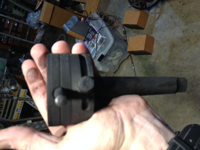

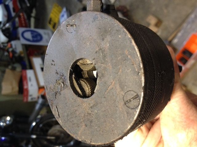

      A large foundry/engineering company is closing down, and I bought a few hundred kilos of stuff from the demolition guys.
      included was this tool, which looks like a knurling tool to fit in the tail stock, but I've not seen one before. I got two, one smaller than the other. Both are MT3 or MT4 so won’t fit my lathe, but I’ll hang onto them as I may get a larger lathe at some point.

          I would agree a knurling tool but have never seen one like it before, it appears the nut? on the adjusting lever in the rear slot allows size adjustment ?

                Just cleaned all the gunk off it and answered my own question.
                It's marked “Concentric Knurling Tool” No makers name, just patent & serial numbers.
                unfortunately the Morse taper is part of the tool, I was hoping I may be able to remove it and fit an MT2.

                  Hi Grotto, you can always buy an MT2 to MT3 extension socket **LINK** but it will take up a little of space, so will depend on what length of bed you have.

                    Looks like the type of thing could have been used on a capstan lathe for production work, bit like a Coventry die head. Looks very handy though. You could probably set it up in the four jaw with a tailstock centre in place and turn that taper down to MT2. Often such shanks are not hardened.
