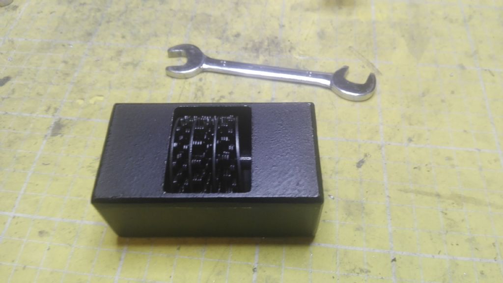

      Hi there,
      I inherited this tool (check pictures) with my lathe. I have absolutely no idea what it is for. I would be very grateful if someone could identify it.
      10mm spanner in the background for scale.
      Thanks in advance!

        What on earth is this tool

          A mini enigma machine??

            Looks like the supplied tool with my bench grinder for refreshening the wheel surface.

              Star wheel ( Huntingdon ) dresser for bench grinder, some are mounted in long handles for use on floor mounted grinders.. see..

                Oh, I see! smiley
                That'll come handy!
                Thank you very much!

                  Or for a star wheel dresser for a surface grinder? Is the base of the block ground flat (and magnetic!)?
                  However, I've only ever seen surface and cylindrical grinders dressed using mounted diamonds, which I occasionally use on my 6 inch bench grinder.
