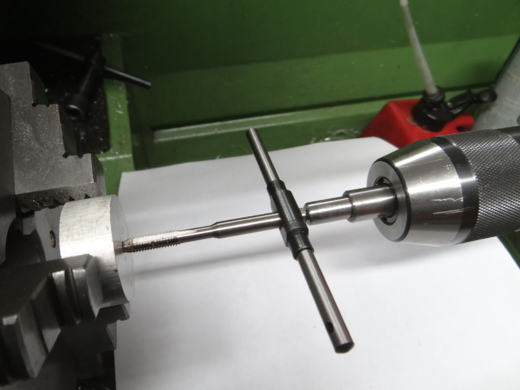

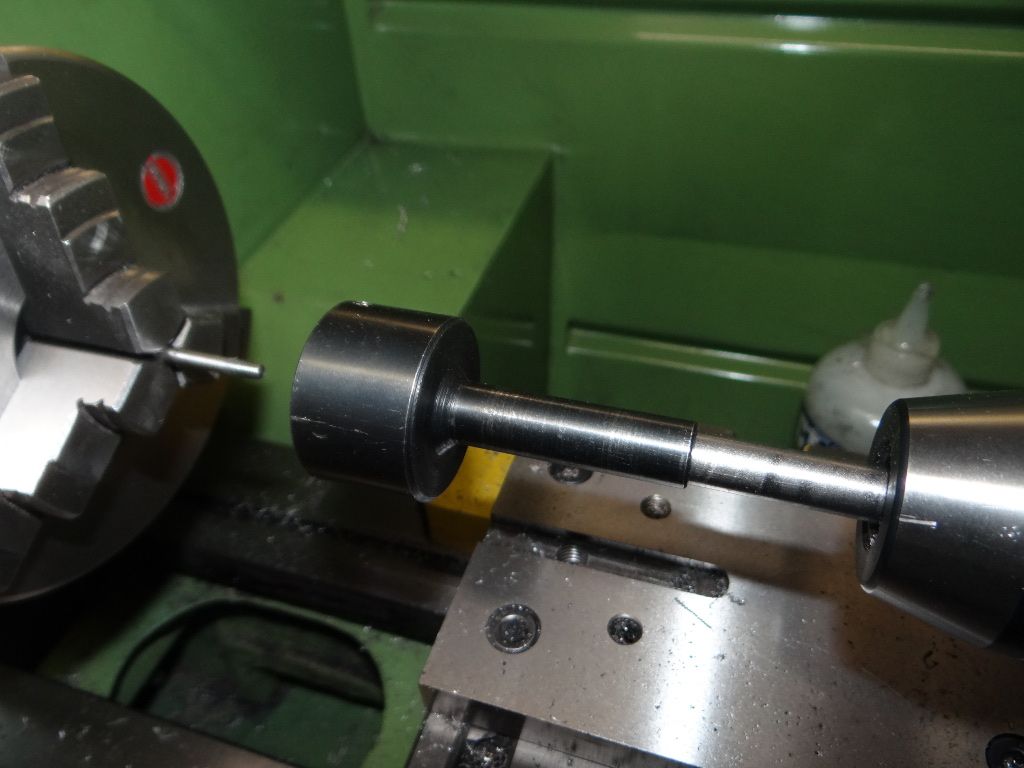

            There's an alternative if you have an ordinary tail-stock mounted drill-chuck for the lathe. This type of die holder has a plain straight mounting rod with a hole bored through it These can be worked by hand by mounting them on a straight rod or pipe held in the drill chuck.
            Photo above also nicked from Arc Euro's website..
            Here's one I made earlier:
            Similar trick with a spring loaded straight thingy works for taps:
            Not really for cutting threads under power, I usually turn the main chuck by hand while pushing the die holder into the cut and stopping it from rotating.

              I think both the shank (smallest is 1/2" ) and the 9mm hole thorough the middle are above the capacity of the Unimat 3 tailstock drill chuck, so I couldn't see a way to use the Arc holders without modification. The drill chuck only goes to 8mm.
              You could turn a shaft to a sliding fit in the 9mm shank bore of the dieholder, and turn a holding diameter of 8mm for the drill chuck, but the Ebay dies that screw straight onto the quill seem simpler.
