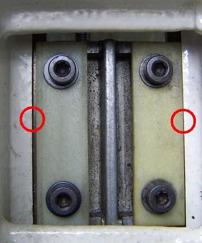

      Hello:
      I am having quite a few issues in my Unimat 3 and one of the causes is lack of rigidity in the saddle.
      While I may be expecting too much from the U3, I have read more than one post stating that replacing the glass filles plastic saddle gibs in the Unimat 3 for hard brass made a world of difference.
      I would happily choose SAE6X brass but locally I can only get that in round stock which is out of the question as it would mean an absurd waste of time, effort and money.
      The counter guy at my local non-ferrous metals purveyor I has suggested that, given the size and small/limited forces at play where the new gibs would go ie: under the U3's carriage, that I make the strips from 7075-T6 aluminum which has has in 4.0mm thick stock.
      Not only that, he is also willing to cut and sell me the ridiculous amount I'll need, something essential for me.
      Seeing that the original gibs are made (?) from 43 year old glass filled plastic, I think this is what is commonly called a 'no-brainer' but I would much appreciate an opinion on those in the forum who know about this.
      Thanks in advance.
      Best,
      JHM
      Edited By Julius Henry Marx on 09/06/2023 21:06:03

                  The gibs need to keep the play at a minimum. If there is on even wear along the bed, these elastic gibs will partially compensate for that. When using brass or aluminum gibs, the carriage will get stuck.
                  I would first try to set the play at a minium and check the result.
                  I have made brass gibs for my mini lathe. Any type brass will do.
                  If I have to do it again, I will try POM gibs because they don't wear down the bed. This allows me to set the play to zero and probably the carriage will be hard to move at some points. But that is only for a short time until the POM gibs are wear down a bit.
                  #648028

                    Is the bed cast iron like most other lathes? If so, mild steel will work well for gib strips. It is what most other lathes use. Steel against cast iron is a good bearing combination.

                              I am not familiar with that lathe but from what I can tell from your pics, those are lift plates, not gib strips. Mild steel is what most lathes use there. The gaps you  have circled mean nothing. The inverted V of the "prismatic" bed is what provides the alignment, not the lift plates. Lift plates are just there to hold the carriage down on the bed without tipping if the cutting tool is stuck out in front of the carriage etc.
                              If for some reason you particularly want brass, you can get brass in many sizes of plate and flat bar from model engineer suppliers and online. As you have found, bronze is hard to find in plate or flat bar, as it is more common in round bar, used for making bushes etc. So try searching for brass rather than bronze.
                              But mild steel will make a stronger, less flexible part and will bear against a cast iron bed just fine. That is why most lathe manufactuers use it.
                              Edited By Hopper on 10/06/2023 10:03:11

                                        My Unimat 3 restoration, (see my album), uses the same Gib strips that were originally fitted, but just turned over. I personally would not use Aluminium for this application. Brass would be my only substitute.
                                        Rubbing the existing Glass filled Gibs on some Wet or Dry will also restore the surface.
                                        For what it is worth, the Compact 5 uses exactly the same set-up as the Bedway profile is the same on both machines.

                                          I'm with Graham on this one, you can turn the plates around 180 degrees to a new non worked face, then when it needs tightening again turn it over and before you sell it turn it around again, the only worn part is around 3mm wide at the edge. As said the same material was used on all Emco 5 manual and cnc lathes, link to video showing the easy method of access to the Z plates on a cnc 5.

                                            > … lift plates, not gib strips.
                                            Thanks for that. I have seen them refered to as gibs most everywhere. I stand corrected.
                                            > Mild steel is what most lathes use …
                                            > … gaps you have circled mean nothing. The inverted V of the "prismatic" bed is what provides the alignment …

                                            There is an alignment problem in my U3. I have tested it by just puting the saddle on the bed (no lead screw or plates) to try to see exactly what it was about and pressing a bit on top of the saddle reduces it to practically nought but (as you know) the forces at play when turning a part can be quite high. ie: much higher than what I can excert with my hand while holding the carriage in place from above.
                                            After that and reassembly with the plates tightened, things seemed to get better which is why I thought that maybe the edge of the plates needed to be nearer to the bottom of the ways to help with the alignment but I still have to test it while turning a piece.
                                            Q: How can I test this properly? ie: what lack of rigidity is acceptable / what are the limits of the U3 in that respect? Sometimes I think I am pretending too much from what I am starting to think of as an expensive toy.

                                                The rear Gib Plate on my Emco Maximat Super 11 was made of the same material. This lathe was 36 years old when I let it go this time last year. In all that time I only ever adjusted that plate once. I know a lot of potential buyers were put off by the use of plastic on this particular lathe, but that machine never once let me down and was still capable of some very fine work when I reluctantly let it go.
                                                There is very little load on these plates, they are there just to keep the play to a minimum and keep the parts together. The geometry of the bedways is such that all cutting forces are taken on the upper surfaces.
                                                If you can vertically lift the carriage assembly away from the bedways then no amount of new Gibs will rectify this. It is time to either rework your existing carriage as I did, or obtain a new or good secondhand unit.

                                                    If you are getting non-vertical perceptible movement of the carriage on an inverted V-way bed, it is most probably down to the fit between the inverted V-way on the bed and the V-groove in the carriage.
                                                    First suspect would be small bits of swarf have worked their way in their and are holding the two surfaces apart. Second would be some small burrs on either surface. Third would be wear.
                                                    You could check it by taking the carriage off and cleaning things thoroughly. Then apply a very very thin smear of engineer's blue to the bed and then rub the carriage up and down it once or twice and then see from the blue spots on the carriage where it is contacting. IT should be fairly consistent over the full length of the contact area. If not, it will need scraping to match, which is a whole other can o' worms.
