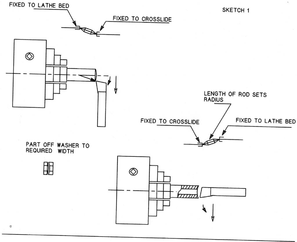

                      The easy route to turn this type of radius
                      is to use fixed length rod the radius you need
                      with point on each end and one fixed place
                      on the lathe bed for one end of the
                      radius rod and one fixed place on the crosslide
                      for the other end see sketch.
                      In use some pressure is applied with the carriage
                      feed handle to keep the rod in place.
                      With the tool tip on centre the radius rod is parallel
                      with the lathe bed,as the crosslide is moved out the
                      pressure applied to the carrage feed moves the tool
                      in the required radius,depth of cut is applied via the topslide.

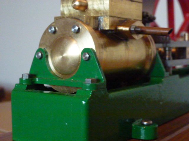

                        I made this cover recently with the hand-graver I described. Pretty much free-hand and took only a few minutes.
                        A bit more care perhaps if 2 identical domes were wanted.

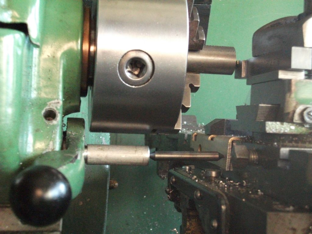

                            Just found this photo re my last post showing

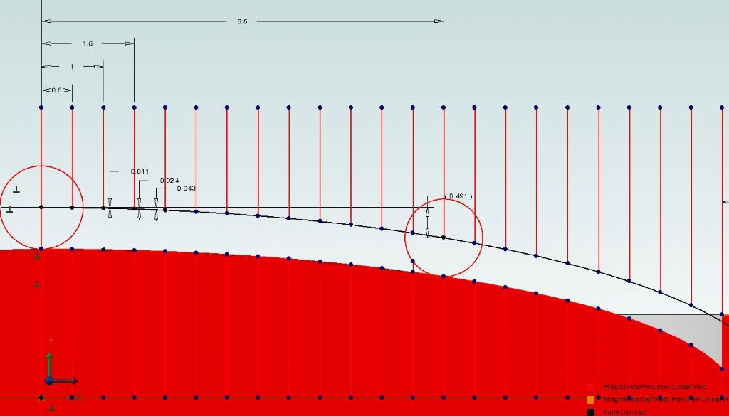

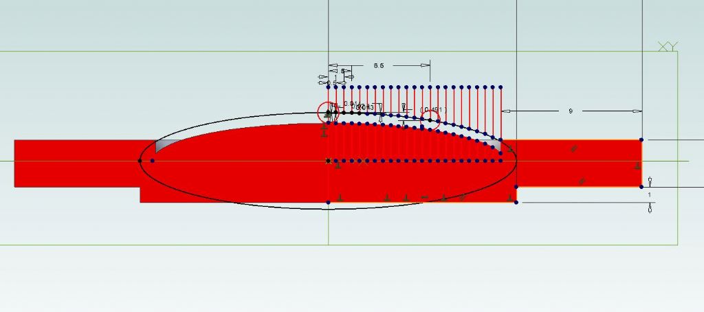

                                Posted by Dr_GMJN on 27/09/2021 18:41:31:
                                Jason – I’m not sure what the co-ordinated would do.Do you mean drive, say, a 0.8 radius tool to a series of locations, and blend the remaining peaks? I’d imagine I’d need dozens of positions to do that?
                                If you draw a section through the cylinder end cover and then draw a line to follow the profile set away by the radius of the tool's tip you can then pick co-ordinates along that line.
                                For a relatively flat dome like you need the cross slide can be moved a convinient amount each time say 0.020" or 0.030" so draw a series of lines at your chosen spacing and then measure offsets for each one. I have taken the point of contact in the ctr to be 0,0 and you can see the further I bring the tool away from ctr with the cross slide the deeper each plunge cut is. eg at 6.5mm from the middle I'm plunging in 0.491mm.
                                You then just blend in the high spots to give you this
                                It works with any shape such as this decorative column capital
                                Edited By JasonB on 27/09/2021 19:18:58

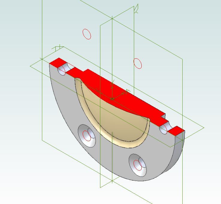

                                  For the benefit of DC31K and anyone else who can't work out what is needed here is a section through the cylinder cover, it's the domed cream coloured surface that needs to be machined
