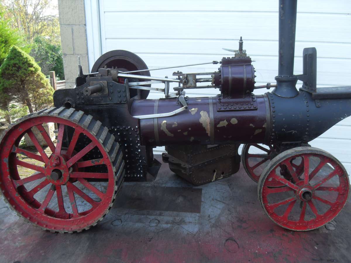

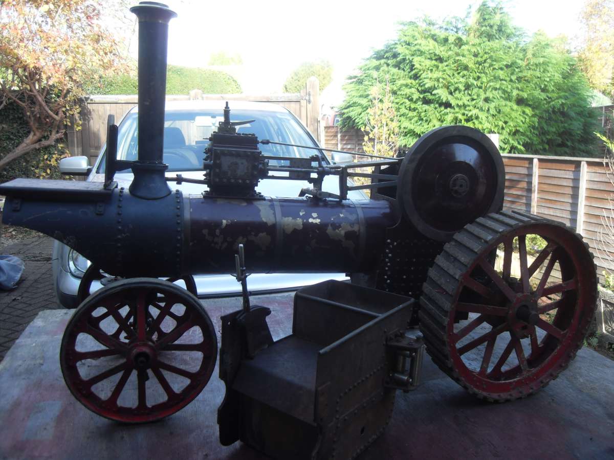

I recently bought this model traction engine, there are certain parts missing and having spent some time with it I do now believe it is an unfinished project. Can anyone tell me what make/model of traction engine it is based upon and who may have made the casting kit for it, and, (yes, I know its a long shot), where I might obtain some drawings for it, any help would be greatly appreciated.
Provide some details. Wheel diameters, Height of top of chimney, distance between axles, diameter of boiler.
Can’t help much but the smokebox platform and the disc flywheel indicate a showman’s engine, but I thought that they were almost always compounds, so perhaps not close to a full scale prototype. Straked rear wheels also seem unusual for this type of engine. Plenty of work ahead there. As said, sizes would be helpful.
There are no features that scream out it is of a particular marque, but I am no expert. Large showman’s engines were as previously said more commonly compounds. There were a few smaller single cylinder tractors that were used by showmen I think but the size of that dynamo platform suggests this was to represent something bigger than a tractor. I can’t think of any published designs off the top of my head that might fit this. I suspect this may be a freelance, certainly that firehole door is not a scale reproduction of anything I have seen. I think you might get more luck posting this on traction talk, there are plenty of knowledgeable traction engine folk on there.
Paul.
The three shaft layout suggest it is more likely meant to be a Burrell than a Fowler and it certainly would not be the first model Burrell agricultural engine built up to look like a Showman’s conversion. If you read Plastow’s book there is a lot about “lion” which had the lesser spokes and strakes of an agricultural/tractor though that was a compound and had been converted to a Showman’s

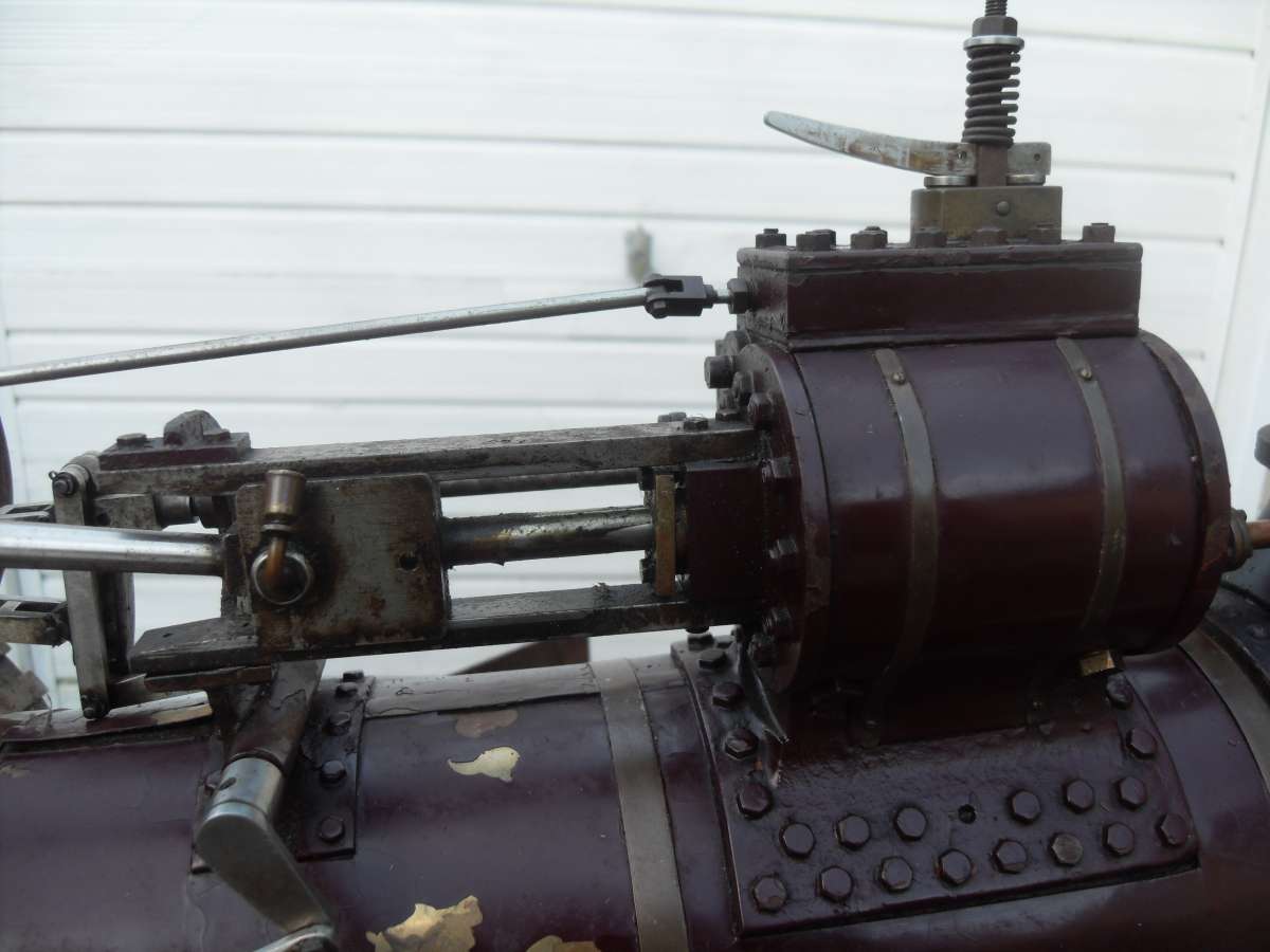

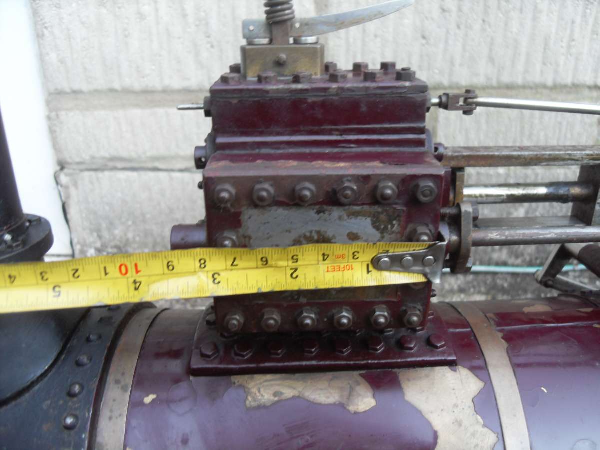

It has the look of a showmans. The cylinder block with so many bolts/studs it puts me in the mind of a freelance. You know nothing of the engine, do you have the paperwork for the boiler, I take it of steel at this size, as without that it could prove difficult to get a boiler certificate and be able to steam her. At this size it may well need a commercial ticket and be costly. I would investigate this matter before spending any money on what could be an interesting project. The advice of a boiler inspector should be sought. Good Luck. N

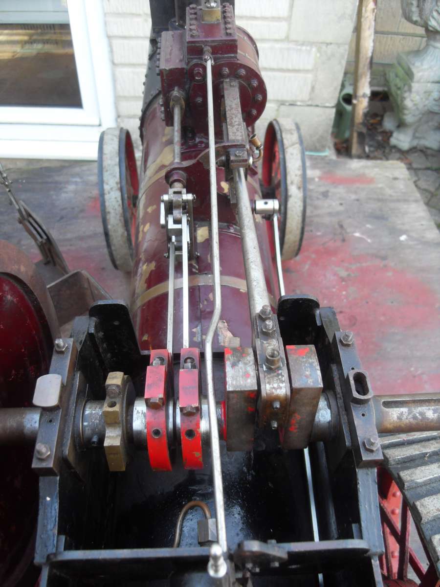

I don’t know traction-engines well enough to differentiate between makes, but some general details stand out as evidence of a freelance design. And yes, there certainly are “some parts” missing, not least the transmission-gears and (apparently) the differential.
So what suggests free-lance, making it hard to determine what if anything was its source?
– The cylinder looks too clearly fabricated, and I have never seen so many studs around a cylinder saddle. Nor the cylinder end covers: 6 or 8 studs is correct for that.
– The eccentric rods’ blocky design is all right functionally but not prototypical Edwardian practice. The full-size versions, on any engine, were usually forged and machined in one piece, with elegant, large-radius fillets.
– Nor would there be such a (relatively) large space between the eccentric sheaves. Instead they should be snuggled up together and one or both rods are cranked through their web lengths to meet the expansion-link. Otherwise the motion is fair to type, with an elegant motion-bracket too.
– The crank webs seem a bit too rectangular but that may be an optical illusion. A few other parts look a bit too squared-off for realistically replicating an actual machine, as well.
– As Paul points out, that fire-door is not at all prototypical, but I have seen similar on miniature railway locomotives, probably made that way for easier operation. The fire-hole on some miniature traction-engines is not the most accessible of things! It normally swings through a horizontal arc, and in full-size but not always on models, usually includes a rotary top-air damper.
Its builder has clearly put a lot of effort into this engine but as others say, I think it probably freelance. Though it may well have elements or components from published miniature designs or directly replicating various full-size engines.
Some full-size, agricultural traction-engines were converted to showmen’s trim by subsequent owners, so that hefty great dynamo bracket is not entirely “wrong” although to my eye, slightly over-scale. The larger, purpose-built showmen’s road-locomotives were normally compounds and generally but not universally fitted with rubber tyres, especially in later years, because they did not venture across farm-land. (I am not sure, but I think it might also have become compulsory.)
As for the boiler, yes, it should be of steel at this scale but not intrinsically demanding commercial testing provided its history is known. Your difficulty is that unless it is known, most club boiler inspectors are likely to be reluctant to certify it. It is allowable but would have to be treated as a “new” boiler, and probably with the cladding removed so the general state can be assessed. Club boiler inspectors do not have, and are expected not to try using, acoustic thickness-testing instruments and the like, a professional pressure-vessel tester may use.
Presumably it has never been steamed anyway, or only lightly as a builder’s construction test. Examine it carefully to see if it bears any serial-number or other identifier, from which it might be traceable via the MELG scheme. I am only guessing from the somewhat “barn find” patina that the boiler might pre-date the Pressure Equipment Regulations, “certified” steel and CE-marking – but those rules apply only to commercially-built boilers, not ones made privately.
Where to look for any identifier? Favoured places are on the back-head, perhaps throat-plate, at foundation-ring level, the back-head at the top; and possibly (but hopefully not) the smokebox tube-plate. Some builders are kind to boiler-inspectors and fit a visible but discreet serial-number plate on the external crown in the vicinity of the spectacle-plate.
There is nothing to stop you testing the boiler according to the normal scheme and using it yourself in your garden at you own risk; but you cannot certify it yourself, and would not be able to use it in public – including model-engineering club events open only to the club’s members and personal guests.
Good Luck with it: it deserves to be completed but I fear it may not be easy.

PS is the cylinder block fabricated ?

I’m not sure it’s a model of a “known” design, but is freelance, and rather looks as if based on a general-purpose engine “repurposed”, as they say these days, to showmen’s use.
I would agree on the approximate scale but without actual dimensions or even something to give scale in the photographs, it is hard to estimate.
I hope the rather gloomy prognostications so far have not deterred him!
Someone once mentioned in a book an engine with many smaller strakes, just like this one has, maybe an Aveling?
Where’s the winch, brake drum, gears, second shaft, gear shift, steering gear and water pump, hopefully in the garage behind.
50% finished.
Plastow parts may fit, though if it’s a 4″ big machines are needed as well as the appropriate wallet.

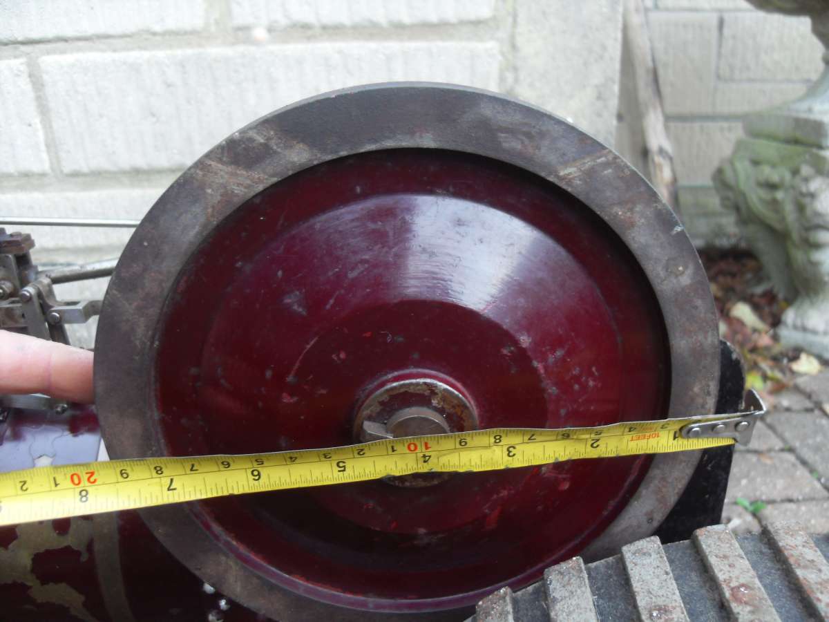

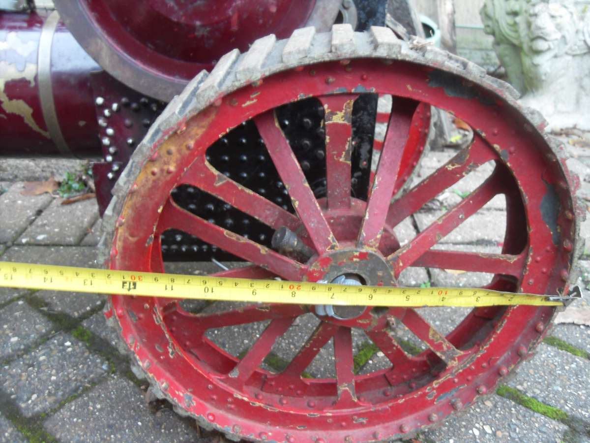

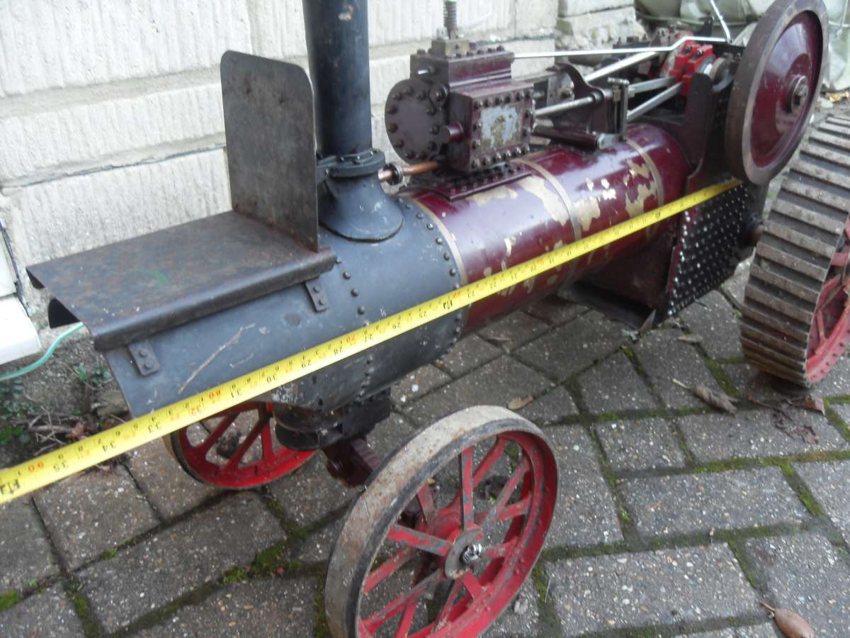

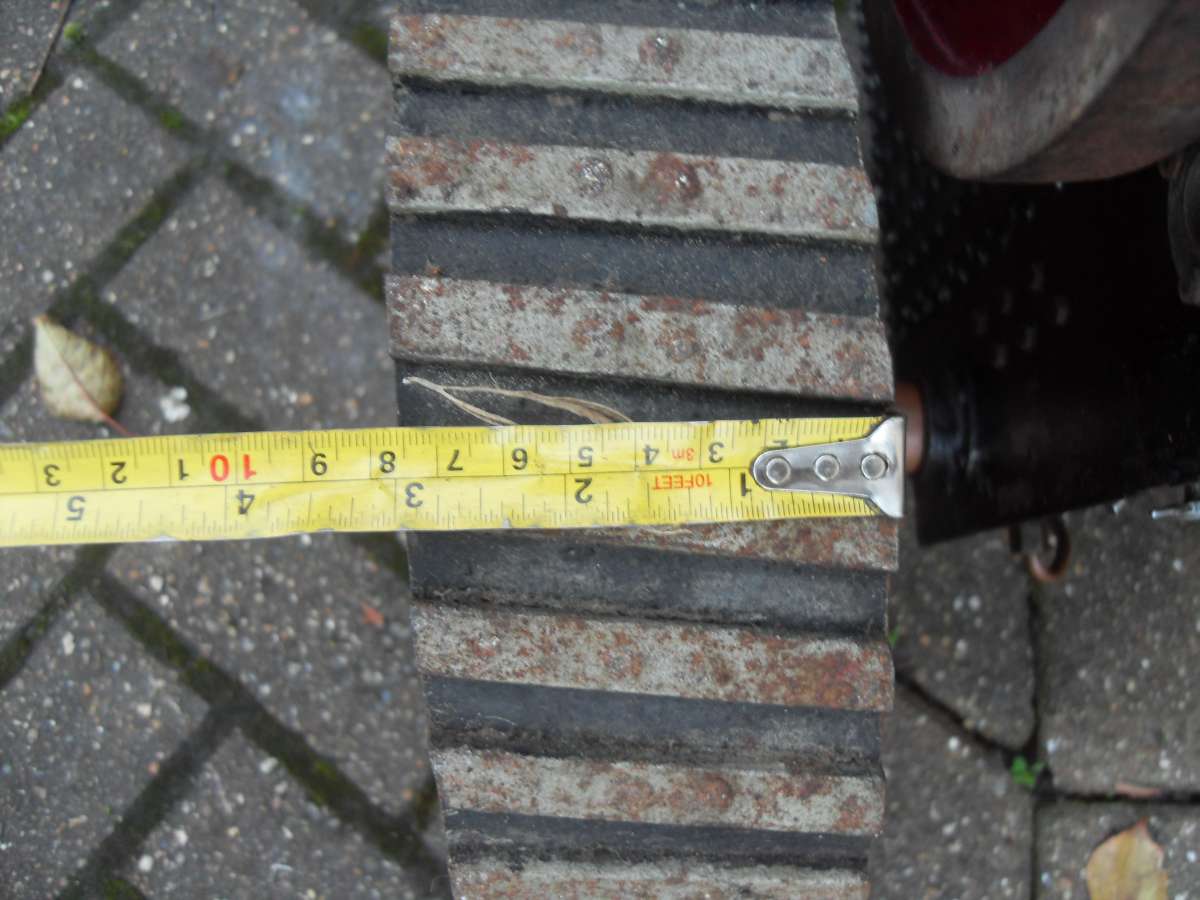

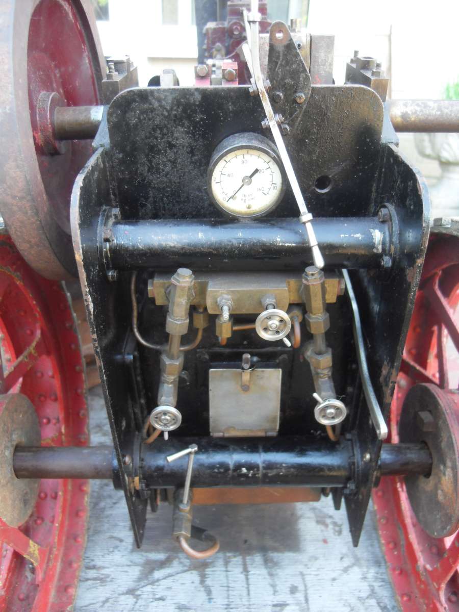

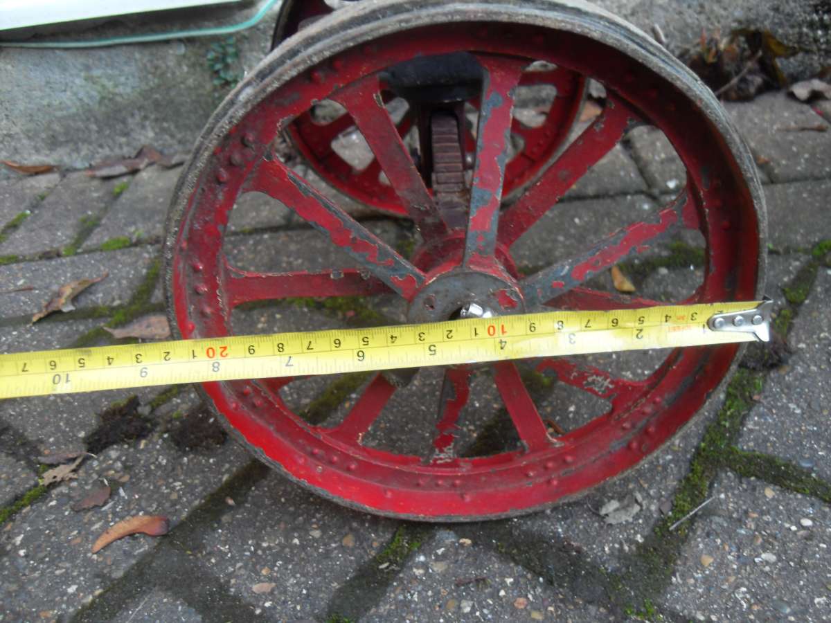

Gentlemen, thank you all so much for taking the time to reply to my initial posting, as you have all no doubt realised I am a novice with regards to Traction Engines being more of an IC man.

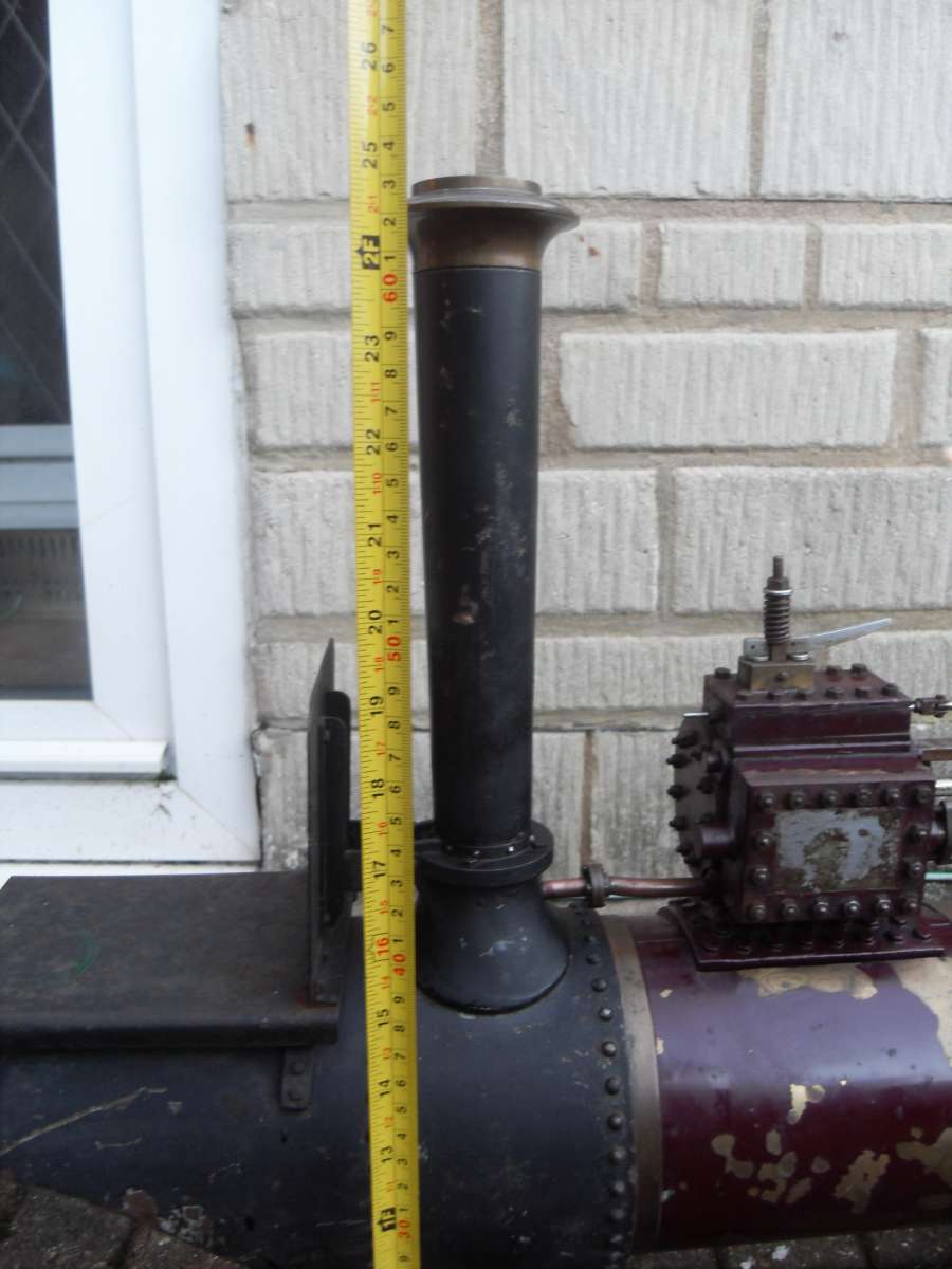

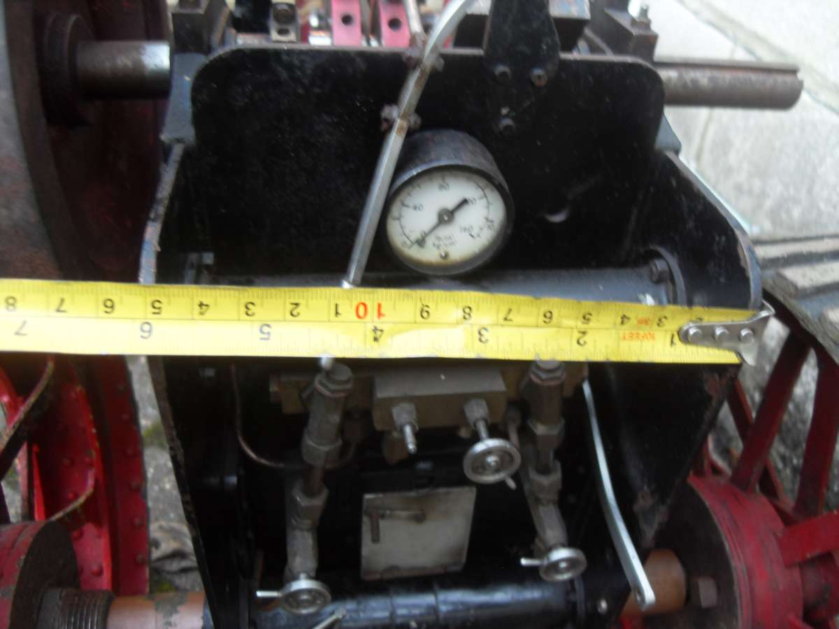

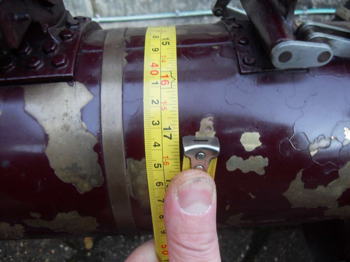

I have now taken some photos with measurements, the boiler diameter works out to 5.4″.
Having shone a torch in both ends of the boiler I can confirm that it is made of steel and looks to be silver soldered which I assume would be correct for this size of boiler? I will have a closer look and see if there are any numbers stamped into it.
There is some soot in the chimney so I can only assume it has been fired in the past, unfortunately I have no history whatsoever for it, the guy I purchased it from had got it for free from a garage clearance some 20 years ago, he knew less about it than me and had only ever used it as an ornament, I paid very little money for it so it may well end up as an ornament again, however being a trained machinist and having a love of old machinery I would like to continue to explore potentially finishing this engine, I DO realise this would be many hours of work.
So, general consensus seems to be that this is a freelance engine, that’s ok, I can cope with not being a purist on this project, if my newly posted photos with measurements helps with any identification that would be great.
One reply mentioned the lack of differential, could you enlighten me on this please. With my very limited knowledge I thought TE were one wheel drive until the second wheel was engaged or locked to the axle with a pin, I realise the components that the wheels would be locked to are missing, are these parts referred to as a differential?
I will leave it there for now but will no doubt have more questions going forward, your help would be very much appreciated.
Bill.
The sizes would put it at the small end of 3″ scale, particularly a sit looks like it is based on a tractor rather than a larger engine. Think 3″ scale mini compared to a 3″ scale Volvo estate.
Your boiler is more likely 5″ ODas you are measuring over the cladding and usually insulation.
At 5″ a steel boiler is not common and will not be that good at firing. Also silver solder is not usual with steel boilers, they are welded and the fire tubes either welded or expanded into place. If expanded then the tubes may be copper even though the rest is steel
If it is a steel boiler then unless you can come up with design calculations, prove the quality of welds and find a boiler inspector happy to accept those then it is not really going to be viable as a working engine.
If it is infact a silver soldered copper boiler then if calculations can be done you may stand a bit more chance of getting it tested and certified. Scratching the paint off the backhead to see what is below would be a simple way to check for copper.

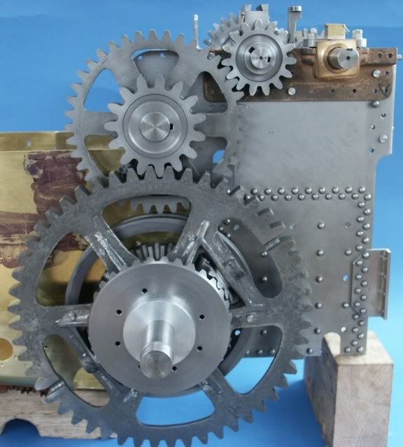

Some engines have a diff others don’t. Those without a diff often ran with drive to just one wheel when doing tight manovers but in heavy ground could add a pin into the lobe on the hub which gave drive to both wheels. When the winch was in use the drive was removed from both wheels so just the winch drum was driven by the axle. As it is a free lance I would say the diff was left off for ease of construction, similar to the basic Minnie traction engine, they run fine without a diff and are simple to make. Ploughing engines never had diffs.

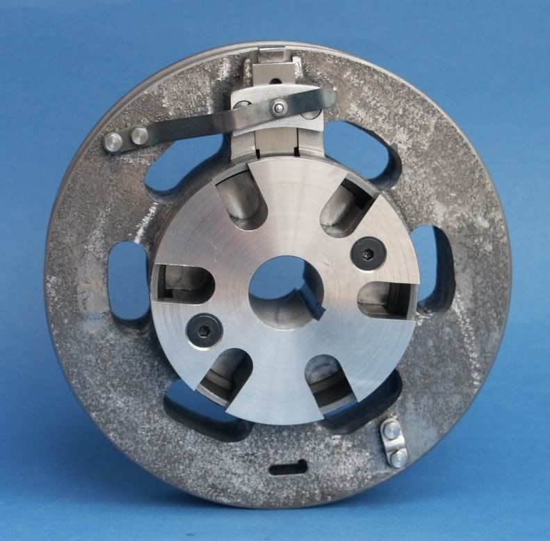

This is a traction engines diff
This is the winding drum on it’s “drive ctr” which is keyed to the axle. When driving along the drive pin from in the hub’s lobe engages in one of the six radial slots so drive goes to the wheel. When winching that pin is removed so the axle just spins in the hub and the detent at the top drives the drum. Your wheels also look to be missing their bearing shells.

It is the name Given to the rear of the boiler, the flat part where the firehole door is and where the water gauge bosses are.
Another way to get an idea of construction is to remove the ash pan and have alook at the “foundation ring” from underneath, this is the bottom of the recrangular firebox where you will hopefully be able to see two layers of metal and an infill. You sould be able to see if the joints are welded or silver soldered. It will also give an idea of the thickness of metal used on the boiler. Typical thickness of approved designs at 5″ dia would be 10g about 3mm for copper and around double that if steel to allow for corrosion.

Gears are your major issue. The wheel sizes come close to the Reeves 2000 Thetford Town 2″ @ eye watering prices and also the Haining class V single plougher 2″ or Superba which both use the same gears of 8DP though 4 shaft engines and not 3.

Forgive me, I was somehow fooled by the background into thinking this engine was much bigger, YES I would think it could be a 3″ scale,and may be freelance now there are some dimensions. I always think it is so sad when a model like this, having got so close to completion is not finished. As with any live steam model – the boiler is the important part, by far the most expensive,and more so now than ever. Yet with out it’s paperwork if copper there is a sporting chance of getting it certified but if steel really little chance at all. I know, I have one ! Is it a copper boiler ? put a magnet round inside the the firebox or round the backhead or front tube plate, NO attraction ? if no then your luck is in.
Using an 1.5″ Burrell 6Hp agricultural as a guide, rear wheels 8″ front wheels 5″ and chimney height 16″ (in round figures ). As Jason has said, if based on a real engine it must be a small one for 3″scale as the above figures should be roughly doubled for yours.

From your photographs with the tape-measure, and giving the shell diameter, this engine’s boiler seems significantly longer, but not otherwise far different in size from that on my 7-1/4″ gauge locomotive, a double-sized version of the Juliet design.
