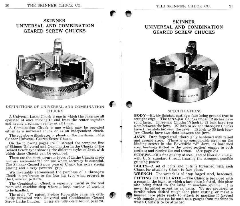

                        I have a rather interesting Skinner 3 jaw geared chuck.
                        Unlike a conventional scroll 3 jaw self centering chuck, where the scroll moves the jaws, these have an internal, removable, ring gear with teeth on the face of the ring.
                        The ring gear operates all three screws at the same time, which in turn operate the jaws in the conventional independent manner, similar to a common independent 4 jaw. The screws though are fully engaged in each jaw.
                        They did both 3 and 4 jaw types, but unfortunately mine is missing the removable ring gear, so can only be used in independent, rather than self centring mode.
