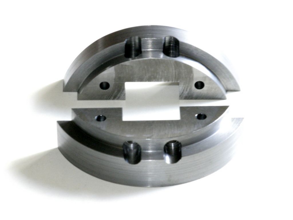

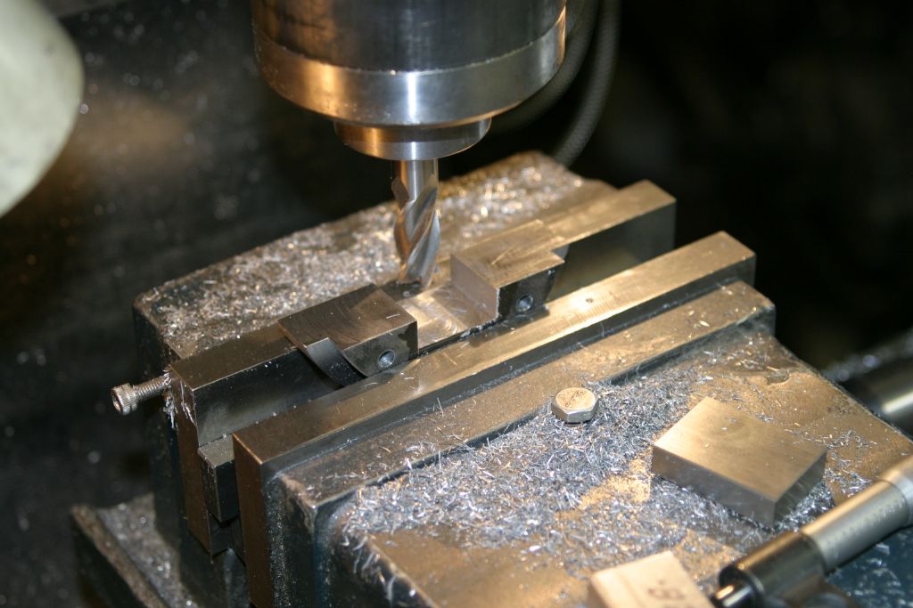

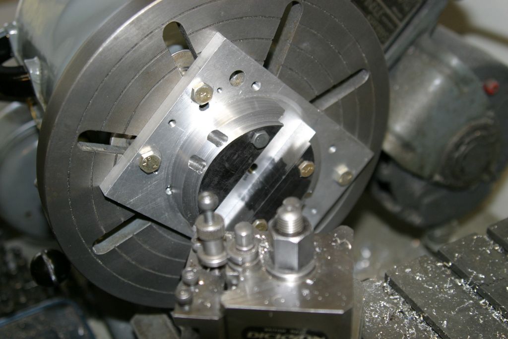

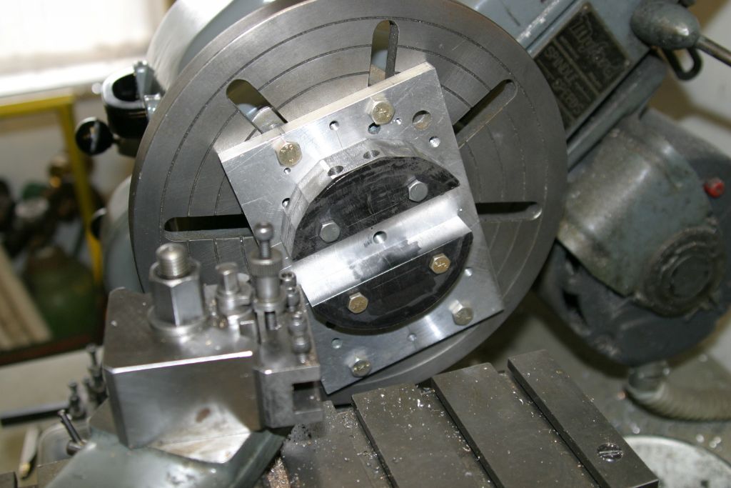

              For the crankshaft counter weights, two slices of steel were sawn off some black plate and machined to be slightly oversize, finishing at 3.375 ( 3.378 ), 1.240 ( 1.260 ), and .851 ( .701 ). The holes for the 10-32 hex socket head cap screws for fixing them to the crank web were then drilled #21 tapping size and counterbored 5/16" diameter. Also two #21 holes were drilled in each for some 10-32 bolts to fix them to a jig plate to be bolted to the faceplate for turning the weights to the semi circular shape. These holes were positioned so that the heads wouldn't be in the way of any of the turning operations. When completed these holes will be plugged with some short lengths of 3/16" dia. rod. I had first considered putting the hold down bolts in the centre section that would be cut out for the socket that goes around the crank web but felt that this wouldn't provide a secure enough hold for the intermittent turning operations.
              Before mounting on the faceplate for turning, the corners were sawn off and they were milled to remove the remaining corners and bring them to a roughly semi circular state so there would be less shock loads during the turning.
              Embryo counterweights mounted on the jig plate and centred on the faceplate using a wobbler in preparation for turning the outsides to the 1.760" radius. As pictured the balance was good enough to run at the lathe's lowest direct speed ( 281 rpm ).
              The outsides turned to dimension and the .250 x .265 reduced section on the corner of the outer diameter turned to size. Since the two halves are of different thickness, once the thicker one had been turned to .265" deep the thinner was only be .115" deep, therefore the thick one was removed to finish turning the thinner one.
              Finish turning the recess on the thinner weight, note the extra weight attached to the faceplate to counteract the out of balance.
              Milling out the recess for the end of the crank web, after chain drilling and sawing out the bulk of the waste. The holes for the fixing screws were then spotted through into the webs and the webs tapped 10-32, and the holes in the counterweights opened up to clear the #10 screws ( #10 drill ).

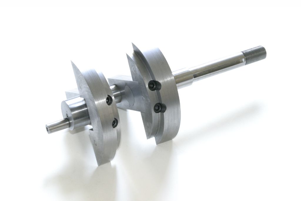

              The finished crankshaft counterweights with the holes used to fasten them to the faceplate yet to be filled in.
              The crankshaft with the finished counterweights attached.

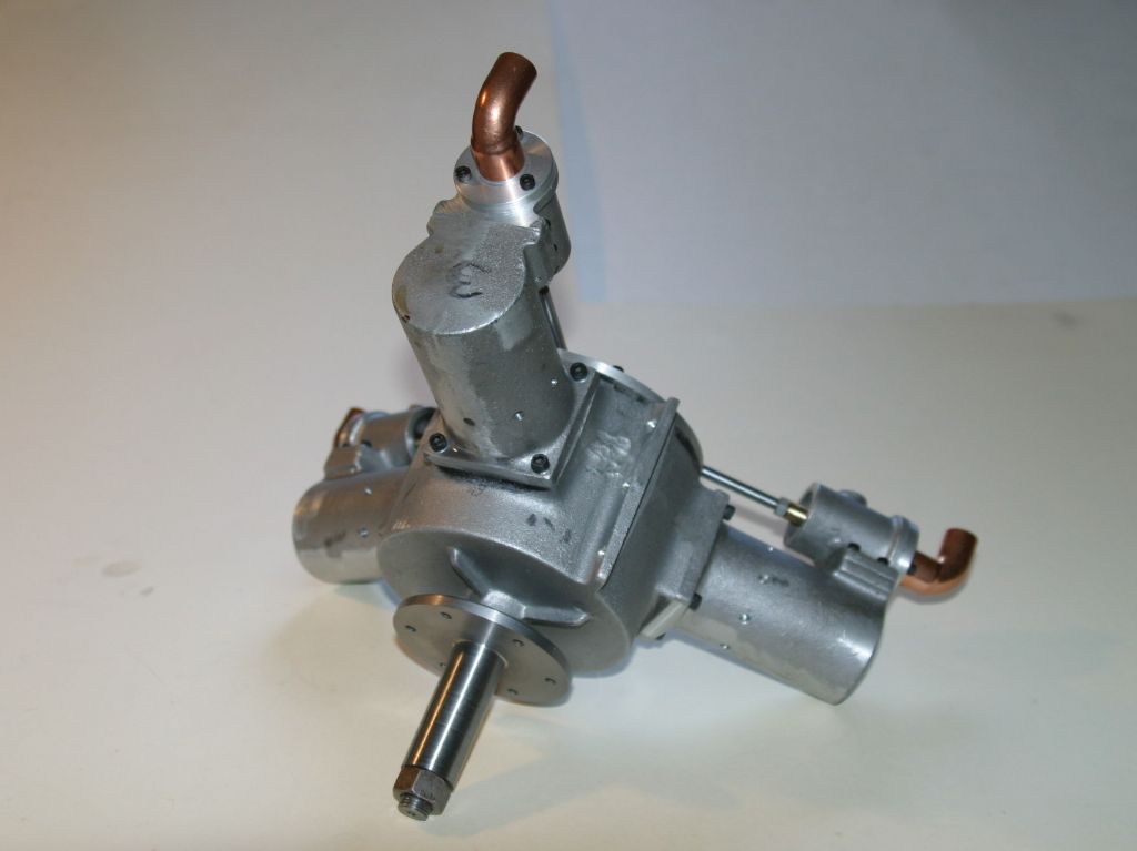

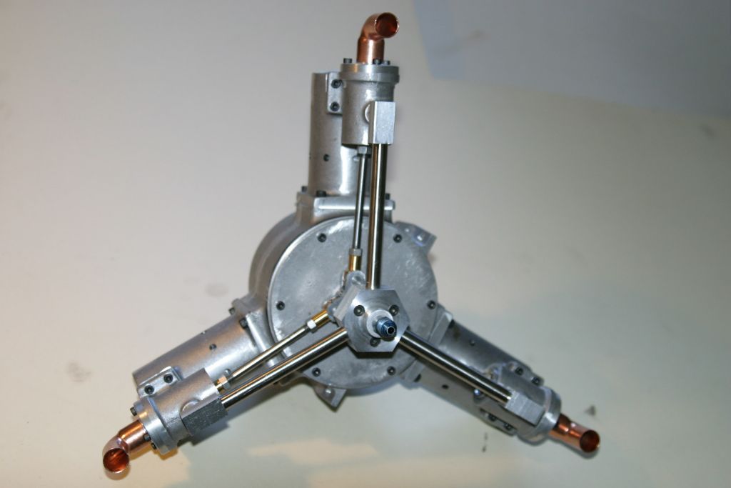

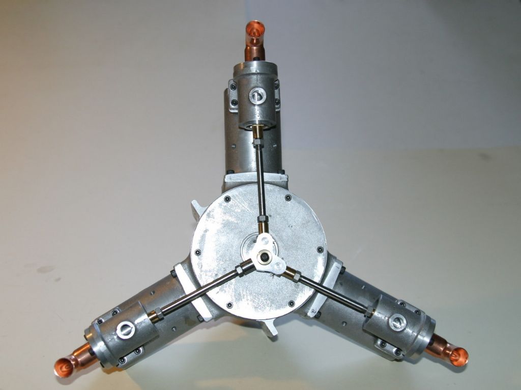

                Here are a couple of pictures of the completely assembled engine, minus the inlet plumbing. I first assembled it without oiling any parts to check the fits and it rotated quite freely with no binding. After oiling everything up and reassembling it its a lot stiffer due to the oil drag but there is no sign of any tight spots.
                The next thing is to design a stand for it and to figure out how I'm going to hook up the inlet plumbing so I can put some air to it and see if it runs. First the valve timing will have to be checked as I think things changed when I assembled it, which means taking off the back crankcase cover so I can see when the pistons are at TDC.
                For any one contemplating building one, the plans are nineteen 8 1/2 x 11 sheets stapled into a booklet easily separated for use. I found no dimensional errors on the plans but there are a few missing dimensions, but they could be determined from listed ones. The castings were generally good with some porosity in a few and some had minimal machining allowance, requiring careful setup before machining. As mentioned earlier the cast boss on the crankcase back plate was quite a bit smaller than the required finished dimension.

                    Here's my solution for the inlet plumbing, made from some pieces of aluminum and 3/8" OD tubing. Inlet fitting is a 1/4' flare fitting.
                    At 10 PSI it just ticks over once the prop hub is give a little twist. at 40 PSI it runs at just under 500 RPM and at 60 it's ~780 RPM. It doesn't want to self start at any pressure, but I think the valve setting is off, as when just ticking over the exhaust sound is not regular. The exhaust note is quite explosive, as if there is a fair amount of compression before the exhaust opens. It uses a lot of air, at 60 PSI it certainly drains my 20 gal. compressor tank quickly (starting at 120 PSI).
                    So that's it, finished (except painting??? ). Now I guess I need to fabricate a stand for it and think about a prop !
