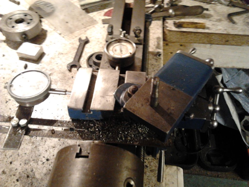

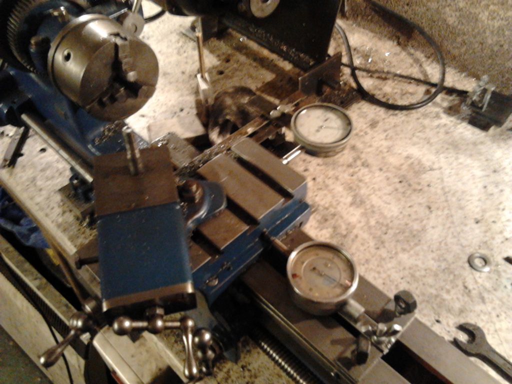

              Sorry a bit vague I'm from cardiff. I was having trouble, i.e parting the thread but managed to suss it. Mounted a dial indicator to the bed but its on its way out, which was why I was getting parts. No thread indicator sorry. I am using back gear for cutting, naturally. Its a slow process without tumble reverse though as you can imagine guys! Couple of pictures of my set up.

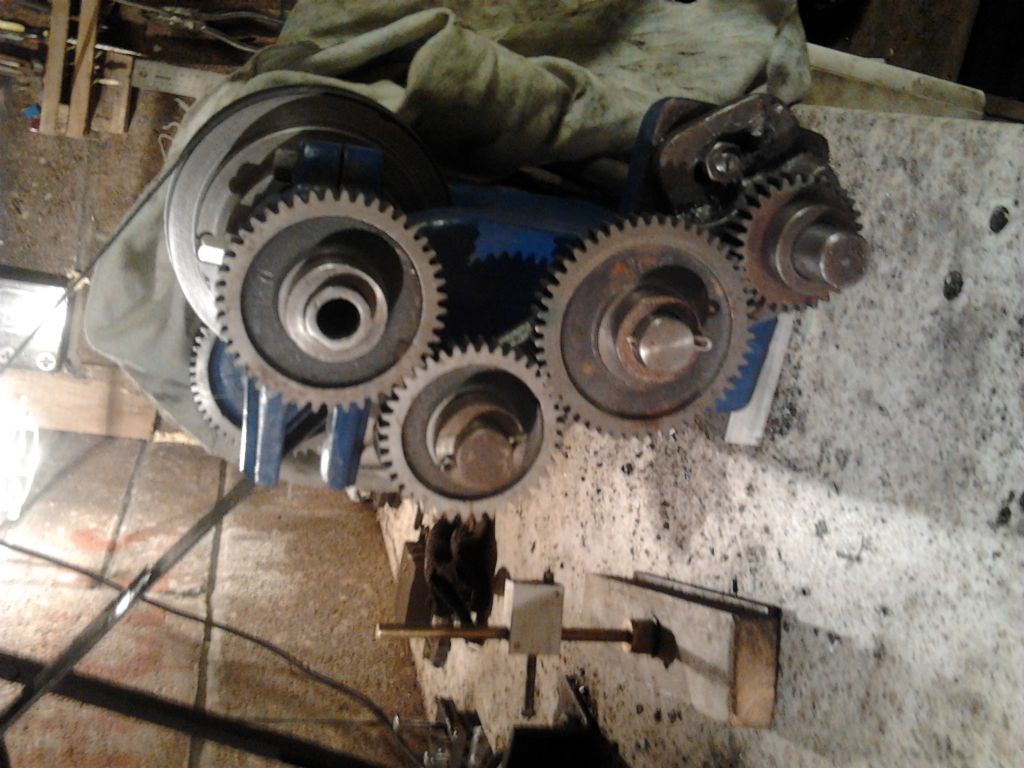

              Is this the best way to go about the task. Its the best I can think of. I set up the gears using that NPprogramme. Not getting the TPI I would like think its a miss understanding of idler gears. I'll take another pic of my banjo setup.

                      No dials im afraid on the controls but two DTIs, one on the cross slide to reset zero after a pass and one mounted on the bed to get back to start point zero i was originally using a g clamp and winding back to set zero. I leave my half nut closed just dis-engage back gear after completing a pass and wind backwards using lead screw handle slightly past zero then forward to zero because of backlash. my four jaw backplate is of the wrong size, luckily its smaller so I only need to bore it out and re-thread. Can I use the three jaw for the operaation? For now I am concetrating on external threading my plan is to make a replica of my spindle nose. then move to internal.
                      Excuse the rust first time out for the gears. The programme states for 12 tpi 45 driven which is on the lead screw and driver 30 which is on the manderal. the other two are idlers? I think this is wrong though. I have read the spindle nose could be 12tpi but also read it could be 8 tpi? I do know how ever my lead screw is 8 tpi. looking at the picture I can see I have the 30 on the leadscrew and the 45 on the manderal doh!

                          In your last post to cut 12 TPI with an 8 TPI leadscrew you need to gear the leadscrew down by the ratio of 8/12 which is 2/3 which is also the same as 30/45 so these gears are correct. In your text the way you say the gears should be fitted is correct but your picture shows the larger gear on the spindle and smaller gear on the leadscrew. If you need to cut an 8 TPI thread then the gearing should be 1:1

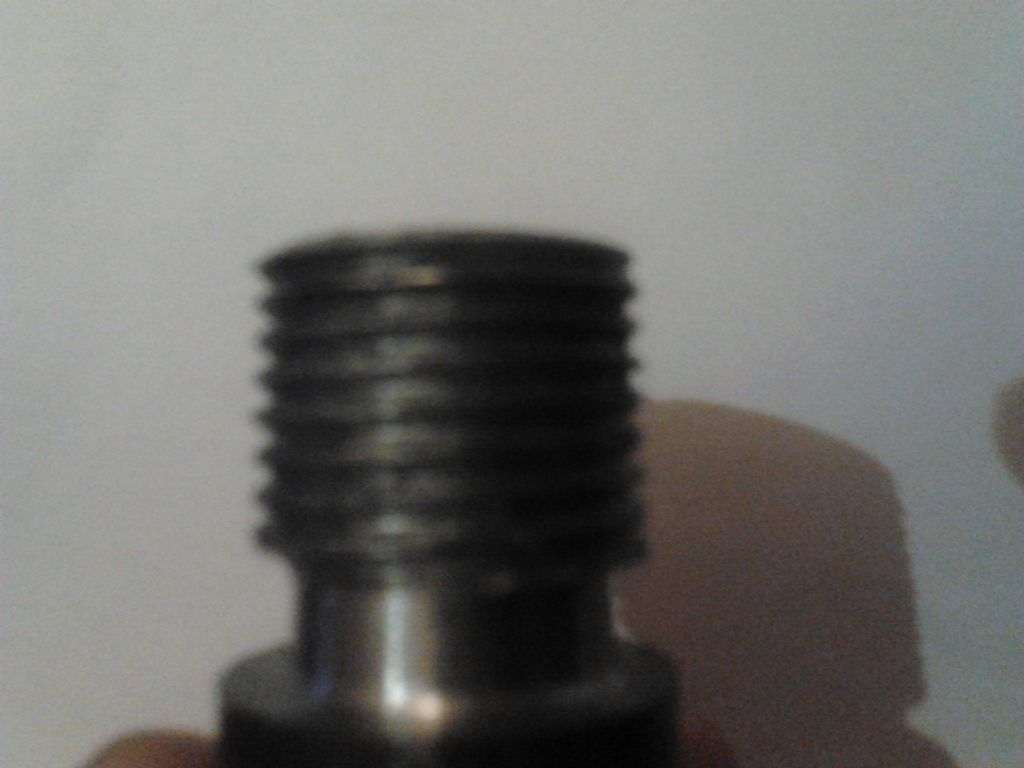

                              Did an hour before the football started. Didn't manage to get to depth but I am going to call this cracked guys no parting what so ever. The thread profile is a little rough, I'll blame this on tooling and material (rock hard piece of shaft, all but run out of practice scrap!) I did measure the spindle nose and of the half inch that is threaded I count exactly Six crests. A little more practice and I'll be ready to complete
                              Poor pic quality sorry guys. Ordered my thread gauge looking at tooling now any thoughts fellas? I was looking at RDG brazed tooling? I can't thank you enough guys.

                                From the photo it looks like you have the top slide set to the wrong angle. If you insist on using an off set top slide method (it really isn't the only way), you want the top slide set to half the thread angle not from the lathe axis but from the cross slide axis. Using the protractor markings you don't want 27.5 deg but 62.5 (BSW/BSF threads). in other words, swing the top slide to be in line with and over the cross slide, then move it back 27.5 deg. It is a common mistake to read in books about setting half the thread angle and assuming you read the protractor for this purpose, but it is not that simple. Following what you thought you read you will end up with an unequal thread.

                                    I made this gauge **LINK** for BSW angle to aid my setting so all is correct. On my machine the protractor is infront of the compound when its paralell so I can do half instead of the full angle. I'll call this thread done guys thanks an absolute million for the help guys wouldn't have been able to do it with out. I shall add a final pic of the finished backplate when done hopefully over the week end.
