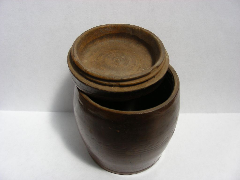

                                              Sobering to think that these used to be made by hand turning methods. I believe this is an example:
                                              I seem to remember that in his classic "The Practical Woodturner" Frank Pain suggested that the men who did this work went mad!
                                              Edited By ega on 04/07/2019 11:59:53

                                                    Yeah, making that threaded pot,must have been madding. Where is NZ? ( I see you in a uniform;USAF)? Lathes turn too fast to do threads, there is mechanism that is turned by a handle,has a 1" pulley and a 2" pulley both with cord,a router sits on a bracket with a special bit. Someone turns the router on and turns the handle, it make thread like designs into a rounded piece of wood(the router moves quicker than the wood, due to the 2" pulley). A Dremel tool is usually 1/4",not sure what bit to use, a 1/4" trim router may work with a 1/4" shank bit, don't know if a double angle bit comes with 1/4" shank. I have a smaller size router like WoodSmith used,have to check if the 1/2" shank will work on it(would take a 1/2" collet.
