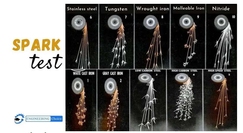

          #828052
            Welcome to the forum.
            The answer is the spark test, whereby steels are identified, approximately, by holding a sample against a grinding wheel and looking at the pretty sparks:
            Screenshot From 2025-12-07 19-43-21
            The picture is from this website, which explains in more detail.  Grinding wheels are common in metal-bashing workshops, they’re used to sharpen cutters, and to form shapes.
            As to giving literary advice, I remember Ray Bradbury being rude about fans critical of his description of Mars.  He sharply said it was a novel: science fiction not science fact!    You might make how the hero gets into the workshop after being told to buzz-off part of the story.  Or, take Neville Shute’s approach in “Trustee From the Toolroom”.  The novel celebrates  model engineers around the world helping out selflessly.  The Trustee has only to ask…
