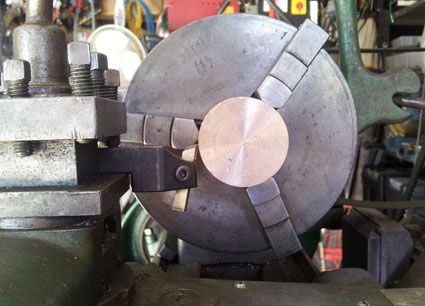

                                        Andy,
                                        The toolbit is tangential to the job. The end of the toolbit is a diamond shape. Hence both names.

                                            Andy, I was about to give the answer that Paul has give but then realised it is not quite true. The axis of the tool will be at about 12 Deg. to the tangent if the tool is at centre height. ( The tangent at centre height will be vertical.) I suppose it is just being pedantic arguing about the 12 Deg.

                                                  Exactly, Les. If it were truly tangential, the tool would rub rather than cut. But you're right; it was pedantic of me to mention it. Everyone knows what a tangential tool is.
