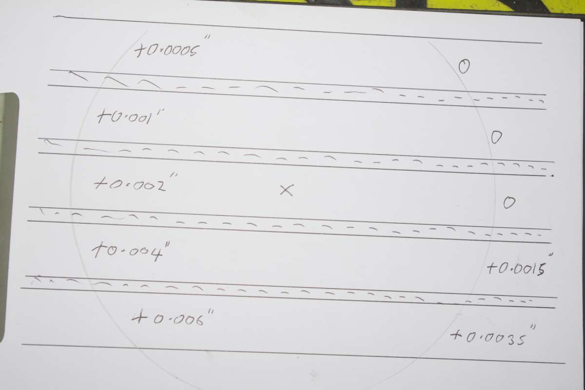

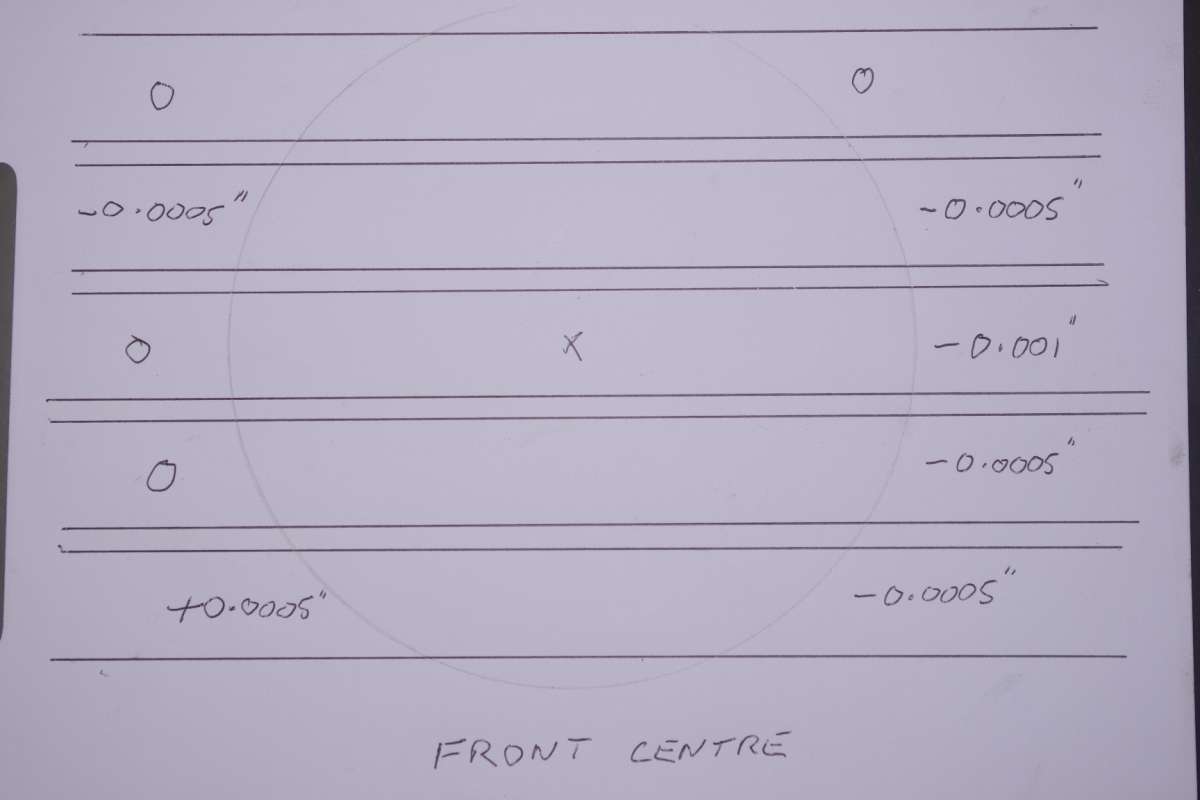

      Hello,
      My SX2PG milling machine has got a right head tilt of about 4 thou. I’ve lived with it up till now. But I need to do something about it in order to do more precision work. See pictures 1 and 2 which show that as the head is moved down the error gets worse over a height of about 3-4 inches.

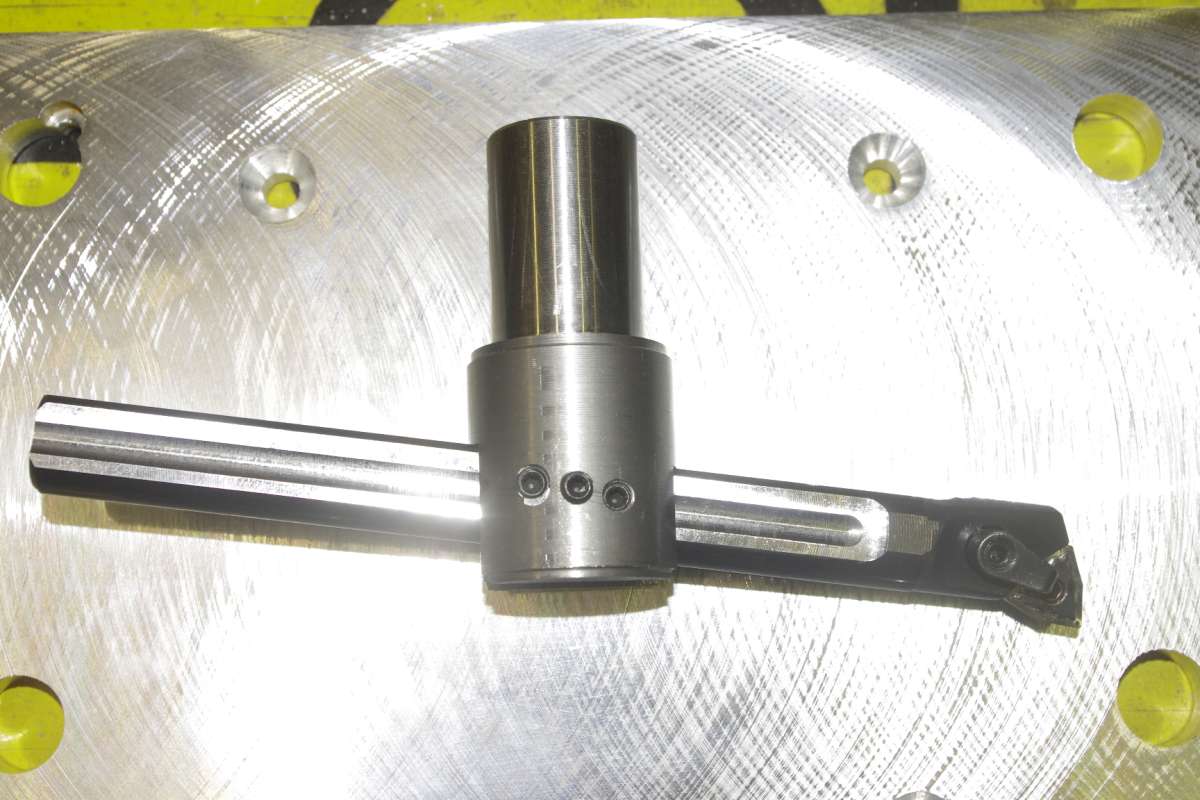

      Google AI suggests that I remove the head, separate the spindle housing from the carriage (held by 4 – 8mm cap head screws) – see picture 3 and then shim the right hand side of the mating surface.
      Before I take the head off again and separate the parts, is there anything I have overlooked.
      This is the link to the images
      Many thanks,
      Mark

        Decide if it is the head tilted on the column or more likely the column is tilted relative to the table. If that is the case then loosen the bolts holding the column to the bed casting and shim with something like feeler gauge material. Both my Siegs are shimmed like that.

          I’ve swept the table relative to the column, shimmed it, and run out is only about 1 thou. But I think the head is tilted relative to the column. Presumably this scenario is unusual with these machines? And it’s only 9 months old.
          #840921
            I don’t see how the shimming you suggest would alter the readings you are getting? Loosening the 4 screws and seeing if you can slightly rotate the spindle housing relative to the part with the dovetail is more likely to see things move in the right direction. Then you would need to reshim the column to suit the adjusted head buy swinging the dti over the table.
            #840922
            Mark Salzedo 1
              @marksalzedo1
              Yes, that sounds more realistic. The problem is how much you slightly rotate it. To remove an 8 thou tilt is a very fine movement. But I guess it’s going to be trial and error.

                If you laid it on it’s side on the mill table, clock the rod so it is horizontal and then clock the dovetail until that too is horizontal, you should be able to get quite close without having to keep putting it back together and testing.

                    I think the head must be slightly off centre and by rotating the carriage section in relation to the spindle housing will correct the error. The problem is by how much do you turn it. Compensating for 4 thou is an infinitesimally small amount. I have placed some scribe lines around the spindle housing which sits just above the head as a baseline but this is not a very accurate way to do things.
                    Jason’s idea is theoretically sound. The head can be laid on its side on the milling table. But I will need to think how to do this due to its size and shape, and then to fit a test rod in the spindle and sweep the dovetail and rod.
                    The four cap screws holding the carriage to the spindle housing are quite easy to remove and the carriage can be rotated slightly to offset the inaccuracies.
