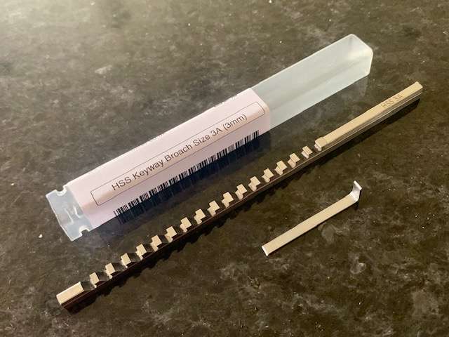

                  I got the broach. It came with a small shim, but I assume that any shim would need to be at least as long as the bush/hub for it to work properly?
                  Also, when setting up in the press, is it a good idea to angle the work slightly so that the ram is always pressing the broach towards the bush? I think it was Ramon who mentioned that a broach could climb into the work and cause issues.

                    Yes you would want to make a longer shim so the broach is supported through the whole length of the hub.
                    I’ve always done it vertically.

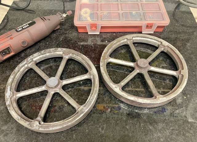

                      Continued with de-scaling the wheels. I’ve run out of grinding bits for the Dremel, so have had to pause until new ones arrive next week.
                      IMG_3459(1)
                      Gave me chance to consider the barring slots again – I think they will have to be a separate insert after all to to space constraints at the rim. I think I could possibly get away from laser-cutting by turning an insert from mild steel – or mill a ring using the R/T, then fit it with JB Weld, then cut the slots. I suppose the insert would have to be perhaps 1 mm or so deeper than the slot depth to keep everything looking like a one-piece casting. Ideally I’d paint it final colour before milling the slots to save a load of masking. I like the look of plain metal on the machined slots.

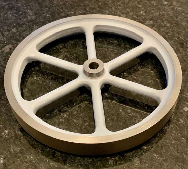

                      #796321
                      Dr_GMJN
                        @dr_gmjn
                        Slightly waylaid with kidney stone treatment last week (deep joy) but back to the flywheel:

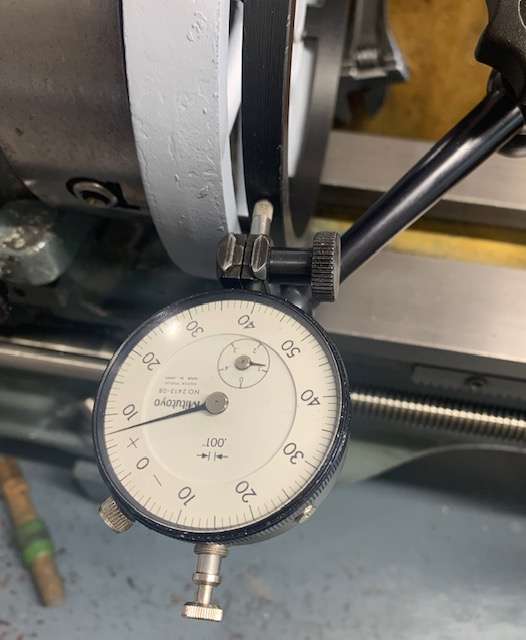

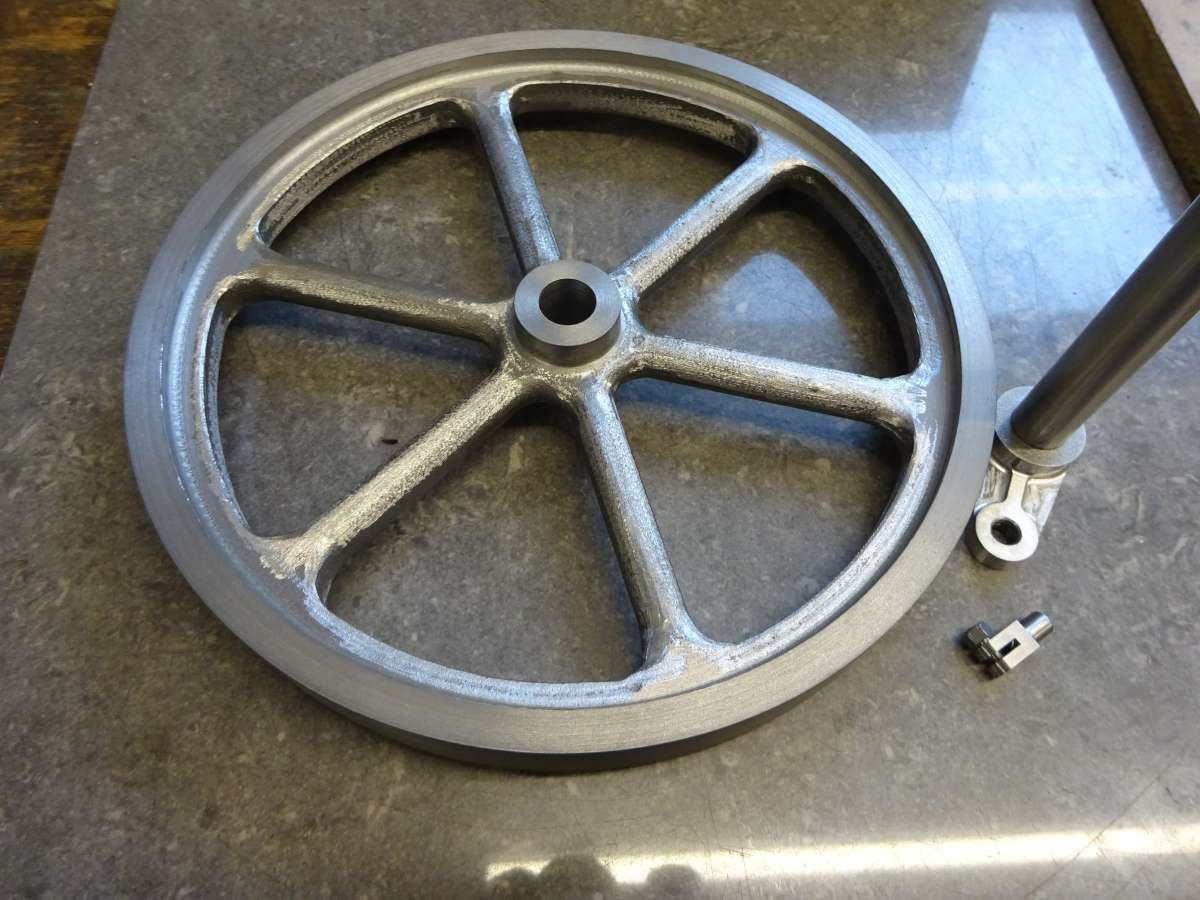

                        I was having trouble centering them in the 4-jaw chuck, because the position of the edge of the inner rim (which I was centrering to) I found difficult to judge, and of course using a dti is impossible becasue of a) the cast surface, and b) the spokes are in the way. I printed a stepped ring that was a fit on the inner rim in six places (radially and axially), and was offest a bit. This gave me two ‘best fit’ faces to true to:
                        IMG_3583
                        IMG_3584
                        I could get it to 0.010″ radial and 0.006″ axial, which I thought was OK. Running it up in the lathe seemed to confirm all was well.
                        The o/d cleaned up easily enough:
                        IMG_3585
                        As did the central boss:
                        IMG_3586

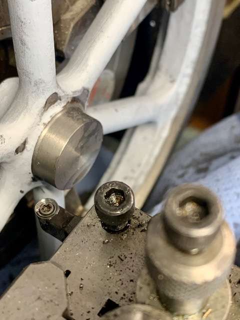

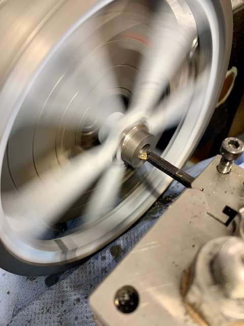

                        I used a button tool to try and blend the machined bits to the cast bits to eliminate any visual wobble there. This sort of worked, but I’m still left with the imperfections in the casting, especially where I removed the square pads:
                        IMG_3588
                        IMG_3597
                        I wondered wheter to just feed the button tool in all the way and machine the radius, then paint it, but then again I thought why not wait and just use Milliput after everything is done. It is after all only on one side – the other will be machined for the barring ring. The opposite side will need Milliput to fill the caphead counterbores anyway, so it wouldn’t be such a big deal to do the whole circumference.

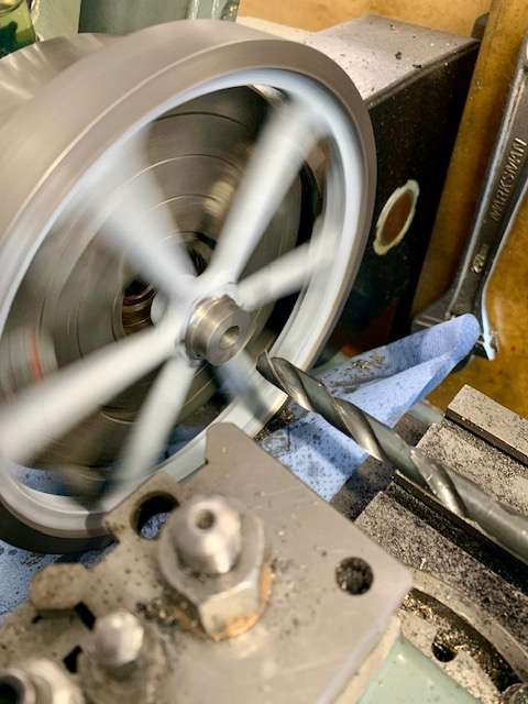

                        I drilled the central hole up to 10mm:
                        IMG_3589
                        Then used a 10mm end mill in the hope of being able to get a more accurate diameter on both wheels, Unfortunately I’d not accounted for the step at the shank end of the mill, so it wouldn’t go all the way through. I ended up boring it slightly over 10mm:
                        IMG_3590
                        I suppose now before setting-up the second wheel, I should turn a spigot to fit this bore, and then bore the second wheel to suit?
                        I’m wondering whether if I turn said spigot between centres, I can use it to subsequently centre the pair of wheels on the faceplate before clamping the spokes for final machining? I could then remove the spigot and finally bore the boss to 14mm diameter for the crankshaft. Seems like it would be easier than tapping it with a hammer to get it true?
                        This is the current situation. Needs 0.9 mm removing from the joint face to get the overall width right. Not checked the boss protrusion yet, but it looks approximately ok:
                        IMG_3596

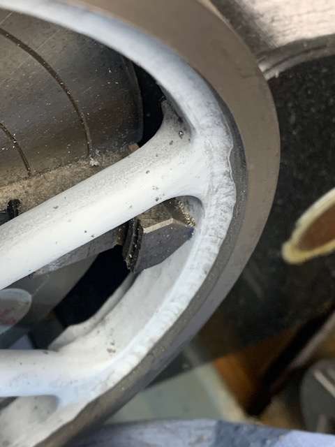

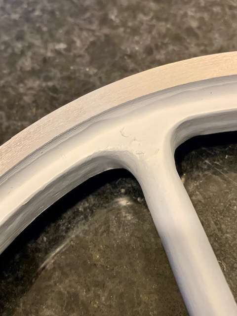

                        What is the best way of smoothing the cast surfaces? I’ve been using Dremel tungsten burrs and grinding bits, but they are a bit harsh and don’t give good control. The sanding barrels would be OK, but hardly touch the surface before becoming smooth or disintegrating.
                        Anyway, I’m still hoping to be able to get the wheels stuck together by the end of the bank holiday, and I’ll worry about surface finish later.
                        Thanks.
                        #796362
                          Yes turn your pin to fit the first wheel before starting the second.
                          I would still clock the rim when it comes to doing the pair, Unless your pin sticks out a long way and is a perfect fit 1thou of reading at the hub could be 7thou at the rim.
                          I only tend to use burrs on very hard castings, the grinding bits work for me and as you say the sanding drums and spiral wraps wear as they are not really for removing that much metal maybe just final touching up. These are the ones I use most of the time.
                          From the last photo it does not look like much more is needed, they are after all cast surfaces not machined ones you are replicating.

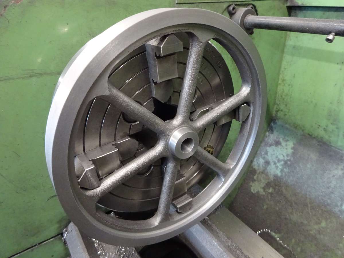

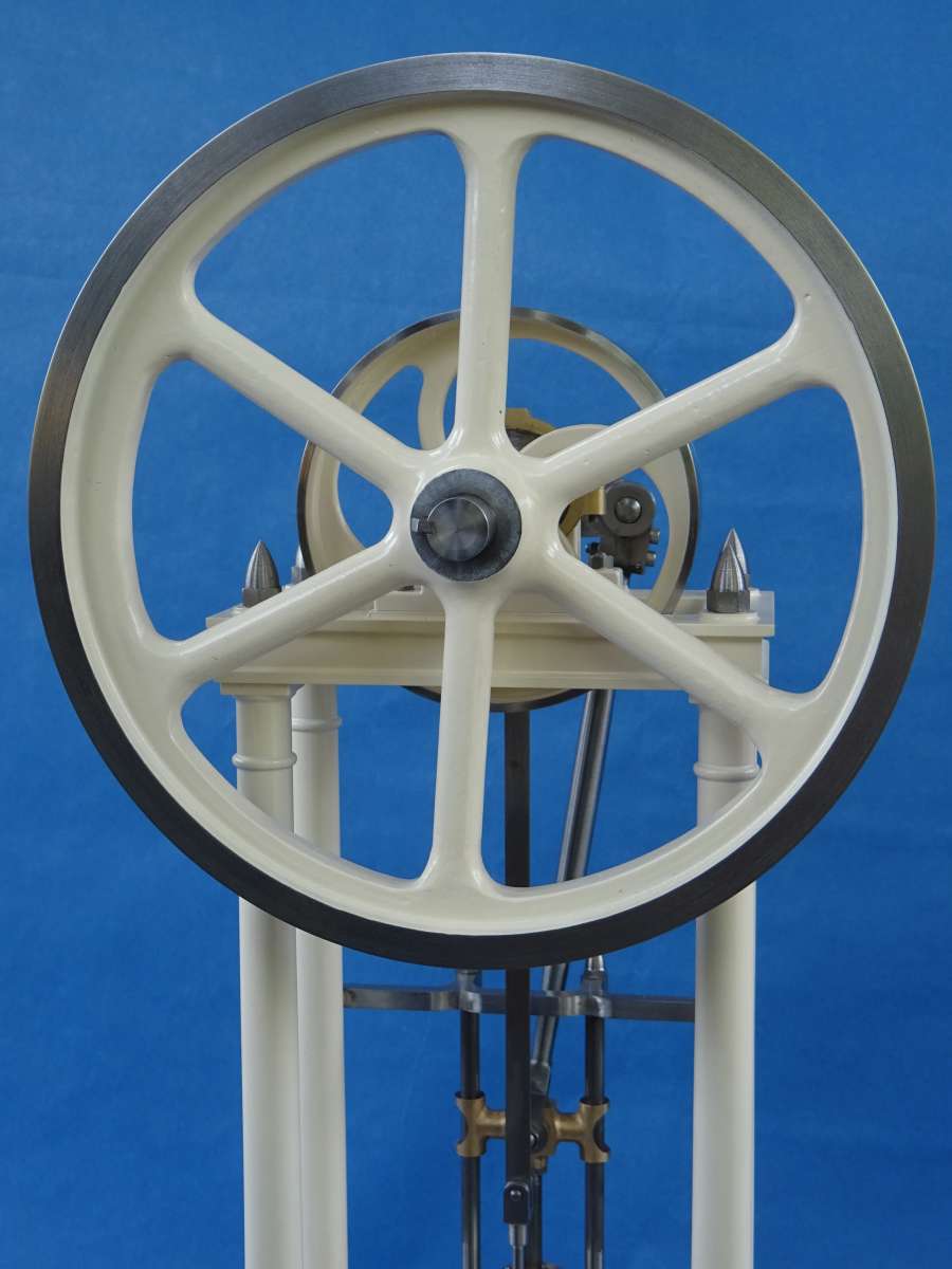

                          I think this was the last Stuart Flywheel I did, you can see the “flats left where I have used a tool with approx a 1.5mm radius on the end to clean up the insid eof the rim at the same time cutting away the bosses. This was finish bored on th efirst setup
                          DSC04429
                          Then to do the other side I clocked the previously machined face & side of the rim.
                          DSC04428
                          After machining out with the Dremel to tidy the slokes and blend in the “flats”
                          DSC04435
                          Some high build primer and paint and thats it
                          DSC04582

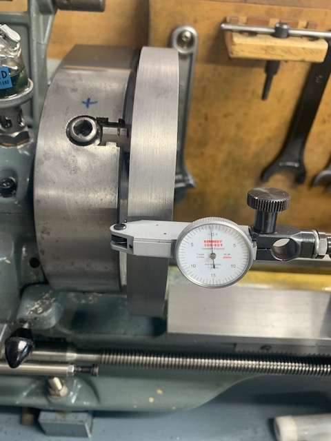

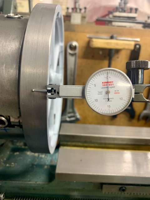

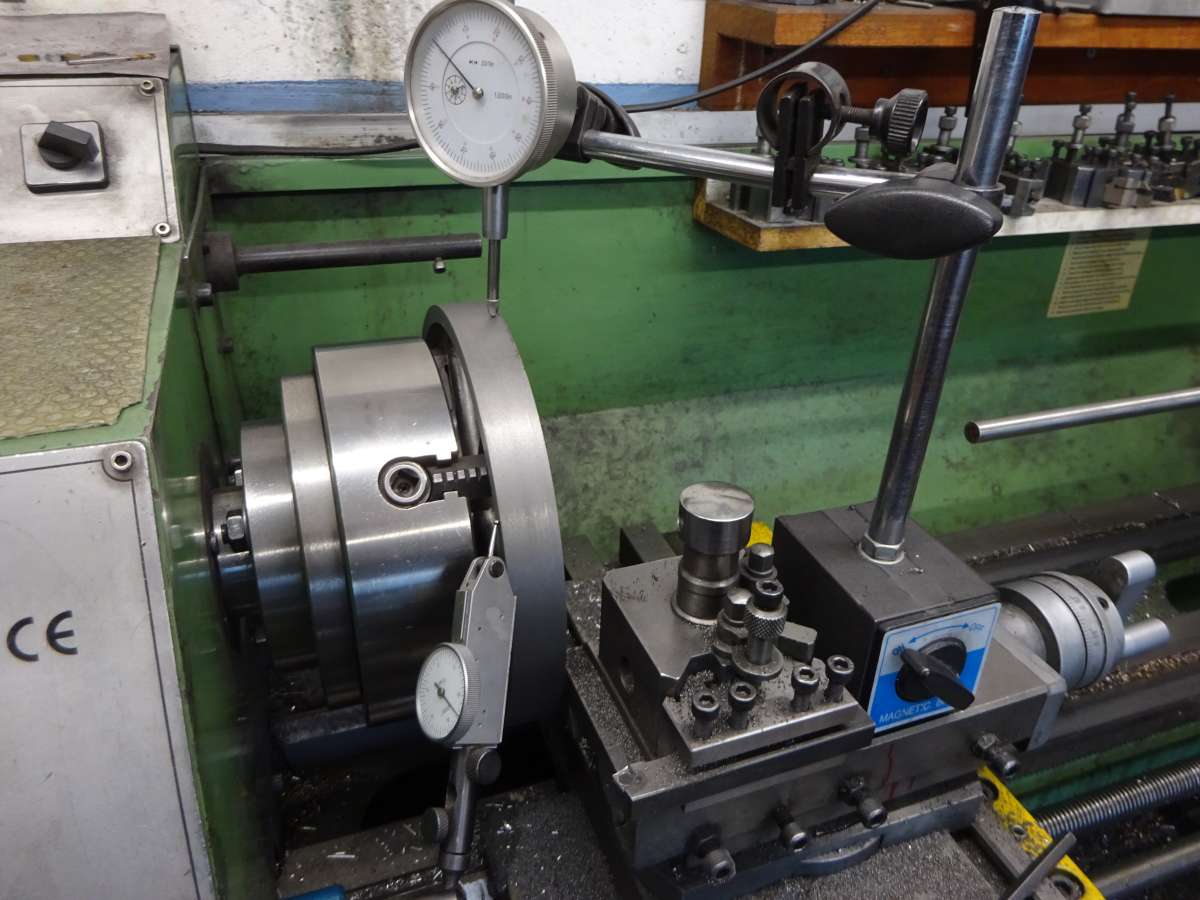

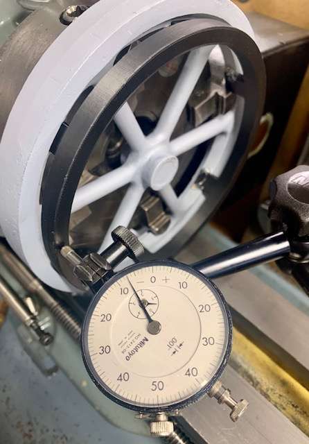

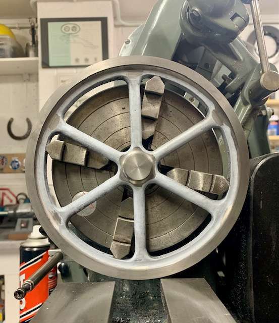

                              Re-set the first wheel without much problem. Got it more or less spot-on, but couldn’t quite get it perfect. It’s all going to be finally skimmed once assembled I guess, so no big deal:
                              IMG_3606
                              IMG_3607

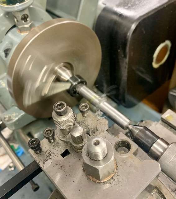

                              Faced the mating faces without issue, and then re-bored the 10mm hole a bit to true it perfectly, then the larger diameter which will be inside the middle of the hub to a depth of about 10mm:
                              IMG_3608
                              Then turned the locating spigot between centres:
                              IMG_3609

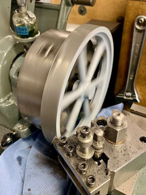

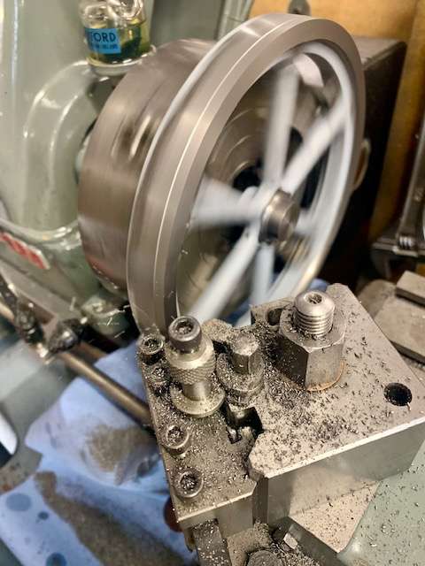

                              Then set the second wheel in the chuck:
                              IMG_3610
                              IMG_3611

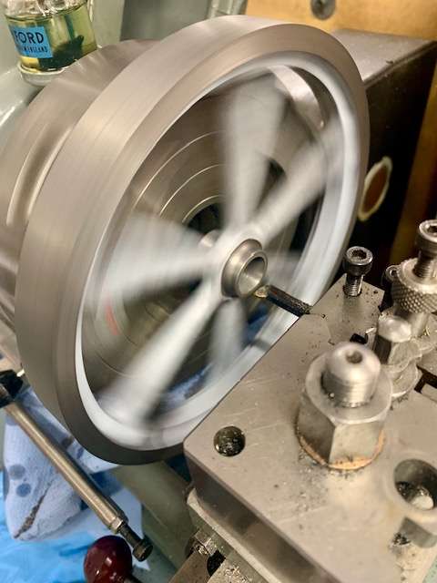

                              And turned the outer faces and boss without too much problem, although the scale seemed a lot more robust on this one – a few sparks until it all got cleaned off:
                              IMG_3614

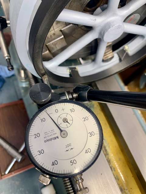

                              I’ve left it for today – I need to figure out how to measure the outer diameters to get them more or less matched before joining; they are too big for any of my calipers:
                              IMG_3615

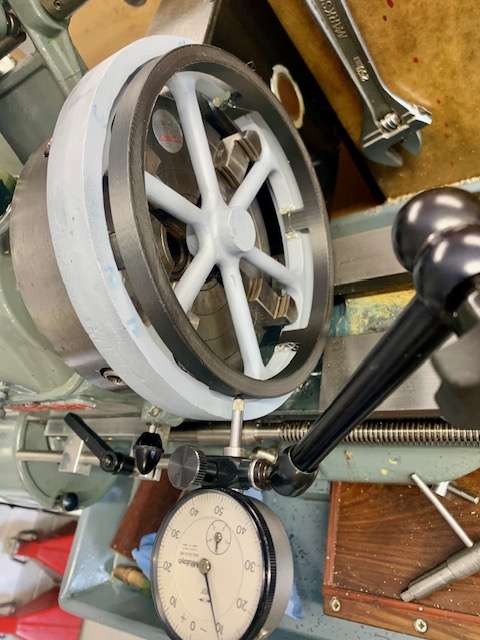

                                I found a method online of measuring diameters of more than the calliper’s opening dimension – by measuring a chord length, and its distance from the circumference.
                                Might give it a try.
                                #796438
                                  A flat or square length of bar with two toolmakers clamps set to touch the rim of the first flywheel can be used to gauge the diameter of the other. One step further is to add a feeler gauge of say 20thou when you set the clamps, this will allow your gauge to slip over the second wheel as it gets within 20thou of finished size and if you then use thinner fealer gauges you can measure the gap and take the gauge thickness from 20 to give the final amount to come off.
                                  #796446
                                  Dr_GMJN
                                    @dr_gmjn
                                    Thanks Jason. I suppose another variation of your method would be to set the clamp on the second wheel (the oversized one currently in the chuck), then put it over the first one and use gauge blocks to find the difference. Then half that figure and use the cross-slide dial to turn to size?
                                    Before doing that I’ll turn it around in the chuck and bore the hole, so that the final o/d and mating face will be all perpendicular. Then finally turn the o/d.
                                    #796447
                                      Might I suggest that if you simply wish to match the diameters, it would be much easier to check the circumferences
                                      Simply wrap a length of fine wire around one, and then t’other.
                                      No absolute measurements required.
                                      #796449

                                                  Going back to the handwheel suggestion. Put your alignment pin in the flywheel that is in the chuck, slip on the previously turned one and touch the tool on the rim and zero the handwheel. Now you know the setting to turn the second handwheel to.
