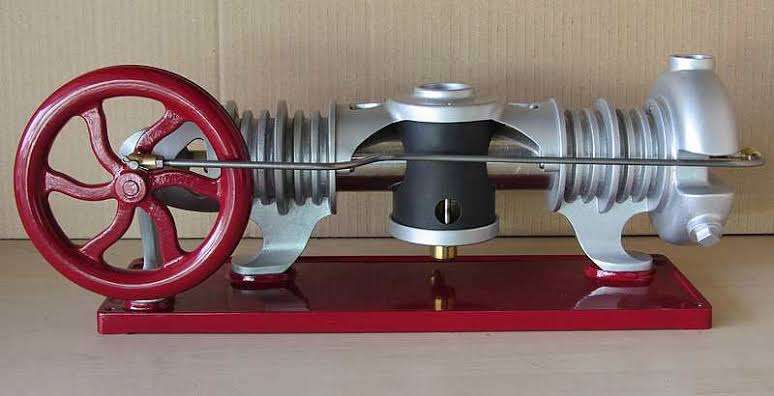

                          One of our members is currently building an opposed piston IC engine.
                          I can’t see why it would not work for steam. Really it just needs to be two Uniflow or single acting cylinders sharing a common “head”. As they would be single acting you could get away with just conrods and no need for crosheads and their associated guides
                          One of Elmers many enginedesigns is a simple opposed piston engine, I’ve got the drawings knocking about
                          Variations on the theme are IC engines like the popular Mery casting kit which has a central piston and combustion chambers at either end

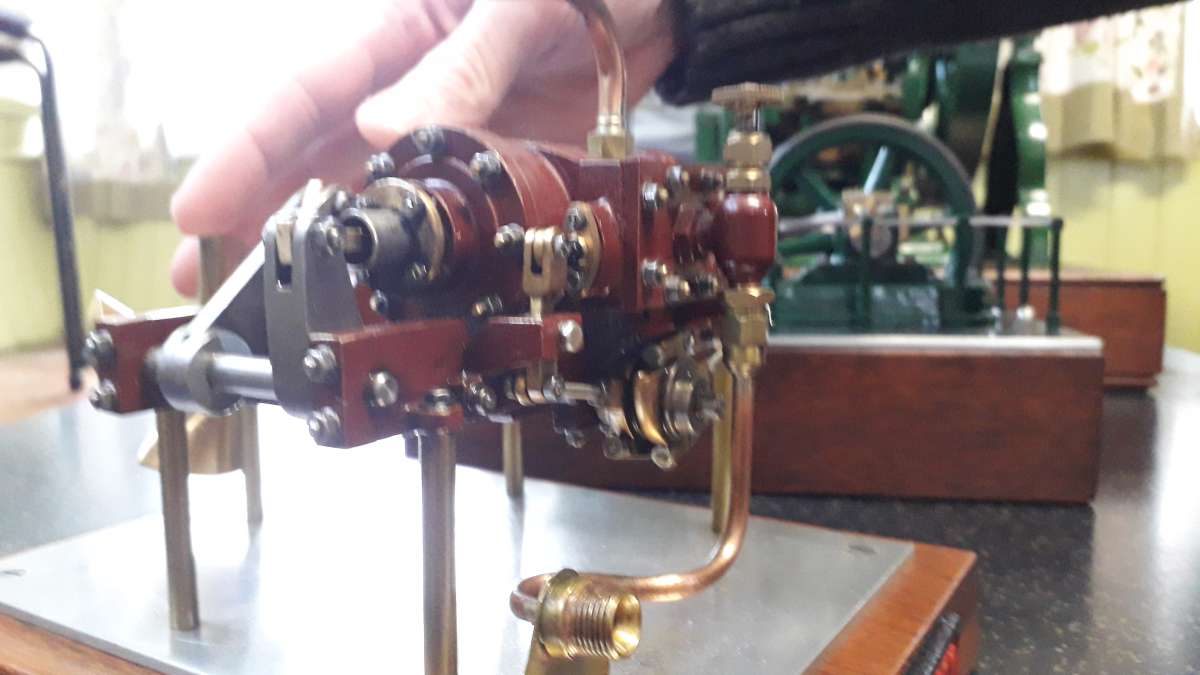

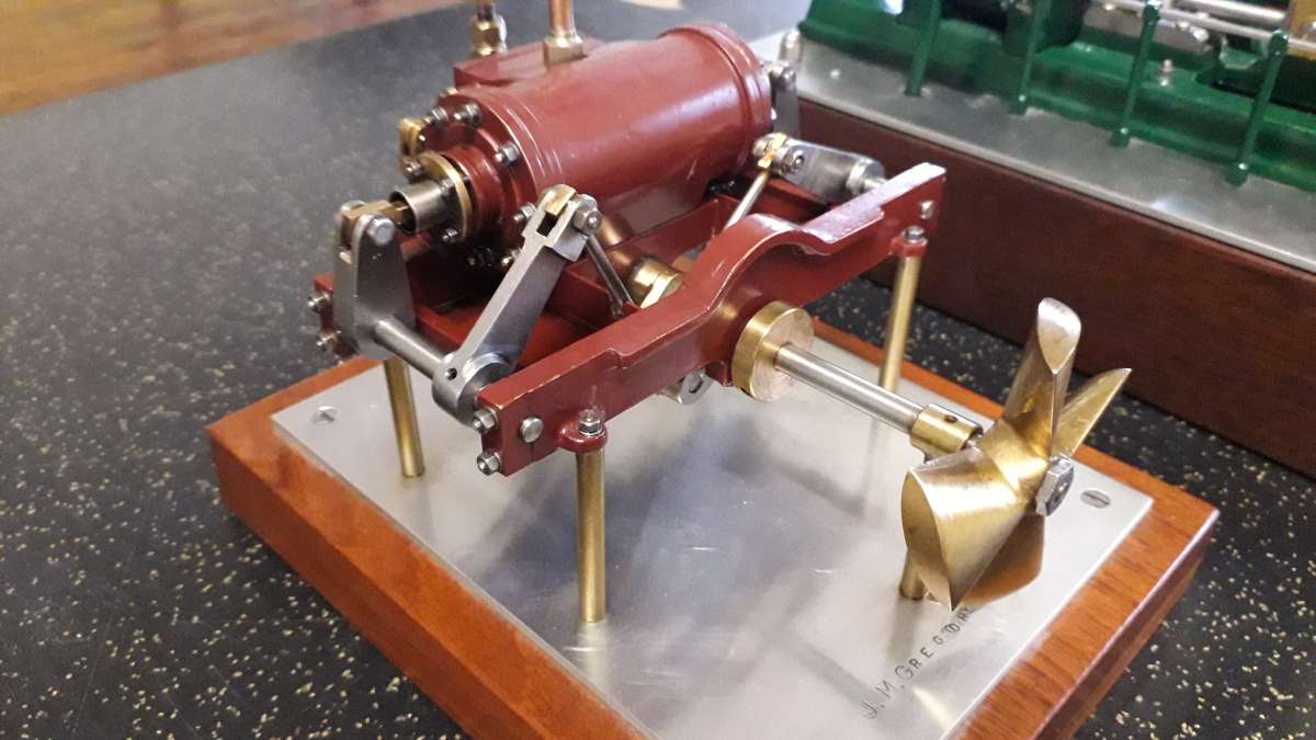

                                        This is quite a nice model, I think it is one piston but with opposing rods. been a while since I saw it in the flesh.
                                        20181124_103045
                                        20181124_124222

                                          Richard Simpson
                                            @richardsimpson88330
                                            Jason,  Trying to put the bits and pieces together from the pictures.  Obviously two throws on the crankshaft connected via the shaft to two piston rods in either end of the cylinder.
                                            It does look like though the large arms on the shaft connected to the crankshaft via the con rods are both angled inwards.  It does look however that the two piston rods are both in different positions, one being all the way in and the other being all the way out.  This would tend to indicate that, if there are two pistons they are not working in opposition.  Maybe the rods are both connected to either side of the same piston.  Or maybe one piston is the working piston and there could be another opening and closing ports.  Although there does appear to be a valve chest so I can’t say.

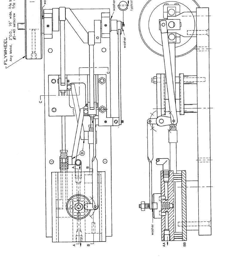

                                                  I remembered that Elmer has another opposed piston steam engine, his #34.
                                                  This is actually a twin cylinder horozontal with each cylinder having a pair of pistons and a rotary valve feeding and exhausting at the middle of the cylinder. One piston is on a solid rod and the other a hollow one so all the linkages are at one end of the engine. I’ve seen a few builds of this one but not the best layout for marine use unless it’s a paddle steamer..
                                                  opposed 34

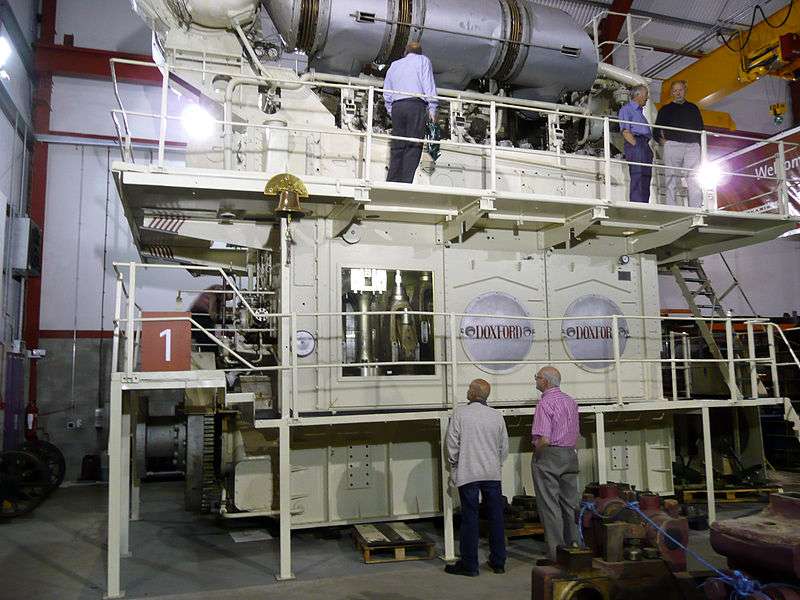

                                                    Probably the best place to start would be the Science Museum themselves.  I sailed on a ship that had one of the last Doxfords ever made.  Usually Doxfords were large slow speed engines but, in a last ditched attempt to compete with the likes of Sulzer and Wartsila they came up with a three cylinder, much more compact medium speed version.  During our last walk around at night, the ship ran unmanned, it was totally hypnotic to lean over the handrails and watch the top three pistons and their beams bouncing up and down at somewhere in the region of 500 rpm.
                                                    The trouble was that, being a 3 cylinder 120 deg engine, there was a possibility that the engine could stop in a ‘dead band’, with all three cylinders symmetrically positioned.  If this was to happen then there would not be any starting torque when compressed air was applied and the engine would not start.  To get around this they fitted a hydraulic device to the front of the engine incorporating a ram with a pin on the end that, when operated located on one of three large curved teeth on a flywheel.  If the engine was stopped in one of the three dead bands and a start command was received this device automatically jumped into action to physically engage, pull the engine out of the dead band, disengage and allow a start.  We nicknamed this device “The Praying Mantis Gear” When I was on this ship there was a story going around that, during trials the Praying Mantis decided to engage itself while the engine was running.  It was apparently ripped out of its mounting and thrown across the engine room.
                                                    We used to test the Praying Mantis as part of our starting up procedure by deliberately turning the engine into a dead band and then trying to start it.  This thing in action was something Heath Robinson would have been proud of.
                                                    This is a picture of the development engine, now housed in a museum.  It is, by a long way the smallest marine engine I ever worked with but it certainly has the most stories attached to it:
                                                    Doxford 58JS3 at Beamish
