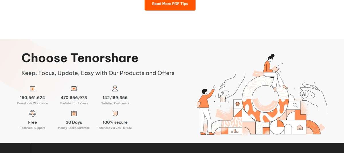

              Diogenes
                @diogenes
                ..a bit of due diligence shows that Tenorshare (the developer) is a global software developer founded 2007, has over 15000 reviews on Trustpilot, and have an expansive website from where one can download the application direct without having to trust a third-party host.
                .if it’s a scam they’ve gone to a lot of trouble.
                – extract below;
