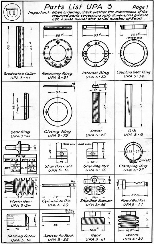

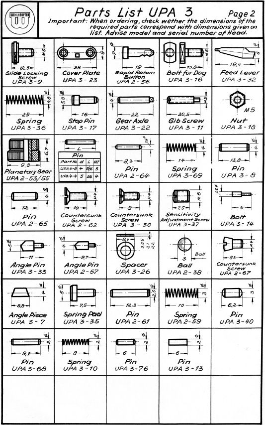

            Martin,
            If, as it seems, the Kuroda is a clone of the Wohlhaupter and you can identify the missing items, I have the parts list in my archive. Here it is, jpegged:
            upa3 parts list_1
            upa3 parts list_2
            Hopefully, you can read them OK, or, if need be, I can send the original by email, if you PM me your email address.
            Edit: The patent , which runs to 8 pages, also contains a lot of detail, as you would expect and is obtainable on the 'net, although I have a copy of that, too, if you haven't already got it.

                Dont have one of those units myself, but if I did ,John,s input would sure help to sort things out !
                Well done John, nice to know that there are people like you around !

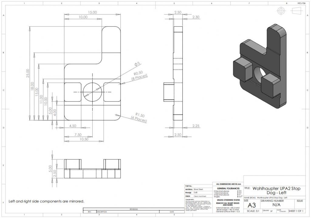

                      It just so happens I made a replacement pair of stop-dogs for my UPA2 last week. Happy to send you over the drawings if they're any use?
                      #539843
                      Stuart
                        @stuart18648
                        Edited By Stuart Pain on 15/04/2021 12:21:08

                          Thank you Stuart,
                          Earlier today John Hinkley kindly sent me his collection of Wohlhaupter documents and now Stuart even supplies a ready made drawing for the missing stop dogs. What a brilliant Forum – thanks again everyone.

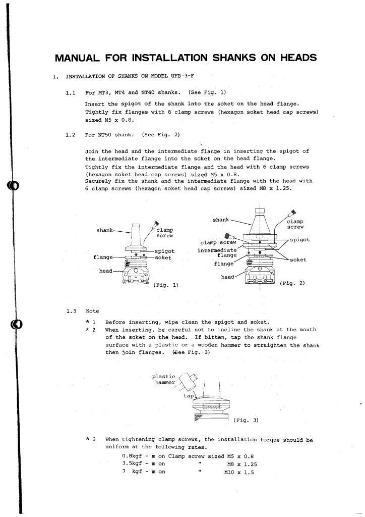

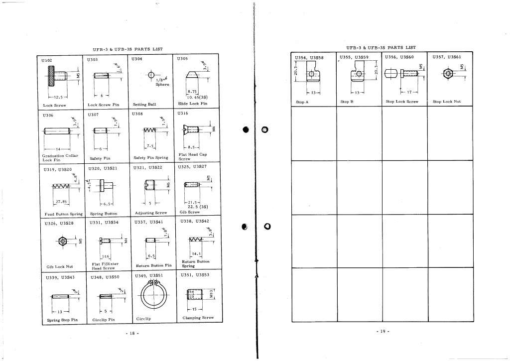

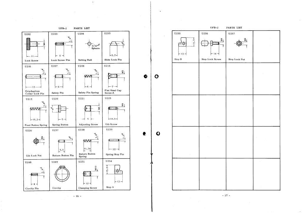

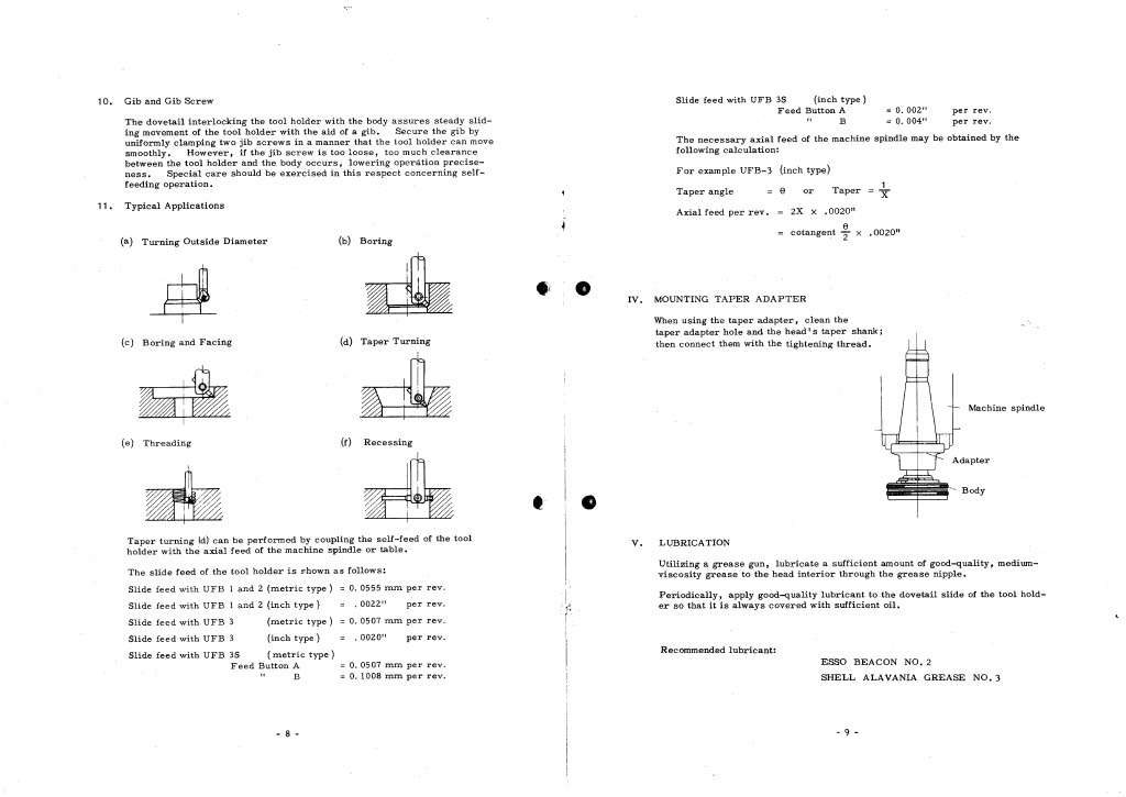

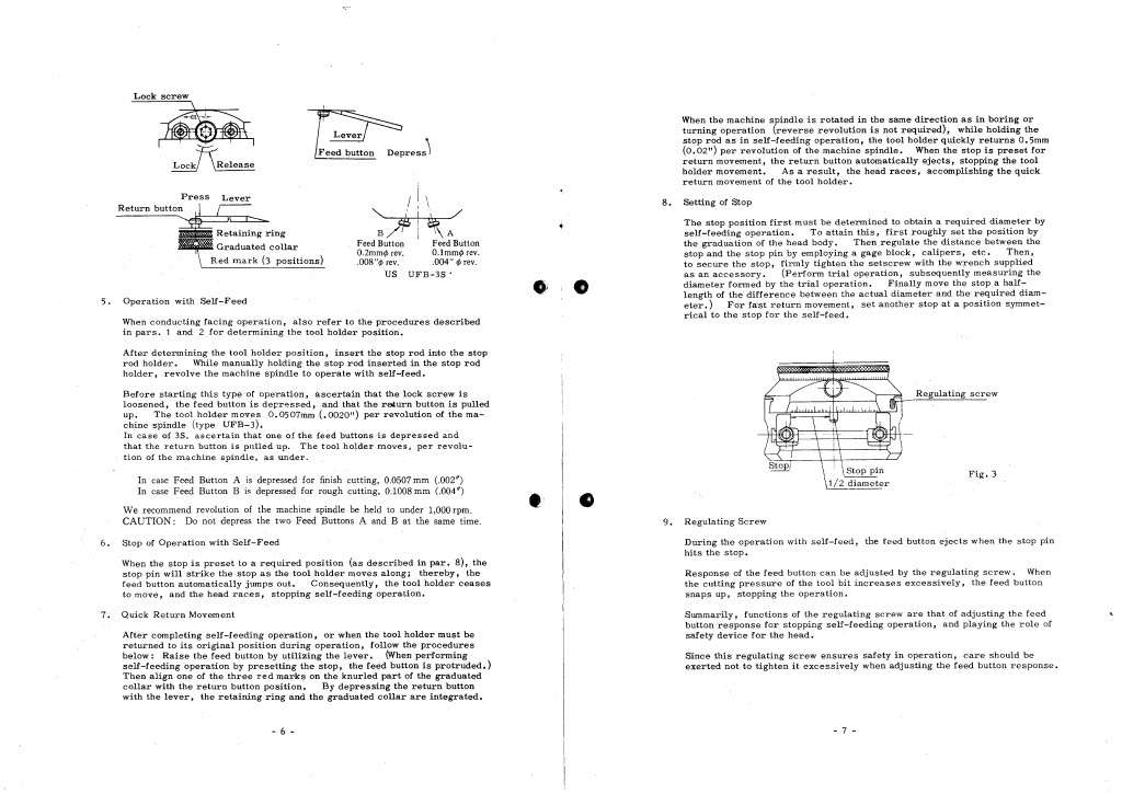

                          ryan.carter848
                            @ryan-carter848

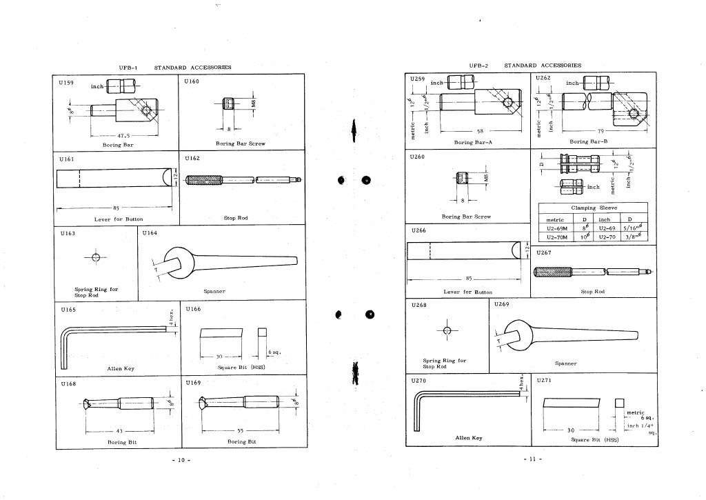

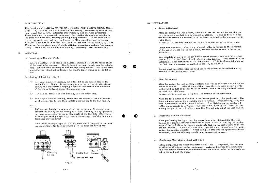

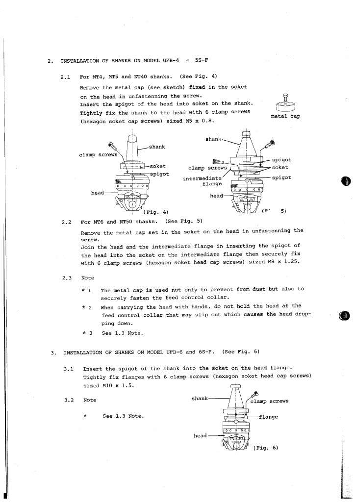

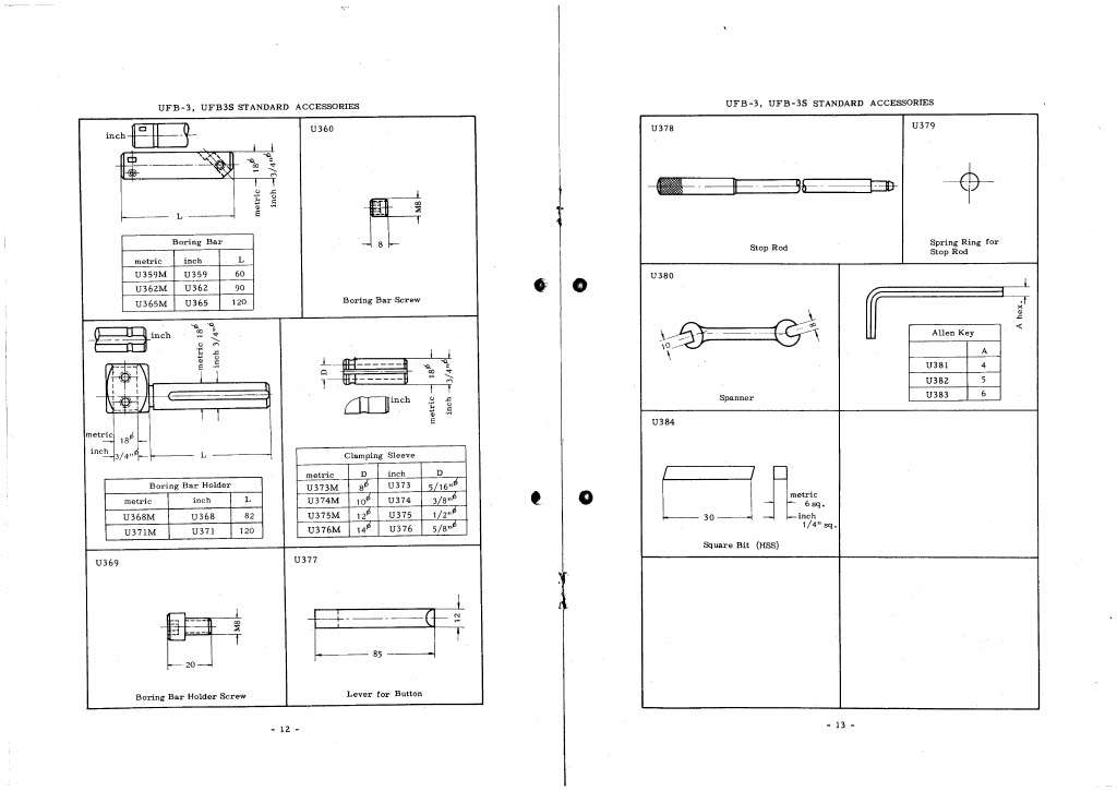

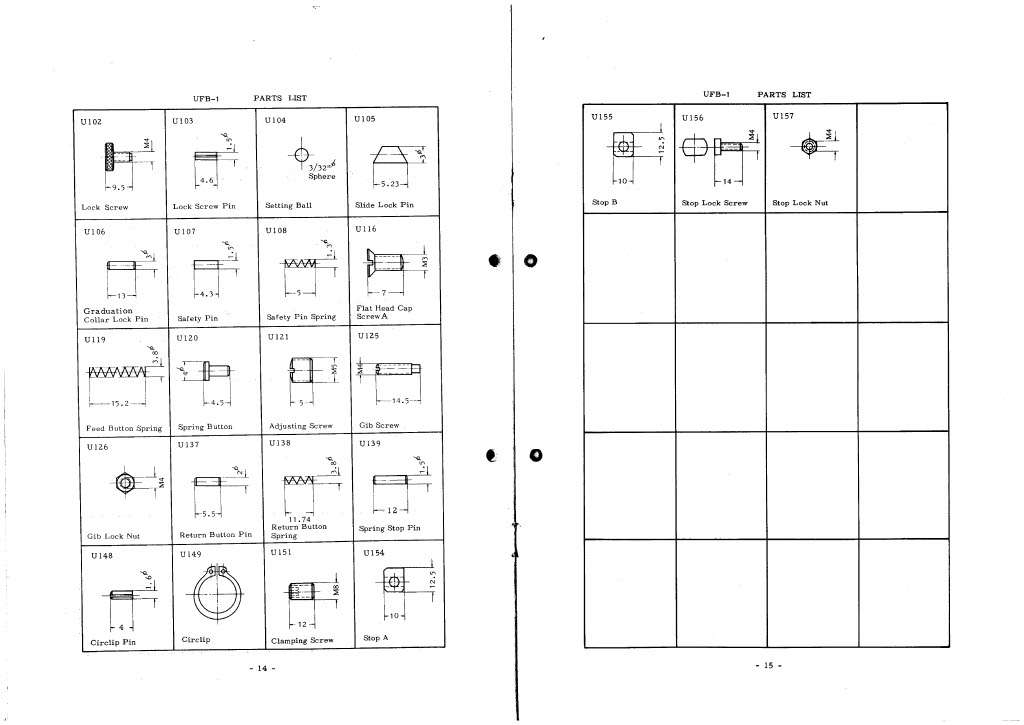

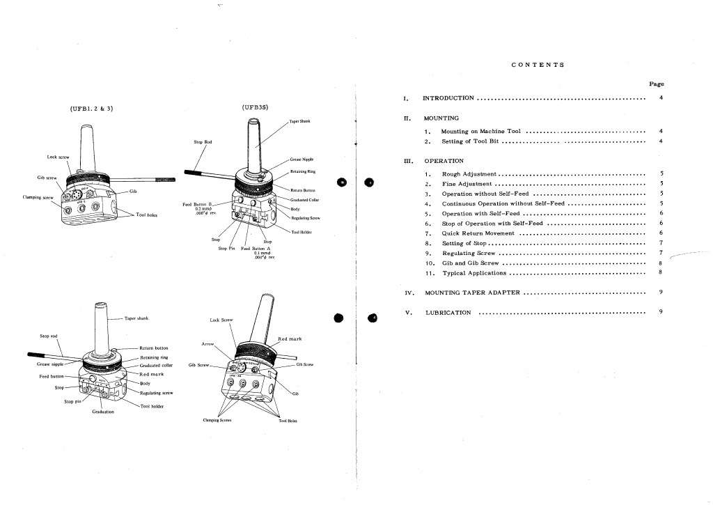

                            Hi Martin, did Kuroda ever get back to you on the manual? Cheers! Only 4 years late to this thread 🙂
                            #813092
                            ryan.carter848
                              @ryan-carter848
                              1755632867051-49c0733f-5715-46ca-a792-f818c409e36a_21755632867051-49c0733f-5715-46ca-a792-f818c409e36a_11755632867051-49c0733f-5715-46ca-a792-f818c409e36a_31755632867051-49c0733f-5715-46ca-a792-f818c409e36a_41755632867051-49c0733f-5715-46ca-a792-f818c409e36a_51755632867051-49c0733f-5715-46ca-a792-f818c409e36a_61755632867051-49c0733f-5715-46ca-a792-f818c409e36a_71755632867051-49c0733f-5715-46ca-a792-f818c409e36a_81755632867051-49c0733f-5715-46ca-a792-f818c409e36a_91755632867051-49c0733f-5715-46ca-a792-f818c409e36a_101755632867051-49c0733f-5715-46ca-a792-f818c409e36a_111755632867051-49c0733f-5715-46ca-a792-f818c409e36a_12
