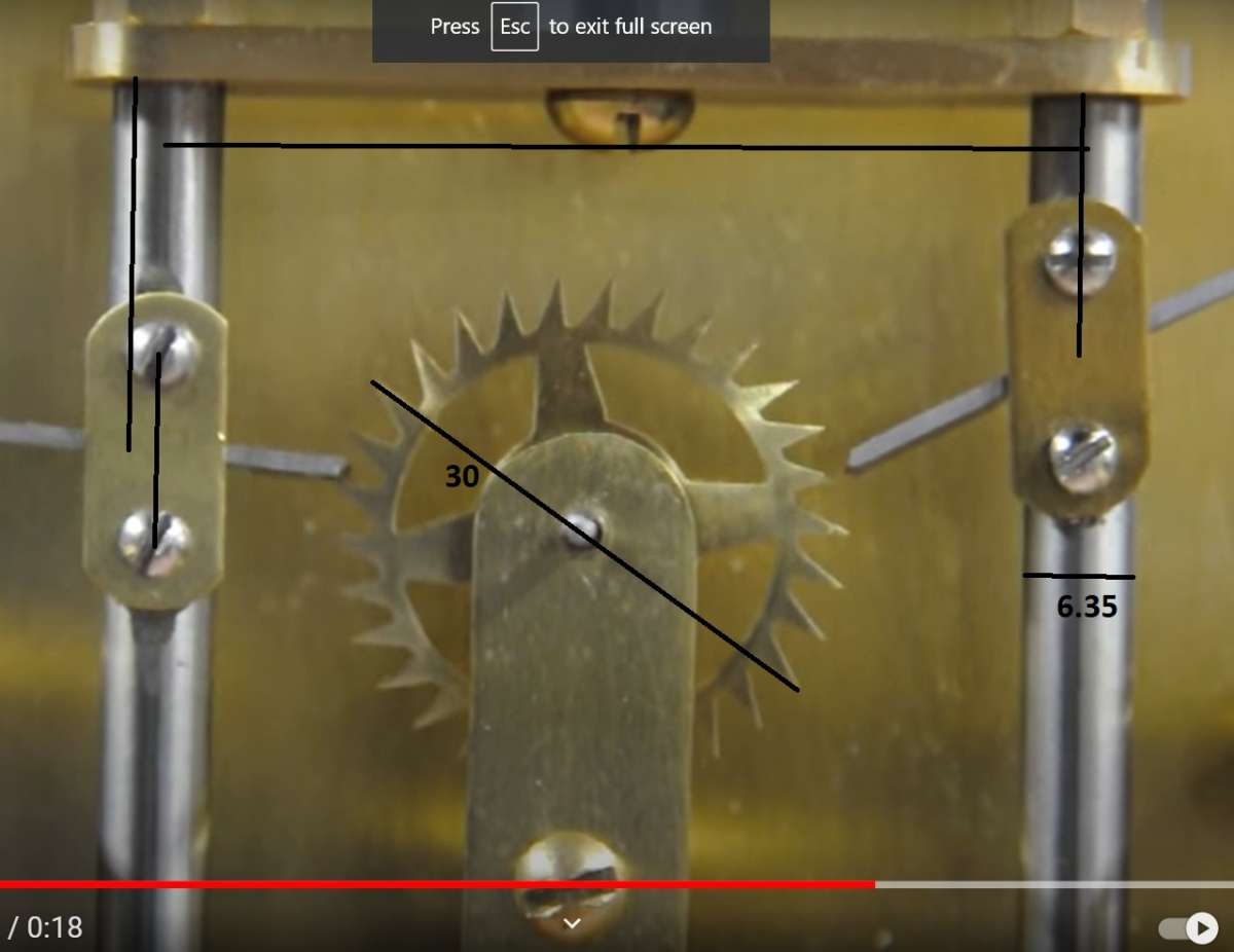

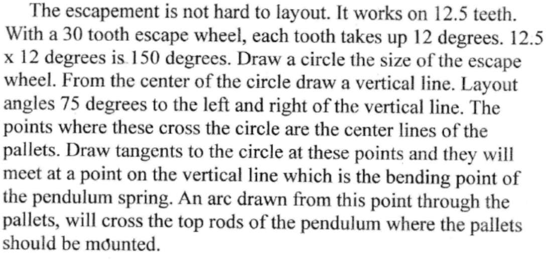

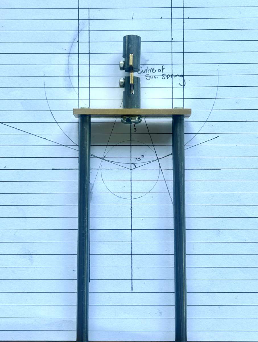

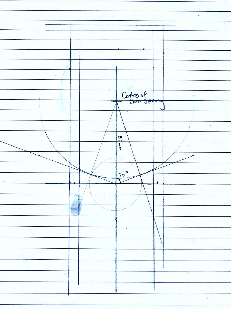

        I am just sat here trying to lay out the escapement and I want to do it based on some instructions provided by Bernie Tekippe below:
        IMG_7264
        So I have attempted to follow these instructions, drawn my escape wheel, marked 70 deg and then drawn a tangent back up to the horizontal. If I’m reading it correctly then the height back from the centre of the escape wheel to this point, which is 52mm, should be the distance to the centre of the suspension spring. I should have considered this before building everything as my current distance is 50mm, but not a problem, I can shave 2mm of the top spring support which will raise the suspension spring. So hopefully this is an easy fix.
        The bigger question is still understanding the layout and location of the actual pallets! It’s that last sentence. If I’m reading it correctly, I’ve taken the distance from the “suspension spring pivot point” to the mark on the escape wheel where it intersects the 70 deg line. I’ve then used this to form a new arc. I presume where this new arc dissects the rods of my pendulum support arms is the location of the pallets, but of course this is an arc and whilst I know dead beat pallets should be an arc, Bernie does do this. Therefore is the correct location for the slot on the pendulum supports a tangent to this line?
        Any help would be much appreciated. My big question is if I’m slotting the pendulum supports, where and at what angle based on my drawings and the instructions. Thanks again everyone.
        IMG_7266IMG_7265

        John Haine
          @johnhaine32865
          Where does 70 degrees come from? The text says 75 degrees. Also the actual bend point is unlikely to be at the centre of the spring but higher up. If you have the mass of the bob and rods and the spring dimensions we have a program that can predict the bend point
          #799741
          Chris Raynerd 2
            @chrisraynerd2
            @john haine – yes the 70 deg was an oversight
            – 75 deg you are correct.
            Thank you for the offer to calculate the bend point. The mass of the rod and bobs is 1.2kg and the suspension spring dims are 0.05mm thick, 15mm wide and 3.5mm tall.
            Presuming I drew 75 deg rather than 70, do you have any instructions as to the correct location of the slot for the pallets on the frame?

                To do the calculation we need the radius of gyration of the pendulum so the dimensions of the rods and the mass of the bob itself.  I can’t help with the pallets, I seem to recall that the builder over on the NAWCC MB built a location jig for them?  From his photos it looks like he made quite a large flat on each rod with a bridge over the top that clamps down the pallet.  Is that not shown on his 3D model?
                #799758
                Chris Raynerd 2
                  @chrisraynerd2
                  Evening John
                  Steve did an absolutely incredible job using micrometers in his jig! It was quite phenomenal but seems quite complex compared to the layout instructions Bernie provided. Steve, if I remember correctly, opted for a later design in which the pallets were not horizontally level in respect to the escape wheel. I’ve sent him an email and will see if he replies.
                  The simple wooden jig I posted, apparently worked fine to locate the pallets in a copy of the Tekippe clock built by another clockmaker. However rather than create a large pocket to adjust the pallets, Colin used his simple jig to cut an accurately located slot in the pendulum pillars and the only thing that needs adjusting is the depth of the pallets – the jig and therefore the slot takes care of their location and angle. The pallets are held in place by a simple clamp style arrangement that you described and I’m happy with this arrangement.
                  The mass of the bob and pendulum is 1.2kg, the rods are 6mm diameter and 51mm apart to centres.
                  Perhaps I just need to look again over the next few days to digest them!
                  Thanks as always for your help and advice.

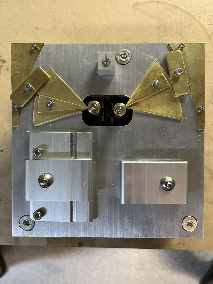

                    Escape view
                    The jig I built with the XY micrometers was not really for the initial setup, but were for adjusting the pallets in as controlled a manner as possible.  Not having Bernie’s golden screwdriver or intuition, there needed to be a way to capture the existing position of the pallet tip, and move it a known quantity.  The secret sauce of his design was the subtle tuning of recoil, and this gave a way to start knowing what changes were made, for better or worse.
                    The two brass rods protruding through the centre hole are each on a separate XY stage.  Each rod has a small vee machined down the side, which the pallet tip fits into. The rods have a generous hole through them so they can float a mm or so to snug against the tip.  The brass segment plates let you record the pallet angle, with the small holes at 0.5 degree increments for reference. The tips of said plates also rest in the same vee as the pallets. So, the pendulum frame is locked in place with the Al plates at the bottom, and the pallet positions “recorded”.  The pallet clamp plate can then be loosened, the X,Y or angle changed and then it’s re-tightened.  The pendulum goes back on the clock for further testing.
                    IMG_5003

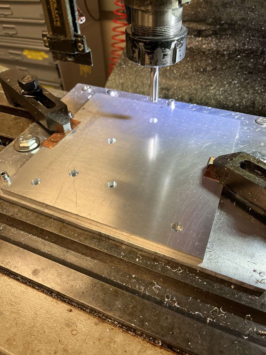

                    I’ve not been following this thread as well as I should have, but there were a few other questions earlier.
                    To make sure the holes on my plates lined up as well as possible, I had a jig clamped on the mill table with some bosses that the plate was pressed against before clamping them down.  This ensured that each plate was using the same datum.

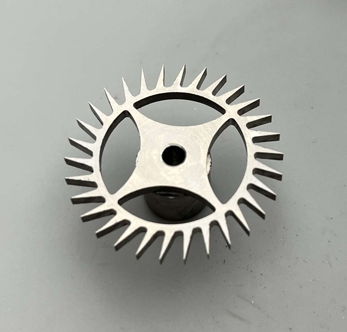

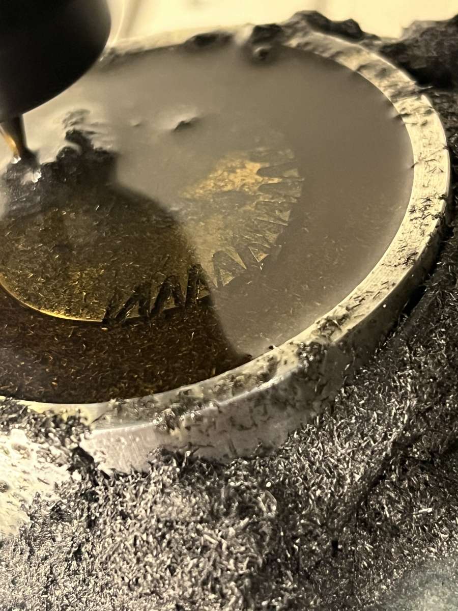

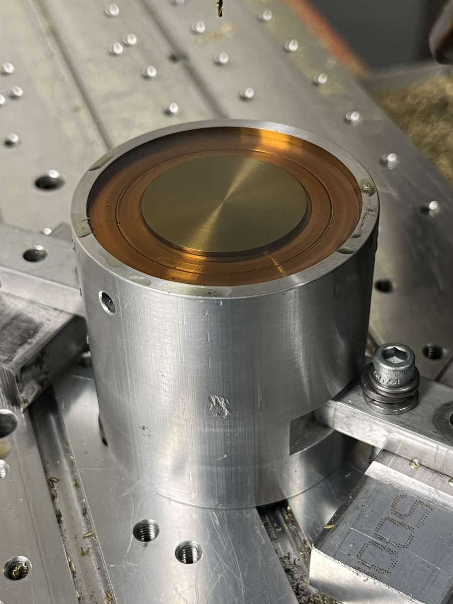

                    Also there was a question about making the Titanium escape wheel.  I used the profile cutting method on a Sherline Accupro.  The blank was turned first and then dropped into a holder which doubled as an oil bath.
                    IMG_5044
                    IMG_5050
                    IMG_5061

                        Steve, what cutter dia, DOC and feedrate did you use please when making the scape wheel?

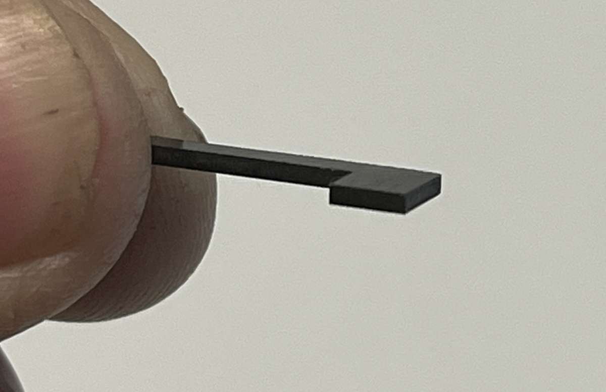

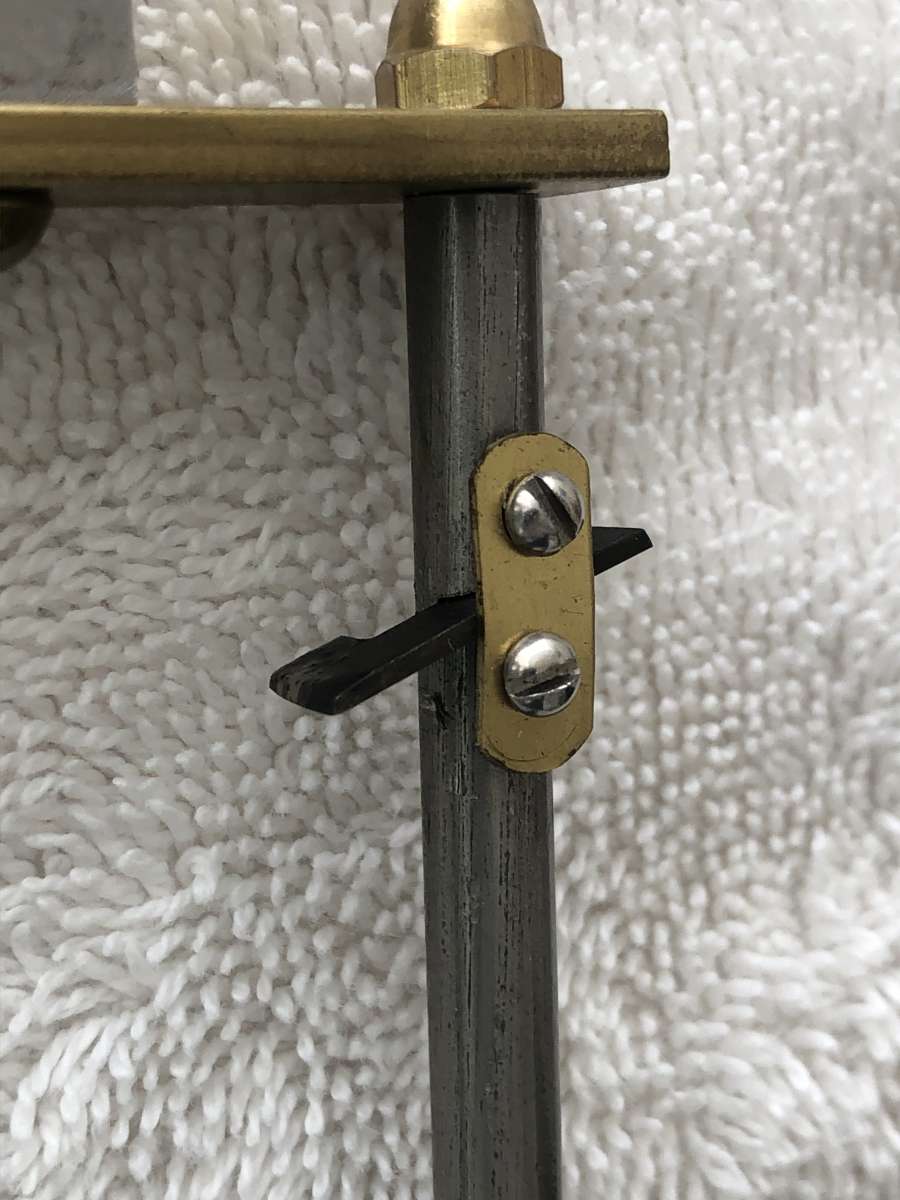

                          Are the slots in the side arms in order to bring the pallet ends close to centreline to avoid twist from the impulse? There seems to be room between the side arm and escape wheel to fit some sort of holder with screw adjustments to put the pallets on centre and avoid the slotting.

                            I think I recall a photo showing that the pallet “blades” are offset from the “stalks” to bring them on centre.

                              The cutter was a 1mm and I was able to run it in a single pass at 2mm/min feed, 2500 rpm.

                                Yes the pallets are “flag” shaped.  The first is from Bernie’s #7, and then our interpretation before grinding the impulse face.
                                Indeed there is space for some form of adjustment mount, but I imagine the slot was used by him to maintain his principle of design simplicity.
                                IMG_1360
                                IMG_4492

                                    Glad your train is done.  Before the Pendulum goes on, you should be able to hang a small weight on the barrel and have the escape wheel spin slowly.  Any tight spot will show up immediately.   Took me a long time to free everything up, but your machining is probably better!
                                    As for the pallet angle, I just scaled off the photo I showed earlier, but add here again. I just put a protractor on it.  I forget now what it actually was.
                                    Escape view

                                      Thanks Steve.  Very slow feed rate then, is this needed for titanium generally of is it because of the low spindle speed?  I like the way of fixturing the blank in an oil bath, did you have any trouble with chip build-up?  I have profiled 10-leaf pallets into the end of a piece of FC steel bar, then “releasing” them by parting off a slice.  IIRC I applied small amounts of cutting oil and blew the chips away with my usual blower.  Made 4 pinions, only broke one cutter!  Feedrate was 50mm/minute, 1mm slot drill, I think at 5000 rpm.

                                          The slow feed rate was due to the tiny cutter, longish reach and lowish speed.  The odds were stacked against me.
                                          The chip slurry did have to be flushed away periodically with fresh oil.
