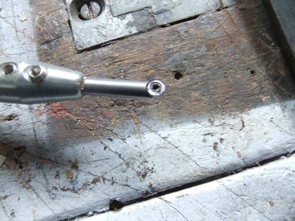

                              Out of luck I managed to get another look at the carbide tipped tool that I was so impressed with for roughing out wet timber (recently felled). This was fitted with the exact same 14mm square tungstan carbide bit with the same 6.4mm centre hole that I am using – it was held in place with an M4 machine screw, the max dia of the head was 7.1mm. Clearly this is enough as it is a well used tool (it was a bought tool £40 ish.) scew head just seems a bit on the small side with only a 0.35mm lip holding it all together!

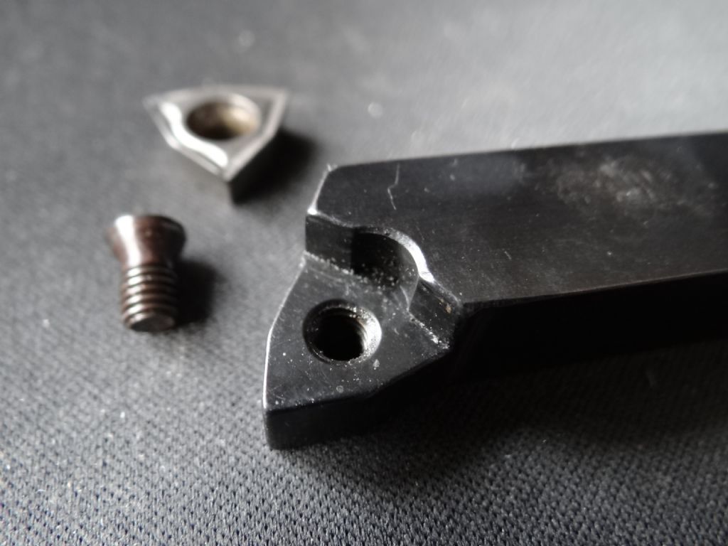

                                There may be more to strength in this application than the screw.
                                My example is a lathe tool where a carbide insert is held in place by a small screw, M2.5 I think. It's the biggest insert I use on my 1.5kW lathe, and it can take 2mm cuts out of mild steel:
                                Point is the screw doesn't take much strain because the insert and holder are shaped to take most of the forces:
                                The geometry and fit provides most of the strength, not the screw. The insert is firmly supported underneath against downward cutting forces and against rotational forces by the flanks. In neither case does much force go through the little screw, which would likely shear if it alone had to support the insert. The screw does little more than hold the insert in the correct position: the holder takes the force.
                                A wood-working chisel is likely made on the same principle, that is with the insert accurately fitted into a supportive recess. The strength comes from accurate fitting against properly designed shoulders, arranged so the screw isn't stressed much. Have a good look at a commercial chisel and copy how they support the insert.

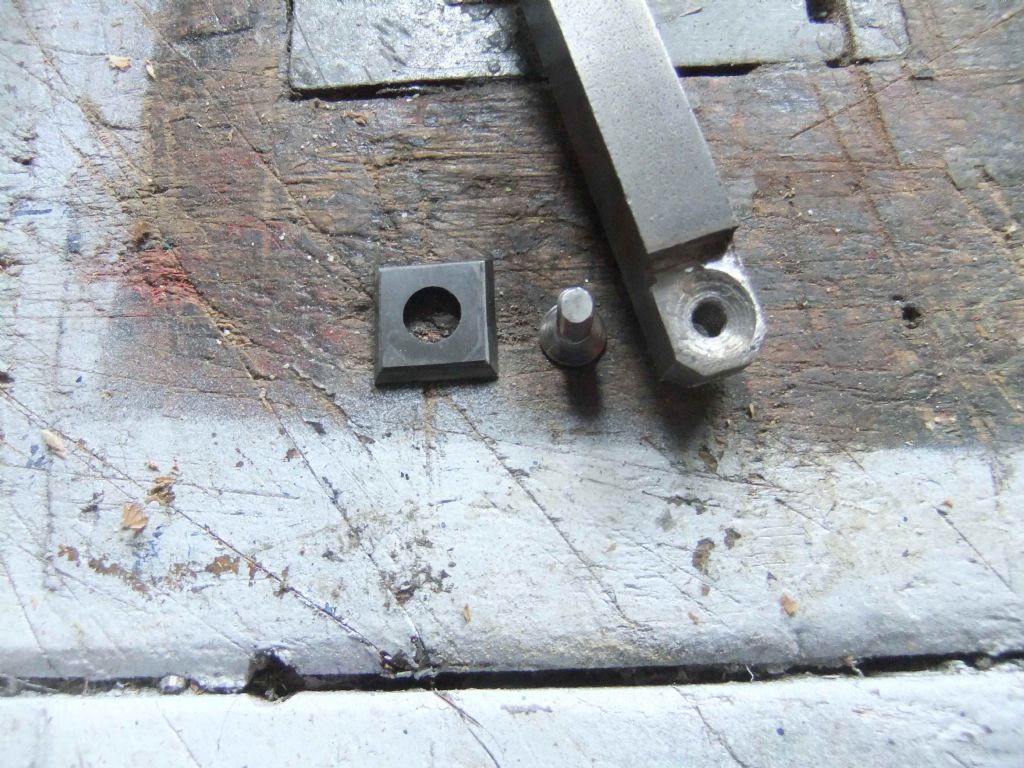

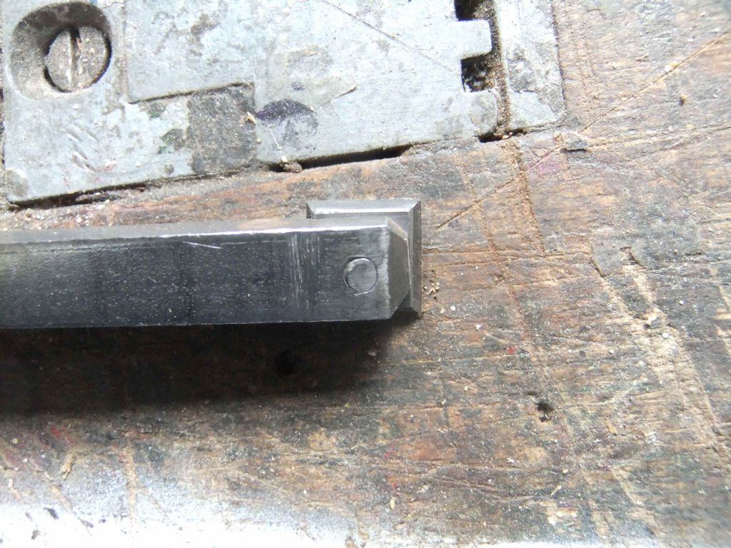

                                    I do own a set of carbide woodturning chisels which sit in the cupboard doing nothing( given to me) they have a 9mm square shaft and the screw from a very quick measurement is about 3mm. I think looking at them that the square one pictured below is not the correct tip fitted as the hole is way too big for the screw and it is only held in place by the countersunk part.
                                    As you can see there is as much metal either side of the screw hole so I would not want to put a 6mm screw into a 10mm square shaft

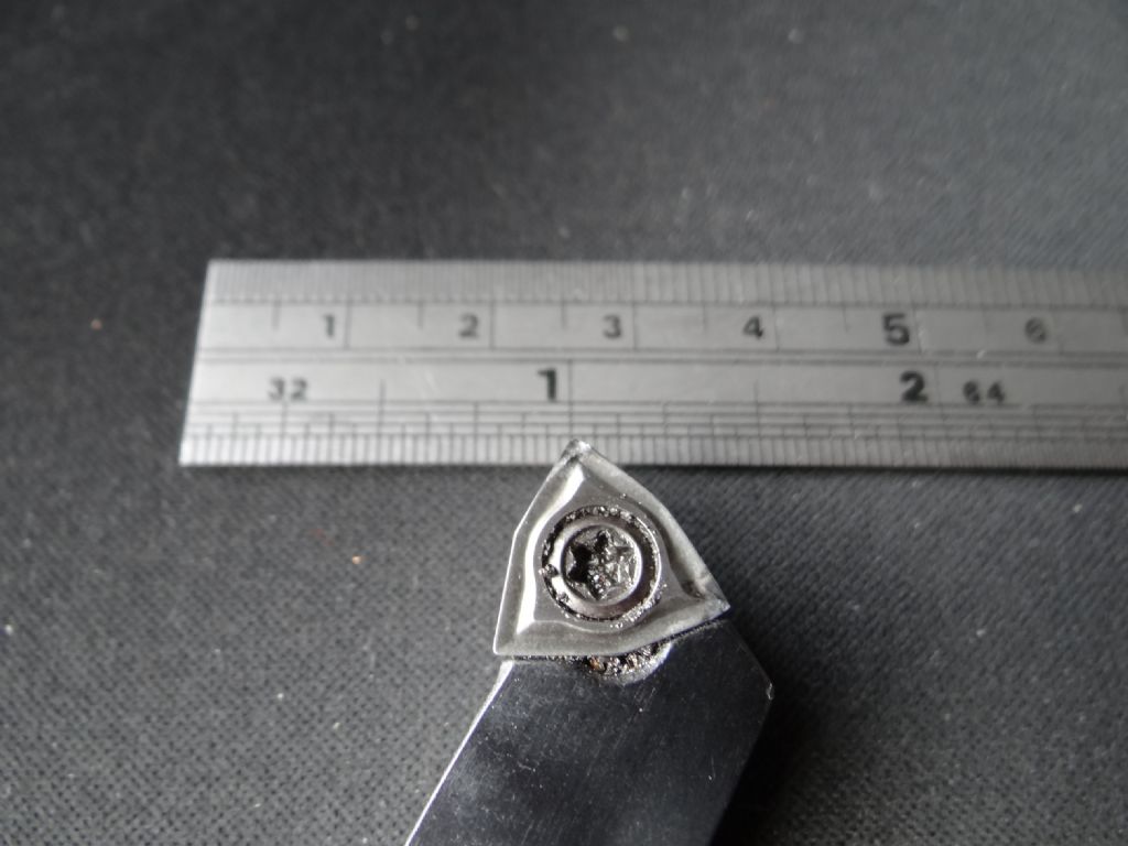

                                    I did try them when I first was given them but just can't get on with them. These only have a short shaft I would not use them in a deep bowl or deep hollow form as I could imagine that they would not take the forces put on them.
                                    This one which is a small tipped one is a much better quality tool the bit is about 6mm diameter

                                      So getting back to the topic of what size screw I should use in a 10mm Sq bar. I agree M6 seems too big, which leaves me two choices, either M5 that is only going to leave 2.5mm steel either side of screw but the countersunk is an excellent fit in the carbide bit. OR, , or go for M4, but that will leave the head of the screw only marginally bigger than the hole in the carbide bit.
                                      What would be best compromise?
                                      Im measuring the one in the second picture above as 3.5mm (if bar is 9mm)
