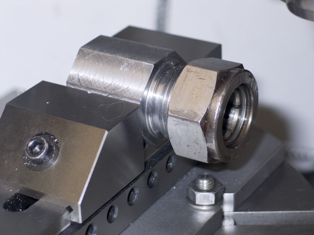

        Well I took the plunge and got a pair of Mr Stevenson's legendary blocks. These are accurately gound sections of hex or square bar now available with an ER25 fitting (the originals were ER32).
        After the initial shock (they didn't come in cnc-lettered, velvet lined walnut cases), just carboard boxes, I'm rather taken by the little fellas.
        I can see they are going to be a godsend for speeding up all sorts of simple indexing tasks, such as putting a square on the end of a rod or making hex nuts and screws. They could also be used for drilling handwheels etc.
        One good point is that the corners of the hex and square are ground with small but apparently accurate flats. This means that (although the vertical distance will change) you can index through 8 or 12 angles.
        One use could be as part of a grinding jig for shapening end mills etc.
        For most uses simple stops that allow teh block to be rotated and replaced accurately will be needed, a milling vice with an end stop will suffice a lot of the time.
        You have to fit your own closing nut, and of course I have just realised how useful it will be to have a nut especially for them so I can use cutters in my ER chuck at the same time!
        A good way to add value to the set of ER collets many of us have already.

              I have a pair of the ER32 jobbies and for most jobs, butting the end of the closing nut up to the vice jaws is all you need for quick indexing. Don't get too big headed John, but they are one of THE most usefull bits of milling kit i have come across.

                              I got fed up of waiting for an ER20 version and made my own blocks to take DA 180 collets of which I have full sets of both metric and imperial.
                              I changed the design so they have 8 and 12 sides respectively.
                              Phil

                                  My ER25 set is 35mm af and the machined portion is 42.5mm long plus a thread 17.5mm long thread if that helps, agree wholeheartedly regarding their usefulness.

                                      The nut overlaps the block so you can't use it flat on the bed of a mill, that is why lots of people hold them in a vice.

                                          If you bolt them flat to the bed to get repeatability to do all sides or some you will have to have register packing strips around the block or at least one side and end.
                                          So if you have to do this then just pack it up to clear the nut.
