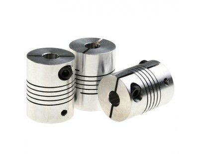

  • #470190
    Brian Abbott
      @brianabbott67793
      Does anyone know where I can get on of these in the uk?
      6.35 to 12mm
      Thanks.

                #470207
                Ketan Swali
                  @ketanswali79440
                  If you are converting something to CNC, they flex/bend and can sometimes bend/snap the leadscrew. They put a strain on the lead/ball screw, and sometimes also effect the fast movement of the X/Y axis. So for example if you are cutting/engraving a circle, at a certain point you may fail to get a perfect curve. If you are looking at a clock face, usually between 6pm and 9pm.
                  If you have alignment issues, better to look at oldam couplings, similar to this. These hold the position better. ARC will stop selling these after they are sold out becasue we stopped selling most things to do with CNC.

                    #470214
                    Ketan Swali
                      @ketanswali79440
                      Posted by Brian Abbott on 08/05/2020 20:34:56:
                      Hello Ketan.
                      I was hoping to use it to connect a stepper motor to my rotary table.
                      Then not a big deal. Most people use flexi coupling, but we stopped using them very early on. We still use the oldham type for the rotary table conversions we build, for quicker assembly, and still to get over alignment stress/strain issues.
                      Which ever way you decide is fine. Good Luck.

                              old mart
                                @oldmart
                                An Oldham coupling could suffer with backlash if it gets worn, but those springy one piece type will not. However, as Ketan says, the Oldham is easier to couple up as there are no grub screws to tighten up.

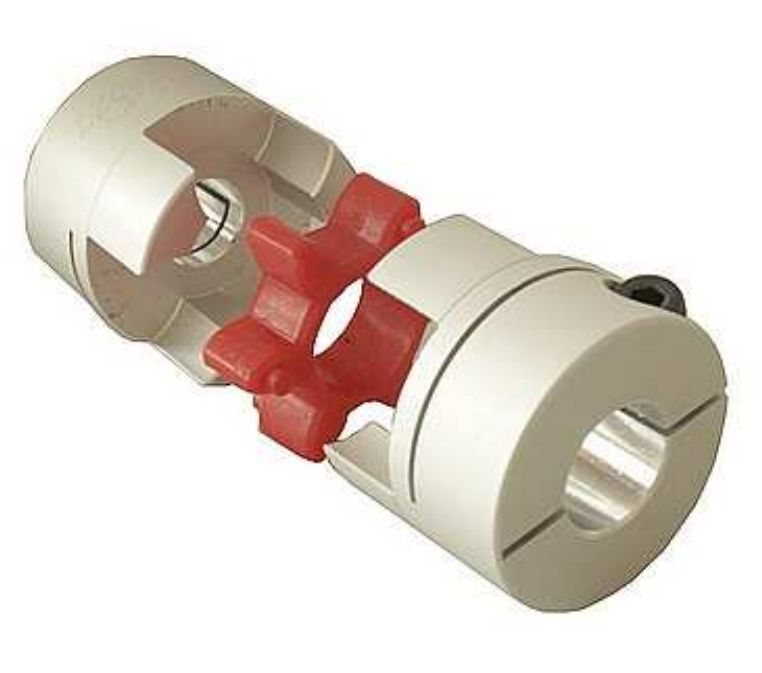

                                            I would not use the spiral cut solid type as a motor coupling. They were designed to drive low torque loads such as resolvers and tacho generators and were not particularly reliable when used as intended.
                                            A better solution is a jaw coupling with a backlash-free elastomer insert, like this kupplung3.jpg
                                            The clamp hub desgn is better than grub screws directly contacting the shaft (particularly if the shaft does not have a flat). This is the type of coupling that Denford originally employed on my Triac.
                                            Be aware that there are "general purpose" types of this coupling that do not have a backlash-free insert – all the backlash-free ones I have come across have a red insert & require a firm push to engage the two jaws over the insert. As with an Oldham coupling the motor can be removed leaving the ballscrew jaw in place – unlike an Oldham coupling the insert is not subject to wear.
                                            Nigel B.

                                                  mgnbuk
                                                    @mgnbuk
                                                    provided that you can be sure of axial alignment between motor and shaft.
                                                    The elastomeric insert is tolerant of small radial, axial and angular misalignments – at least it will not metal fatigue and break like the spiral cut aluminium type do if alignment is less than perfect.
                                                    Ketan,
                                                    As I said initially, my industrial Denford Triac came fitted with Rotex brand jaw couplings to join the small (1.85Nm) brushless servos to the ballscrews. The machine has obviously had a hard life in industry, yet the couplings, ballscrews & support bearings are all OK.. Maybe Denford's machining was better than Seig's, so there was less misalignment to accomodate ?  I have no doubts about the quality of Huco products – at my last employment we used their couplings almost exclusively to couple encoders to motors – but in the 27 years i was involved in retrofitting CNC systems to machine tools I didn't come across any instances of Oldham couplings being used with servomotors.
                                                    Nigel B.

                                                    #470586
                                                      Posted by mgnbuk on 10/05/2020 10:57:10:
                                                      Nigel B.
                                                      Sorry if I was not clear, Nigel … I was comparing the properties of your illustrated coupling with the Oldham one, not the spiral cut aluminium type.
                                                      Edit: ___ Incidentally, the spiral cut is [in my opinion] a poor substitute for the aluminium version that has a staggered series of ‘half cuts’.
