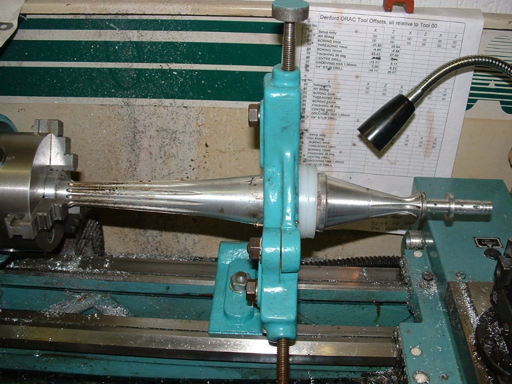

      I am renovating the pictured steady rest. What do people think about the relative merits of metal tips vs roller bearings , – if the latter where to get them ?.image.jpeg

            Capnahab, looks very much like a DSG steady you have there !. I've heard it said that roller bearing ones are more susceptible to chip ingress than your type.

              That looks very similar [but not exactly] like the one for my DSG 17t. The finger pads on my one are phosphor bronze [ I think ] certainly not brass. I prefer the solid type rather than the roller type especially if cutting very close to the fingers. Rollers are fine if they are kept away from the swarf. If im using the roller type on me other lathe then I always put a piece of card between the rollers and the cutting tool, so no swarf gets beside the rollers.

                I've just made a large dia. steady, used roller bearings (from Arc) , cheap enough not to worry to much about swarf. This for large dia. pipe and will be light cuts. It is my impression that solid fingers, clamped tight, are best for shaft turning and good finish, but you need a good finish first before using the solid fingers.

                  If you want to use roller bearings try Simply Bearings the web page is very good. You could use 2RS rubber shielded bearings to stop swarf ingress. Me I am happy with bronze pads I only use a steady a couple of times a year.

                      I believe the ingress that Roger referred to was the ingress of swarf between the bearing OD and the rotating work.
                      To ensure no marking on the work I clamp and turn a nylon collar to fit the work for the hardened steady fingers to run on. The clamping Jubilee clip has been removed in the picture below.

                        Emgee, your right, that's what I should have said !. Perhaps DSG thought the same by not fitting the steady with roller bearings.

                                    You can always add sealed ball bearings. They don't need to be big ones, they will only be taking side loads. I keep telling myself to get round to doing it to my boxford steady every time I use it especially on aluminium. Often it's just a case of drilling and reaming fixing holes in the fingers and making the "studs" to support them. The bearing size is set by where the fixing holes need to be in order to make the set up strong. I have used a steady on a very large lathe where this had been done with much smaller bearings than I would be inclined to use. The finger ends were well tapered to allow low diameters to be gripped. As small as they were the bearings still increased the minimum size that could be gripped.
                                    Some people modify the fingers so that they can take various tips – some plastics are favourite. I am not so keen on that method as it wont be as rigid as bearings.
