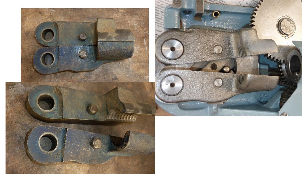

                                      half nuts.jpgHeres the half nuts on the south bend im restoring. On the right is the half nuts on another later south Bend which i have . They look very different , are they boxford or what???
                                      Thanks

                                      #206353
                                      Ady1
                                        @ady1
                                        If you can, learn to cut your own
                                        Even a temporary delrin nut can last long enough to cut a proper metal one
                                        I have been very impressed with the longevity of my T6 aluminium one (drummond owner)
                                        The nut TPI is a doddle since it's always a 1to1 cut
                                        If you're uneasy about doing it under power, crank the spindle by hand
                                        I skimmed my nut arm down to a few mm at the leadscrew thread part, then made an aluminium half nut which fitted into the skimmed out  part of the arm with a securing screw

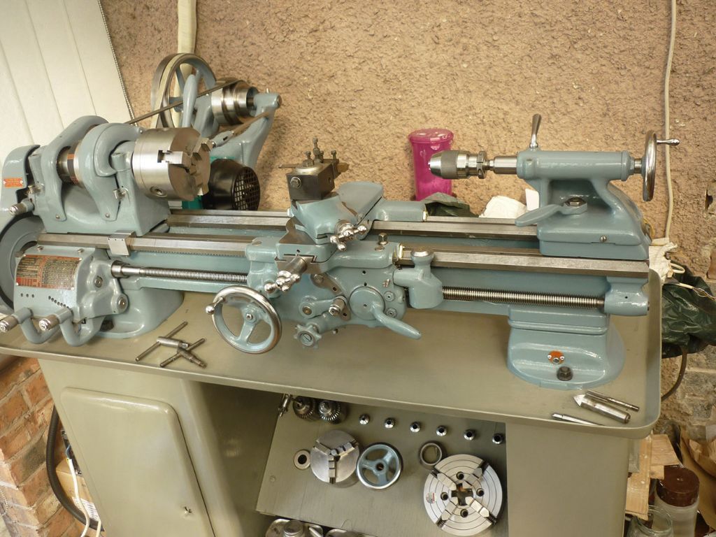

                                          Thanks i will have to become a bit more confident with threading as im just learning to use a metal lathe,after years of doing wood turning. I have a fully functional South Bend 9A (see photo)that ive recently finished restoring , so have the capability to do what your suggesting (at least the machine is not sure about me). These worn half nuts are off another im restoring..p1250865.jpg

                                          Boiler Bri
                                            @boilerbri
                                            nice job, can you fit mine in? lol
                                            #206373
                                            Ady1
                                              @ady1
                                              I did it so long ago that I cannot for the life of me remember how I did it either…
                                              Nowadays I would use a between centres boring bar and attach the arm to a milling slide
                                              Then fiddle and diddle about… lots of fiddling and diddling….
                                              Harder for you too because you have upper and lower threads which will need to be highly accurate to mate correctly
                                              My drummond has the lower half threaded and a smooth upper half surface so there's room for accomodating errors,(luckily for me!)
                                              Edited By Ady1 on 02/10/2015 16:35:12
                                              #206395
                                                Geoff Walker had an article on two ways to repair (the similarly arranged) Drummond M half-nut in MEW 221 that may be of help.
