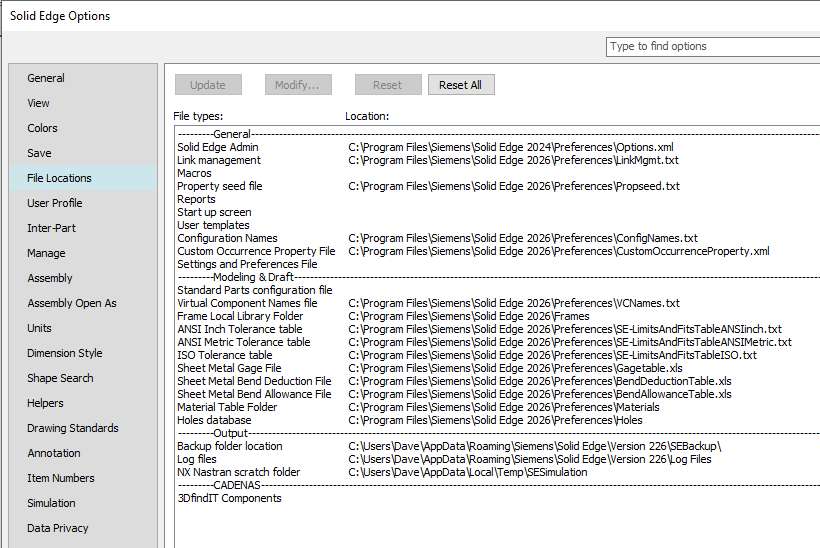

          I hit a few, nothing serious!
          • KeyShot and SE2024 both have to be uninstalled first.
          • Install is done from what might be a temporary directory that can be probably deleted to save space.  Need to check – can’t see it in the instructions.  Under investigation.
          • Siemens only support SE2026 on Windows10-Pro and Windows10 Enterprise, otherwise Windows11.   (I have W10-Pro, but support may cause trouble in future.  I’m good for 3 years though.)   I’d expect SE2026 to work on ordinary Windows 10 but can’t test it.  Anyone else?
          • Two error messages during start-up because an XML file can’t be opened.   Contains settings carried forward from SE2024.   Doesn’t stop SE working, and preferences were transferred, but getting past the popups needs a click.   Under investigation.
          • Performance seems a little sluggish compared with SE2024.  Tried increasing Virtual Memory page size as recommended in the Readme, no obvious improvement, but I only tested a small model.  (Microsoft page size was 4896Mb on my 32Gb computer: Siemens recommend 65526.)
          • Materials Table Folder and Holes database both missing.   Loaded correctly on my computer but not picked up by the install and added as preferences.  (Everything else was.)   Fixed in Settings->File Locations by browsing and clicking (last two entries in Modelling & Draft).
          SELocations
