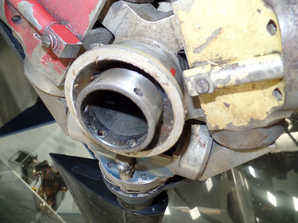

                          old mart
                            @oldmart
                            Mick, I have done that once or twice when producing a female thread when there was no alternative to trying for size on the mating thread. The last one was a nut of about 2 3/4" diameter to hold the head onto the gearbox shaft of a Brantley helicopter. This was to lift the aircraft. I have a picture of the hollow shaft, rotated the wrong way round taken before making the nut. I took the nut out of the chuck about three times before getting a good match.
