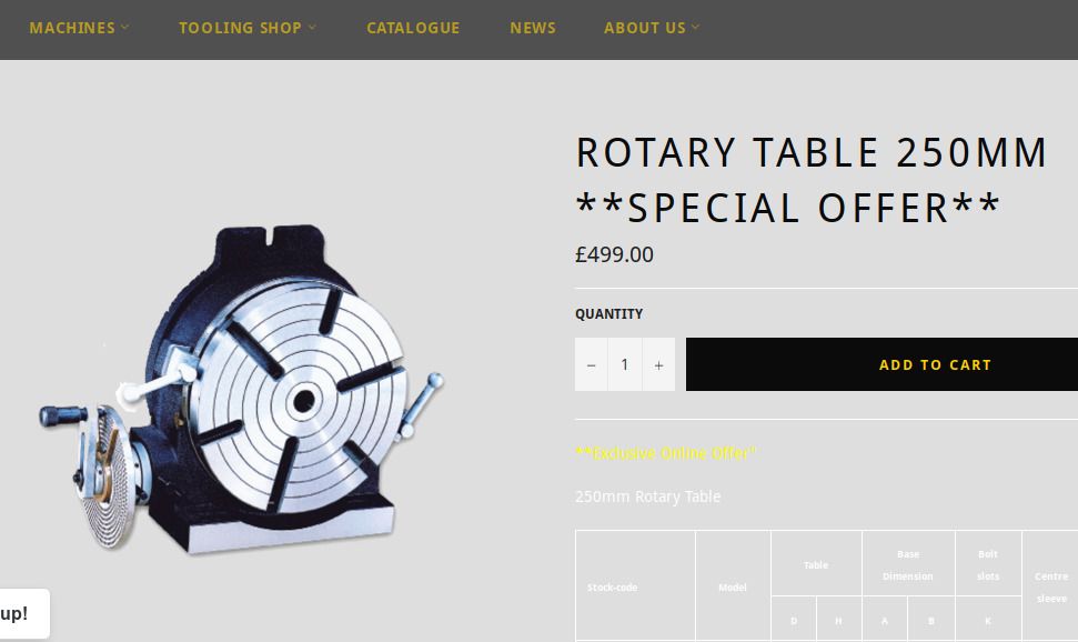

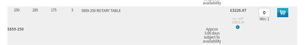

                    Special offer today at Chester:
                    And if that's not good enough, how about Cutwel's? (Only £3872.24!)
                    Just for laughs the VAT on the Bison is £645.37. That's very nearly enough to get you a £499 Chester and a £150 Warco…
                    I'm not sure there's much mileage in complaining about inexpensive tools – they are what they are. And no-one has to buy them.
                    How about complaining about the opposite case: why should hobbyists have to pay £3872.24 just to get a decent rotary table? It's a scandal!
                    devil
                    It's not about chasing tenths of thou's. It's about the failure to meet the basics claimed for the product. One would expect a collet chuck designed to fit a Myford spindle would actually be able to be screwed on and not be too small. It's not unreasonable for the customer to expect the product to actually do that simple thing.
