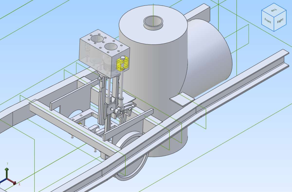

      I’ve been warming my hands over the computer instead, designing my Hindley steam-wagon engine.
      And today found an on-line photo of the Vincent-built, full-size replica showing the driver’s side of the cab – or where that would be if it had one. Hardy folk, were drivers in the 1900s! Horses don’t have rooves so why should horseless-carriages?
      This photo revealed the proportions I thought all horribly wrong may not be so serious after all. Besides, I’d forgotten the platform’s head-board partially hides the back of the engine!
      This morning I braved the cold and measured my real chassis with boiler in it.
      Hence could give the CAD equivalent of the chassis a block outline of the boiler and the partial-engine assembly “fitted” with two temporary suspension-plates, and it does nearly resemble the tracing of the full-size version photograph. The engine does lean slightly forwards in the chassis.
      It needs some tweaking, and I am sure Constraints belong to some strange and very exclusive secret society so that when I add a new one to a complicated assembly a dozen previous ones scattered randomly around it go on strike.
      I’ve produced a drawing of the part-assembled engine, implanted in the chassis assembly as a sub-assembly, and it contains assorted peculiar dimensions and mis-alignments all to be traced and corrected.
      Some components are depicted in provisional form, for refining as I develop the CAD model.
      Roark’s text-book about Stress and Strain is really about those in metal objects, but I hate to think what of his mid-boggling formulae would apply to me in managing to concoct this:
      Screenshot 2025-12-31 194240
      Oh look, I’ve gone and put the cylinders the wrong way round! The LP one should be on the nearside. Not that it matters here because the miniature will be simple-expansive working, with only the two top covers indicating the original being a compound. I will need correct the engine-model assembly.

          There is a strange thing though. The engine image in the chassis won’t animate but its own assembly can be pulled round by the flywheel.
          To examine the valve events I made some parts translucent and “drilled” two tiny holes through the connecting-rod so they show as dots I can align by eye with a central plane when the engine is viewed directly on end. I measured the distance from the crosshead to the cylinder cover at dead-centre, but noticed the stroke seemed the wrong length.

          #830743
          David Jupp
            @davidjupp51506
            Nigel,
            To get the engine to animate in the main assembly, you have to set ‘make flexible’ for the engine sub-assembly.
            Only use make flexible when needed as doing so adds in all the assembly constraints from the sub-assembly to those in the main assembly.

                  I am not so worried about being to revolve the engine in the chassis model, but there is something peculiar about its own assembly. I may try a stripped-down copy to see if that reveals what’s happening.

                    Measurement problem identified…
                    By the Inspect > Measure tool, the model gave stroke lengths over 2″ from a crank throw of exactly 1″, slightly different on every re-test.
                    Yet all the Part Dimensions, Anchors etc., were correct.
                    Well away from the computer, out shopping in fact, I had a sudden Mornington Crescent moment:
                    “The two edges are parallel but at different depths “into” the screen, so I must be measuring invisible diagonals!”
                    Indeed, when I measured between the parallel surfaces, all became present and correct.
