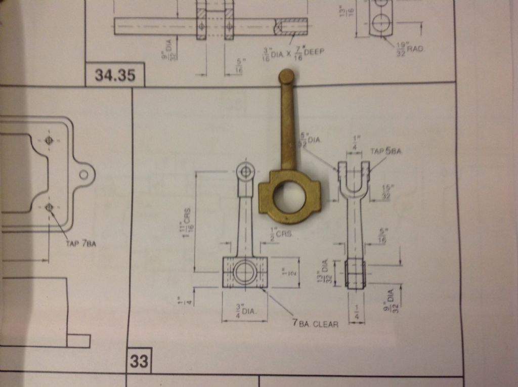

      I'm getting on with my Stuart 10V, and finding Andrew Smiths book invaluable. However the detail on the Conrod is a bit thin. His instructions are to "cut through the middle, either with a miniature hacksaw or a circular slitting saw". A google hunt for a miniature hacksaw throws up nothing helpful, so time to have a go with a slitting saw which is something new to me. I'm planing to use my SX2 mill, and plan to buy an R8 arbour that will hold a range of centres from 1/2" to 1" . My thinking is that this will be nice and rigid. Some advice on the following would be welcome:
      I'm planning to buy a 3" 1/32" thick saw , or is it better to use the smallest diameter I can get away with?
      should I saw the Conrod from the face or the edge?
      fine or coarse teeth?
      is there such a thing as a miniature hacksaw?
      Thanks in advance.

          Thats the valve rod casting!!
          By minature hacksaw he probably means a junior hacksaw which would give a narrower kerf than a standard hacksaw.
          The thinner slitting saw blades can wander a bit if you are not careful, run them at your mills slowest speed and use some cutting fluid even with bronze.
          I would cut it from te end but have the teeth in contact come across the work at about 45degrees, much the same as this

                I'v got a power hacksaw that is powered by a small Stirling Engine, It uses junior hacksaw blades, and has been used to split big ends. It does a lovely job, your big end would take about 15 min, but that's not bad on a bit over 5 Watts. Ian S CRoss Yoke motor

                  I tried one of those multisize slitting saw arbors in a R8 taper: basically useless as it didn't hold the saw anything like concentric or perpendicular to the axis. It went in the bin.
                  Even thick saws (>1/16" ) are prone to go walkies with any depth of cut on a single ended arbor. So I'd use the smallest diameter saw possible. I'd also go for coarse teeth. Fine tooth saws are ok for slotting screw heads but not much use for anything else, as the gullets get clogged.
                  If at all possible I use slitting saws on the horizontal mill. That's what I call rigid wink 2 and I'll happily take cuts up to 15mm deep in one pass.
                  For the job in hand I'd use a junior hacksaw.

                    The design should leave lots of spare metal for a junior hacksaw cut. Just make sure you are using the correct casting

                        Put the casting in a good vice or use packing with the line to be cut just proud of the jaws and then saw using the vice jaws or packing to keep your saw straight ie saw with the blade in touch with the jaws

                            I'm with Andrew on these arbors, there isn't enough support to do a proper job.
                            I know is using tools to make tools but a decent home made arbor is not that much rocket science. Also make a series of support washers of different diameters.
                            You only need enough saw showing to do the job, if the rest is sandwiched between two decent washers it supports the saw and helps get a straight cut.

                                      FWIW I cut the eccentric strap for my 10V with a junior hacksaw as the only slitting saw I had at the time was 1/16" thick. There is plenty of metal for cleaning up the cut surfaces, even if a thin slitting saw wanders a bit.

                                                  You should not have a problem with slitting saws, i use all sizes down to 1/64" its the same as useing a hacksaw dont force it let it cut itself and you wont have any trouble. You need to drill the bolt holes first then saw all the way through bolt it back together and then bore the hole to fit crank.
