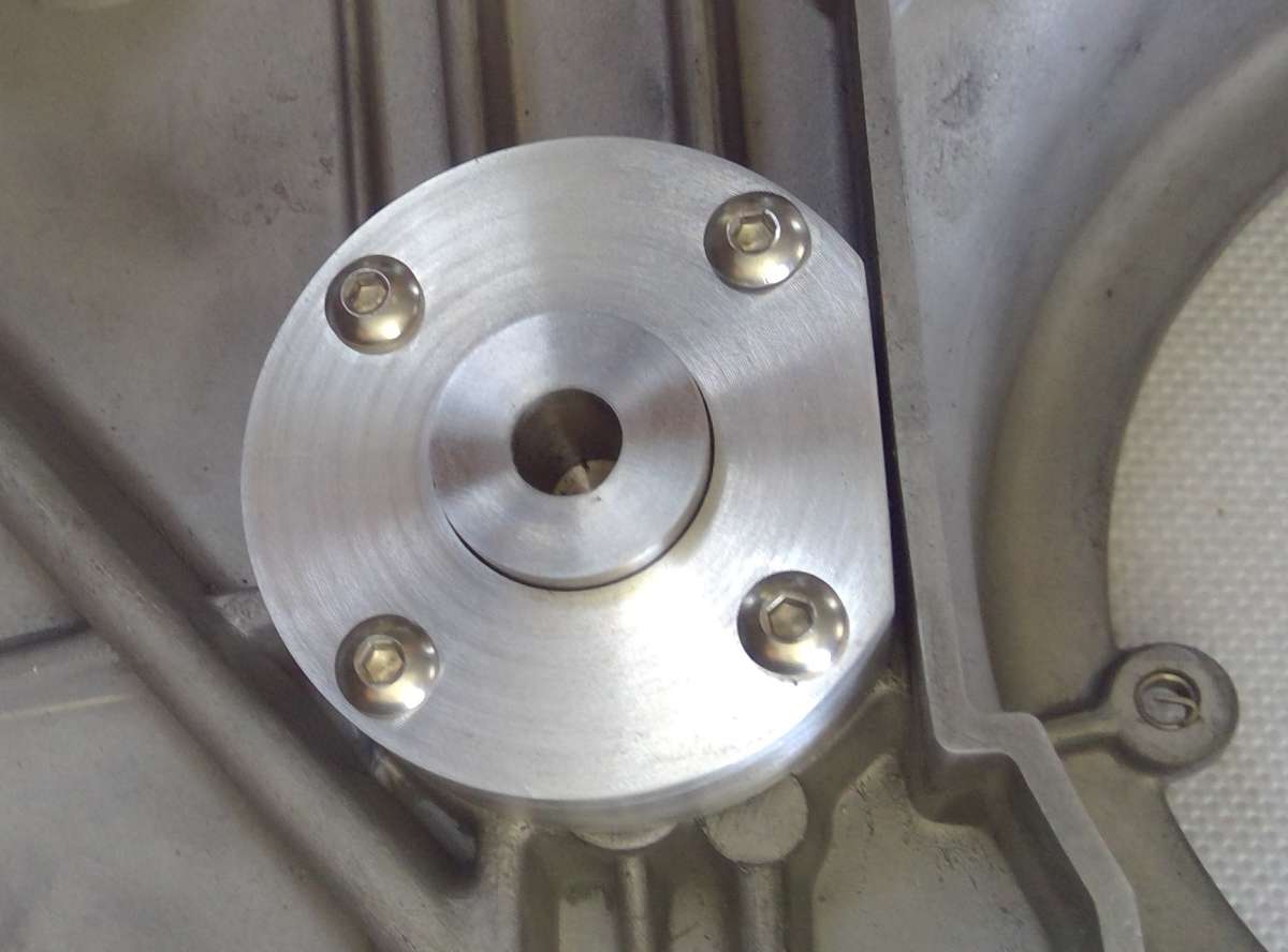

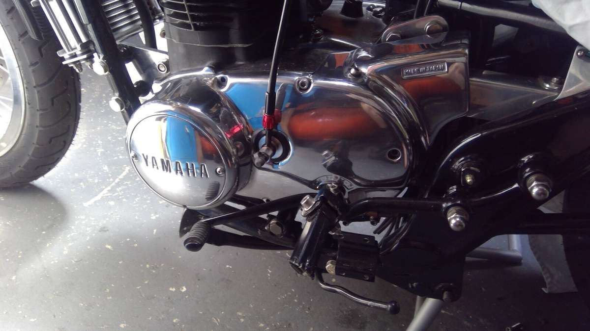

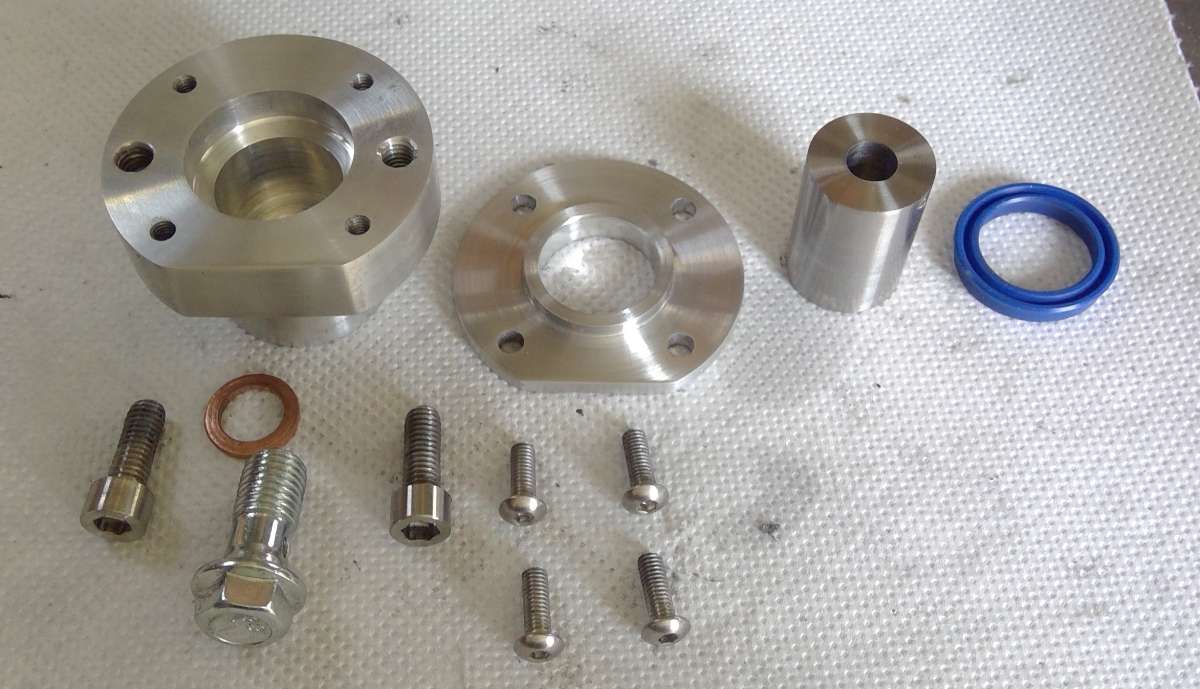

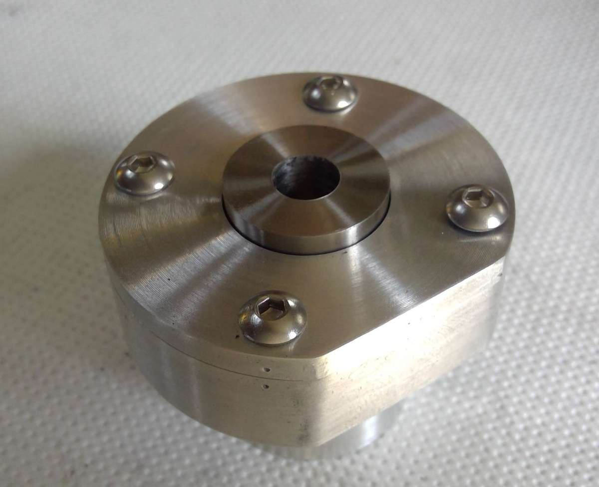

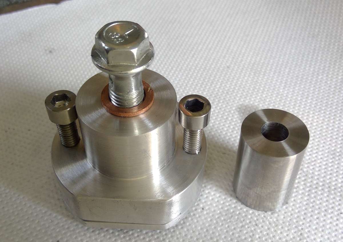

      I made this slave cylinder to convert the cable operated clutch to hydraulic.  Body is 6061, Piston is stainless, seal is a hydraulic ram seal.  Due to limited room behind the cover i couldn’t fit a circlip and a dust seal, so I machined up an aluminium cover that serves a dual purpose.  To fit, I had to bore out the cover a little where the original screw actuator fitted, and drill the M5 threads out with a 6mm drill.
      Bore is 22mm, piston only has to move a mm or two.  I designed it to fit behind the side cover to make it as unobtrusive as possible.WIN_20240303_11_36_25_ProWIN_20240303_11_15_24_ProWIN_20240303_11_19_45_ProWIN_20240303_11_28_26_ProWIN_20240216_14_04_02_Pro

        Good job. Fitted well.  But I did wonder what it was for until I got to the last picture.
