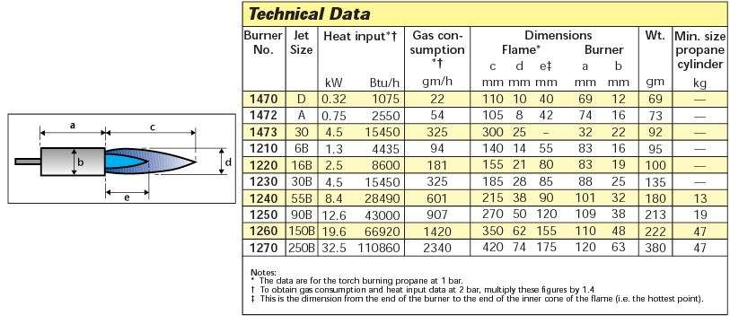

                                            For interest, here is a data sheet for Bullfinch burners. I soldered my 1 1/2″ Allchin boiler with just a 1240 burner. For 5″g loco boilers I added a 1250. In all cases the gas pressure, and hence heat output would be well  above the figures listed. Bullfinch burners
                                            I’d point out that neck tubes are neccessary with the larger boilers and burners if only to keep one’s hands and face away from the glowing mass of copper.
