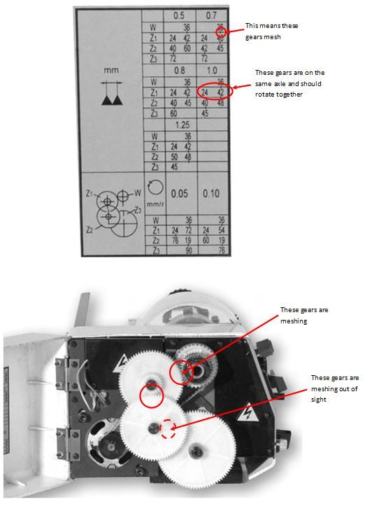

                          Hi, I'm new here. I own an Axminster Sieg C1 Micro Lathe, which I bought a couple of months ago on ebay used for £210, and I am currently collecting all the tools and accessories for it I can find, as it literally came with nothing but the tool post and a dead centre in the tailstock…It didn't even have a clutch selector knob fitted! (Luckily I was able to get a new one from Arc Euro Trading).
                          I would like to be able to cut threads with it that are larger than possible with a floating tailstock die or tap holder set. ( I have an MT1 set on the way which comes with three different size die holders) That would of course require a change gear set.
                          In researching C1 change gears I discovered they are available individually from Ar Euro Trading but at about £8.35 each, inc VAT, so they are too expensive for me right now.
                          The C1 manual shows a total of seven change gears but the change gear table diagram, on page 23 of the manual, makes absolutely no sense at all to me…I can't work out which ones to use or in what combination from looking at the table.
                          I subsequently discovered that I can get a change gear set for the C1 on (Deleted see CofC) with a nine gears, for under £25 too. But as the table only covers up to the standard seven change gears, even if I could make head or tail of it I would still have two gears that would not be on it the table!
                          Any help making sense of the change gear diagram would be much appreciated.
                          Alf.
                            The illustration from the manual shows the gear train set up for fine feed of 0.05 mm/rev. There is a means of adjusting the position of Z1 and Z2 to obtain the correct gear meshing, item 79 support plate, usually referred to as a banjo due to its shape on a lot of lathes.
                            Martin C

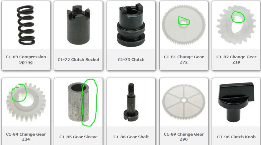

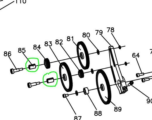

                                I 've also got a problem with the threading gears as well the table , see above , states when going for the 1.0 metric thread that gears 40 and 48 are connected on the same axle HOW? thes are lose gears so the 48 will be driven by the 42 gear but the 40 will not since they are not connected? can any one explain The manual cant and I couldn't find special bolts etc on internet . grtz from Holland Willem
                                #607854
                                  I thought that the pairs of gears fit onto sleeves that have a key which fits the keyway in the gears so that they rotate as one.
                                  Edited By JasonB on 30/07/2022 07:04:06
