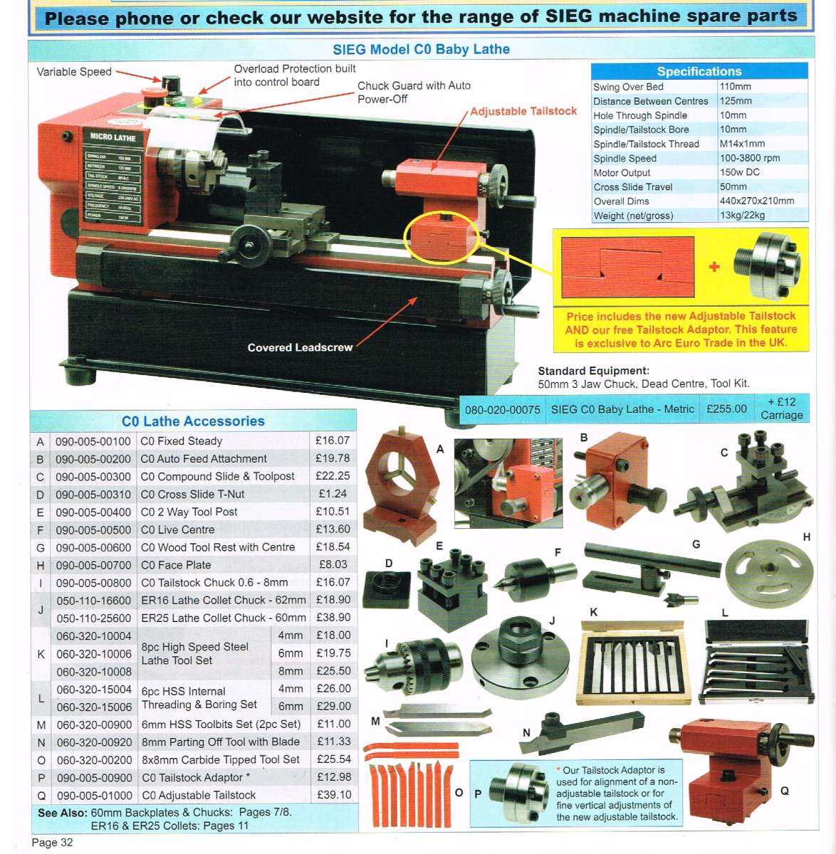

                              Hi, the last catalogue that Arc had the C0 lathe, and accessories was No. 9, which shows both the screw on chuck and the push in tailstock centre.
                              Scan_20251030
                              Regards Nick.
                              #822332
                                The C0 catalogue page posted by Nicolas is an excellent steer!   Few observations:
                                A is a Fixed Steady, used to support work that sticks out further from the chuck (or collet) more than, say, 3x diameter. Not needed if you never turn long objects!  Valuable if you do.  Not shown is a travelling steady, which moves with the tool-post supporting the work close to the cutter.  I find a travelling steady more useful.
                                F is a a Live Centre, used to support the end of long objects.  The point sits in a dimple, made with a centre-drill.   Both worth owning.
                                G is a hand-rest, useful for turning wood and graving.  Graving is a clockmaker technique.   Otherwise rarely needed.
                                H is a faceplate.  Used to hold work too big for a chuck, and work that’s positioned off-centre.  Needs nuts, bolts and clamps.  Rarely use mine, but good to have when needed.
                                J collet chucks.  Collets are an alternative to a 3 or 4  jaw chuck.  A collet set is needed   They allow accurate quick change resetting, which is handy for certain jobs.   3-jaw chucks are quick, but don’t reset accurately.  Expensive 3-jaws do better, but…  4-jaw chucks can be reset accurately, but need a DTI and stand, and resetting is slow.  If only one was allowed, it’s the 4-jaw.  With practice they can be set up fairly quickly.   Lots of practice!
                                K is a set of HSS cutters.   Folk who know what they’re doing don’t buy them because not all the tools are useful.   But they suit beginners very well – learn by trying them.  A grinder with a grey wheel is needed to sharpen them.  You might prefer carbide inserts isntead.
                                N Parting-Off is difficult on small lathes, so you might prefer to hacksaw and face-off.
                                O is a set of carbide cutters.  One booby trap is they may be supplied unsharpened.   A grinder with a Green wheel is needed.  I don’t find them useful.   I’m 80-90% carbide inserts, supplemented by HSS.  The combination covers most requirements.
                                Buy some books.   Sparey’s “The Amateur’s Lathe” is excellent, and others recommend South Bend’s “How to Run a Lathe”.   The Workshop Practice Series has many good booklets.  Also read the magazine!  The articles often cover methods and materials.
