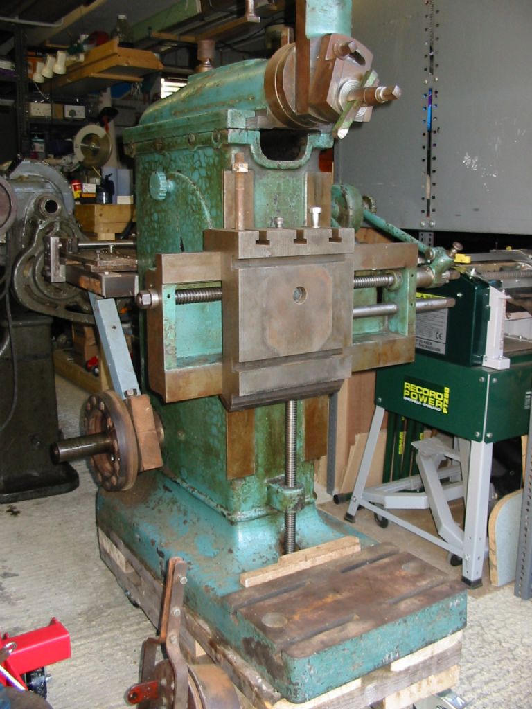

                        Strip-down nearing completion & photos in my album; here are some samples:-
                        1. As seen & working
                        Shaper as seen 1

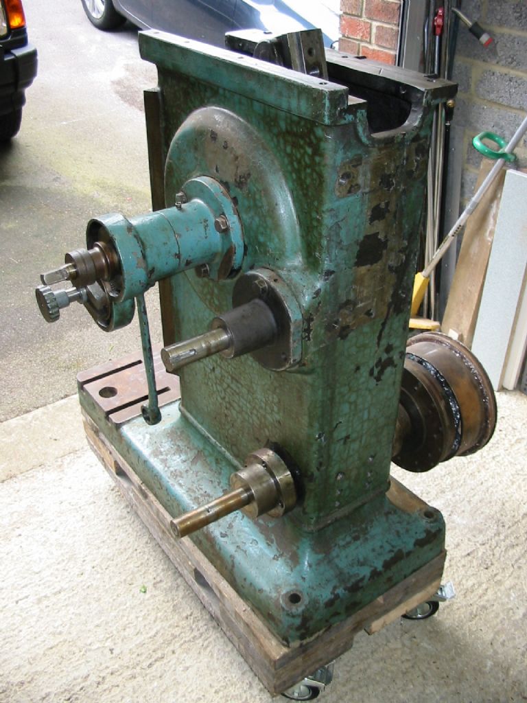

                        3. Fuller strip, LH (clutch opened up; the metre rule is indicating 38" to ram base)
                        Strip stage 1, drive side
                        4. Fuller strip, RH:
                        Strip 1, transfer side
                        Things I have discovered so far:- Still no clue to maker. Original colour seesm to have been a light grey – see area behind vice table. Some blowholes in the main casting (none critical). Most theoretically symmetrical mating parts stamped with number (always 1) & do not fit well 180 deg out; poorly-aligned (Whit) boltholes discourage "alternative" fitting. Clutch driving member is an offset, internally coned, spoked, flat belt pulley, now modified with the addition of a plywood, v-belt circumference, outer face bolted through the spokes. The mating driven member is hardwood lined & fixed to the cross-shaft, with separate bronze-bushed bearing housings either side of the main body. From the RHS, drive is taken upwards to the pinion shaft, which is steel running directly in a separate iron housing. Of the 2 flat-belt, 4-step pulleys that came with the m/c but were not fitted, one fits well but the other will not slide fully along the smaller of the 2 shafts – it has a curious lacquer-like finish to the bore that has started to tear with my efforts to test fit it – and there is no obvious way of keying it to the shaft. These pulleys are of slightly different size/weight and the bores are slightly different (not the originals (?)). I intend to fully dismantle the m/c to check the bearings & gear tooth wear and the next step is to invert it to separate the base & main castings and gain access to the bearing at the bottom of the operating arm. I should also apologise for the use of any incorrect terminology as I'm making the part names up as I go along……
                        My latest thoughts:- 1. Forget about flat-belt drive. 2. Re-con the clutch & fabricate from steel an improved lever operating system. 3. Using the as-supplied motor platform, I estimate v-belt primary drive would be over about 70 cm, with about 8mm of axial motion for clutch operation. Similarly on the other side, re-instate the later v-belt drive to the pinion shaft, junking the 4-step pulleys. 4. Deep breath, install new 3-phase motor & matched inverter.

                        1. Should I consider modifying the pinion drive housing & make a bronze bush? The shaft surface isn't great, so a light clean-up, bore the housing and turn up a bush seems like a "proper" solution. There again, it's lasted 75 years or more as it is…
                        2. Between what appears to be cellulose filler under the coats of paint and the iron is a thick-ish shellac-like black layer that isn't susceptible to paint stripper; any ideas?
                        3. Reference previous discussions: I've gone off the idea of direct drive from motor to pinion shaft with electric "clutching" as too experimental for my situation & capabilities. However, are we in agreement about the layout described in my latest thoughts above?
                        4. And, of course, any suggestions on parentage would be welcome; we have Butler as a starter for 10…

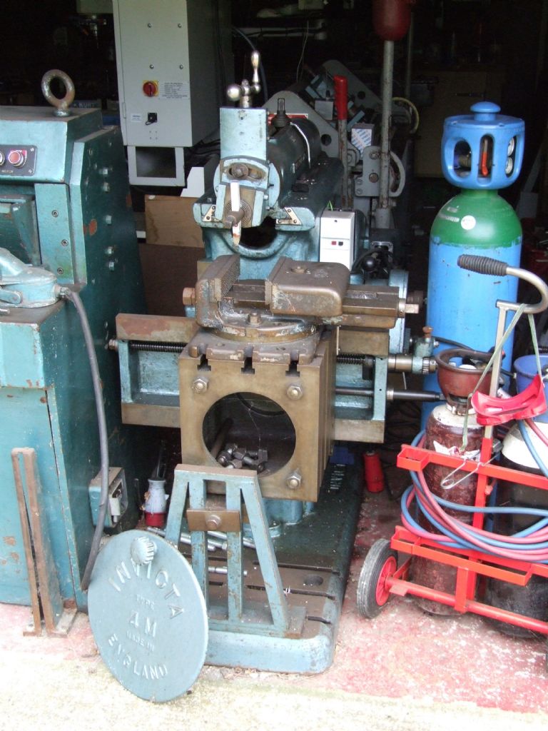

                                Hmmmm, there seem to be some features that are remarkably similar to my Invicta shaper. These include the circular opening, the circular cover and knurled knob on same. The arrangement of the cross slide and table mount, and the four bolts used to hold the table, and the front of the base. The clapper box and rotating slide on the ram also look familiar.
                                If it would help I can post a picture of my shaper for reference.

                                  Andrew: yes, please. I have seen a number of similarities with other makes on the NEMES shaper group website, although never enough in the same machine to be convincing. Worth a look for its single-interest focus.

                                    Here's a picture of my shaper:
                                    Invicta Shaper
                                    In has the name 'Invicta' cast on the side panel as well as in the base. It's a 4M, which translates as 18". Sadly it's a broken at the moment as the main drive crank casting is broken, due to a combination of poor design and poor casting. I have a repair scheme sketched out; it's just a case of convincing myself I need to keep the shaper and then finding the time to repair it. Getting the broken crank casting out is going to be a challenge too.
                                    Regards,
                                    Andrew

                                      I looked at Invictas during my previous investigation but came to the conclusion that the ram sliding arrangements are different, and generally manufacturers tended to stick to one system or the other. Your Invicta has dovetails, and the unknown one hasn't…
                                      I did come across one other un-named machine whilst looking, and although it's similar, there are too many major discrepancies. And that one is still un-named, so not much help either!
                                      One way or another, I think that this may be a little bit of history that is receding from us and vanishing into the distance without proper recording, which is a shame. I get the impression that there are quite a few shaper manufacturers who aren't on Tony's list – and all credit to him, it's the best list there is on the planet. We should help him fill in the gaps whilst somebody still can.

                                        There is quite a lot of it that looks like a family resemblance to the 14 and 18 in Alba shapers. (Both of which I have.) The shape of the base…although the Albas have three slots in the supplementary table at the front, the two gears for the fine feed in a sort of figure 8 shaped case, the ram and the downfeed…there are lots of bits that look like pure Alba. But that shaft at the lower back looks like nothing I have ever seen before. I dunno…if it is not an Alba maybe it is a copy of one with a few changes here and there.
                                        The Alba was the forerunner of the Elliot. My 14 inch has a flat belt drive with a pair of four step pulleys, a countershaft and a fast and loose pulley. It is not yet set up to work. The 18 inch has a probably later arrangement with a four speed gearbox on the back, a clutch, and a motor added on the back of the machine.
                                        I'd say that a VFD is really overkill for a shaper, speed is not usually all that critical, but on the other hand it is a convenient way of getting a three phase motor to run on the usual domestic supply.
                                        I've got the ten inch Alba as well, but that is a quite different design. I also have an AMMCO 6 inch shaper, an American machine.

                                          Had a quick look at the rest of the pictures, and bearing in mind that it is a 12 inch machine, I think it is certainly an Alba. There is just too much in common with my machines for it to be anything else. How about posting it over to me to round out my collection…then all I will need is the 16 inch version which I think they also made.
