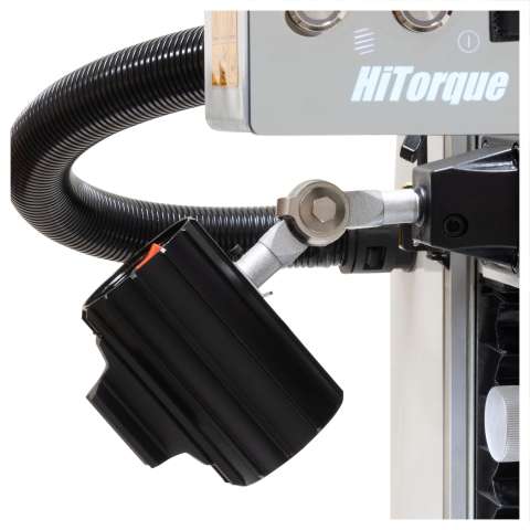

      The LED light is part of (supplied with) the machine Robert. I don’t have a good photo of it – it’s black anodised, so doesn’t really stand out. This lamp on a similar Seig machine appears to be the same though (photo from Little Machine Shop’s website in the US).

            As Robert has said ” it depends on the light.” Though by providing the radio with a better aerial may work and worth a try.  Change to a 12V halogen bulb and a simple transformer set up will cure it. Far less efficient and it gets hot. Noel.

                  The construction of the work light precludes easy fixes like clip-on ferrites. Some disassembly required.

                    If I can access the cable inside the column and place the choke there, will that be near enough, or does it have to be right by the lamp itself?
                    Regards,
                    IanT
                    #815721
                    Robert Atkinson 2
                      @robertatkinson2
                      You can try inside the column. Depends if the source of the noise is the power supply or the LED head.
                      What radio has the problem AM/MW or FM/VHF?
                      Robert.
