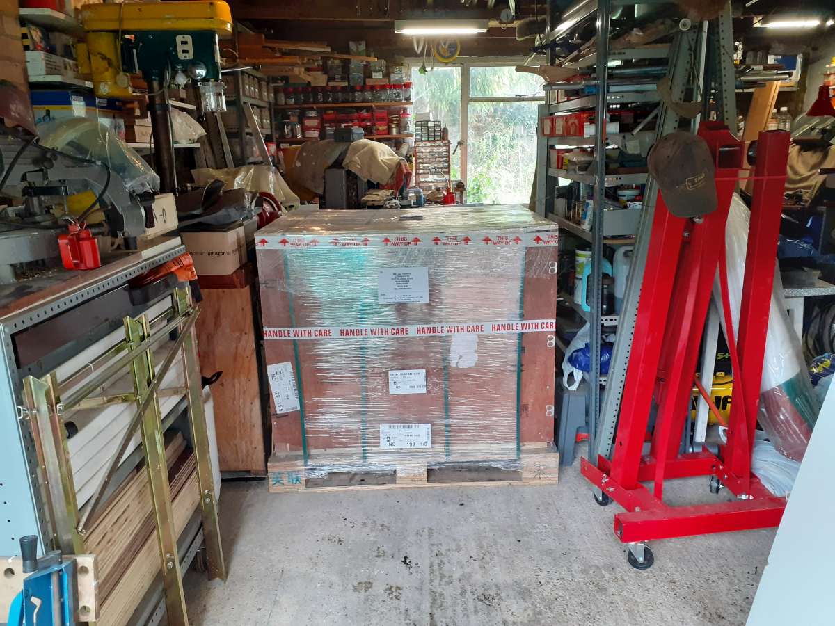

                    #810237
                    IanT
                      @iant
                      Just to footnote this thread.
                      I called ARC and spoke to Ian who was very helpful in explaining the history of the machine and the issues (which turned out to be minor – mostly cosmetic). As ARC is some distance away, photos and a video were provided a few days later and a sale then agreed.
                      In fact, after our conversation, Ian decided to change the power feed unit (where had the paint ‘chipping’ had occured) for a new unit, so in fact the machine is now pristine. The toolkit is missing some items but replacements have been ordered with Seig and will ship to me when they arrive in UK. As this was the machine I really wanted, I’m delighted that things have worked out OK.
                      I was therefore very pleased to receive a large palleted crate (via tail-lift truck) yesterday morning. The crate only just fitted into the space I’d cleared for it and I will spend the weekend figuring out how to lift the pallet to get my (new) 2t engine hoist’s legs under it. I should have had the good sense to think of this and ask if the pallet trolley could lift it high enough to get some packing underneath. However, I now have a cunning plan and will proceed with care, as it’s quite a lump to handle!  🙂

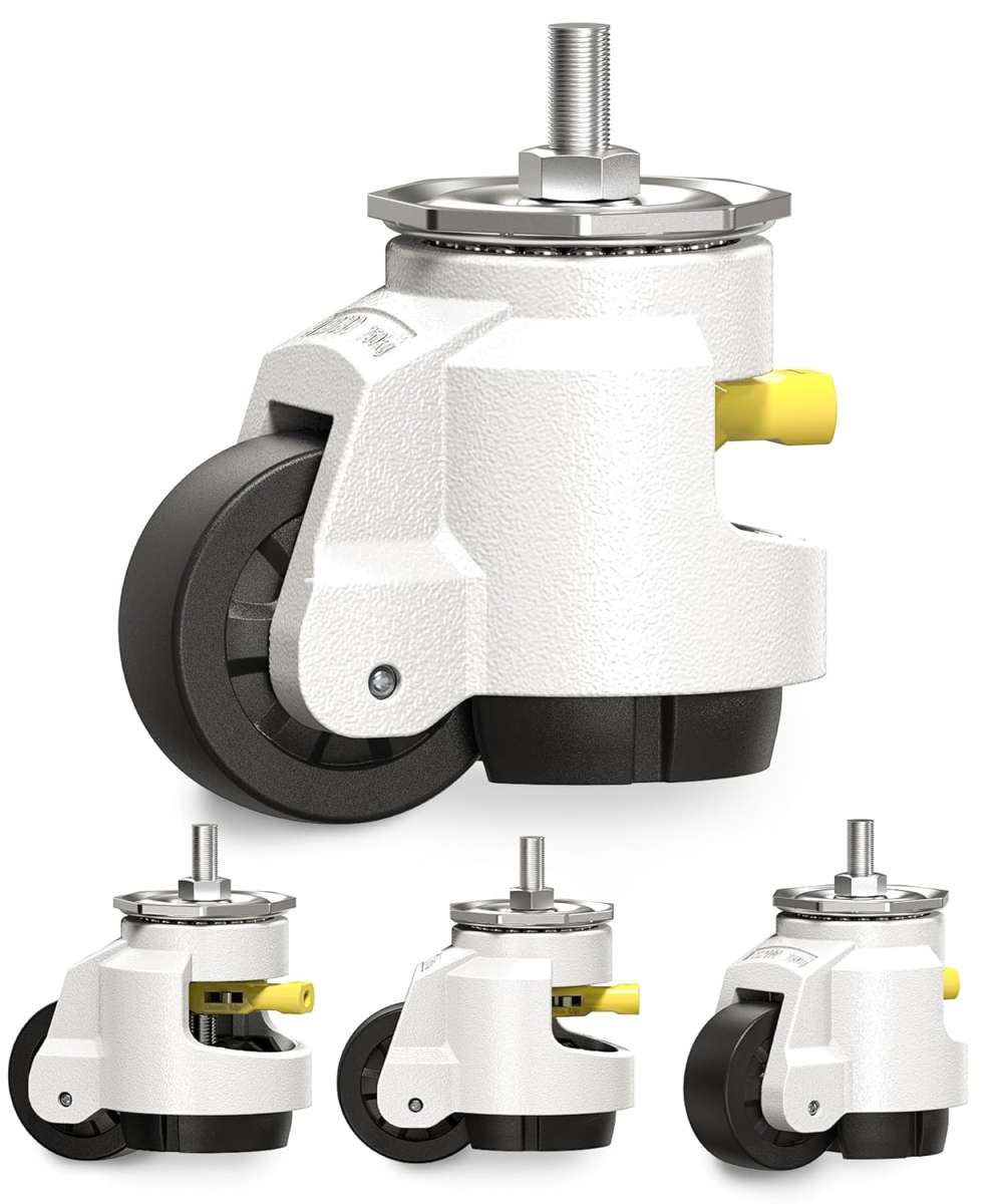

                                  IanT
                                    @iant
                                    That’s why I’ve purchased these Holkie levelling castors OM.  They can be jacked down once the machine is in position. Mine are rated at 250Kg each.
                                    Holkie Castors
                                    HOLKIE Castors – Amazon
                                    They are very reasonably priced and if they prove OK, then I shall probably get a set of the 562kg ones for my Victoria HO which is currently on steel rollers. Not sure what the HO weighs but although it’s obviously very heavy, I wouldn’t think it’s near 2250Kgs.

                                    #810562
                                    old mart
                                      @oldmart
                                      Those castors are a great design, hopefully they will not be needed often, but you will never regret having them. Both of the mills at the museum have been secured to the concrete floor for health and safety reasons. Neither of the lathes has been bolted down, but the Smart & Brown weighs 3/4 of a ton and we have made a strong shelf under the Atlas 12 x 24 stand to store lots of angle plates and chucks which has lowered the COG by 40%

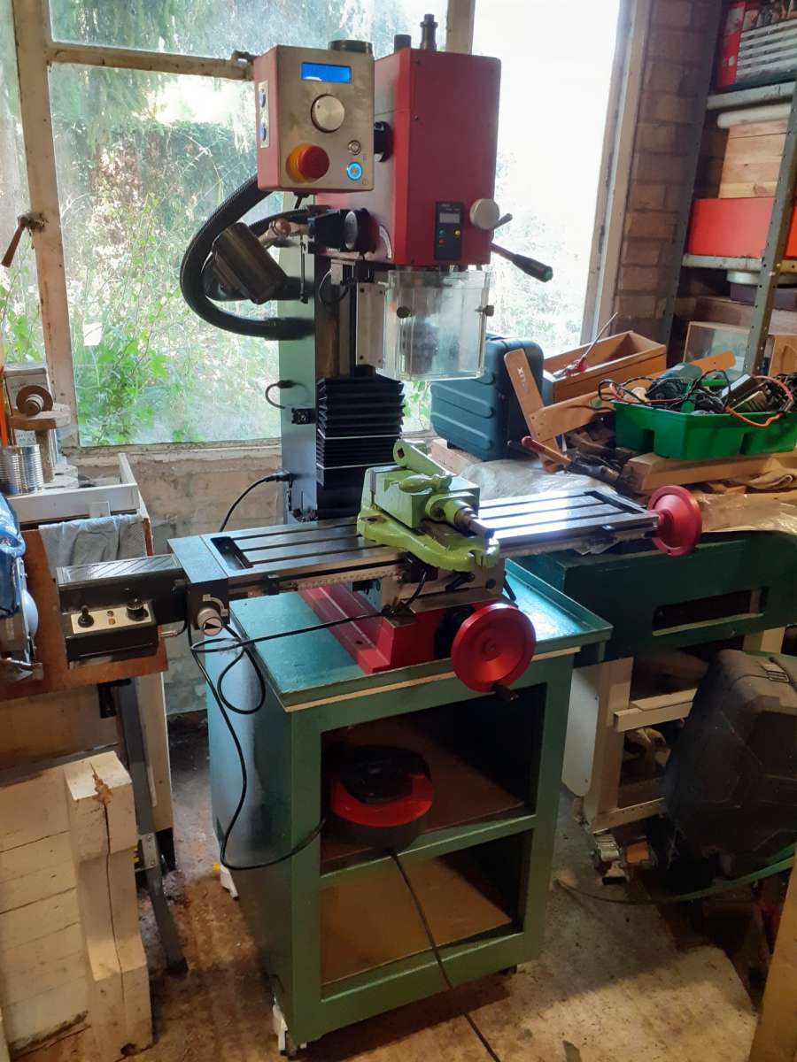

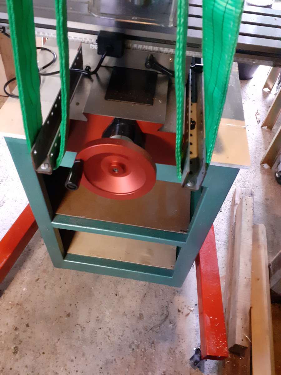

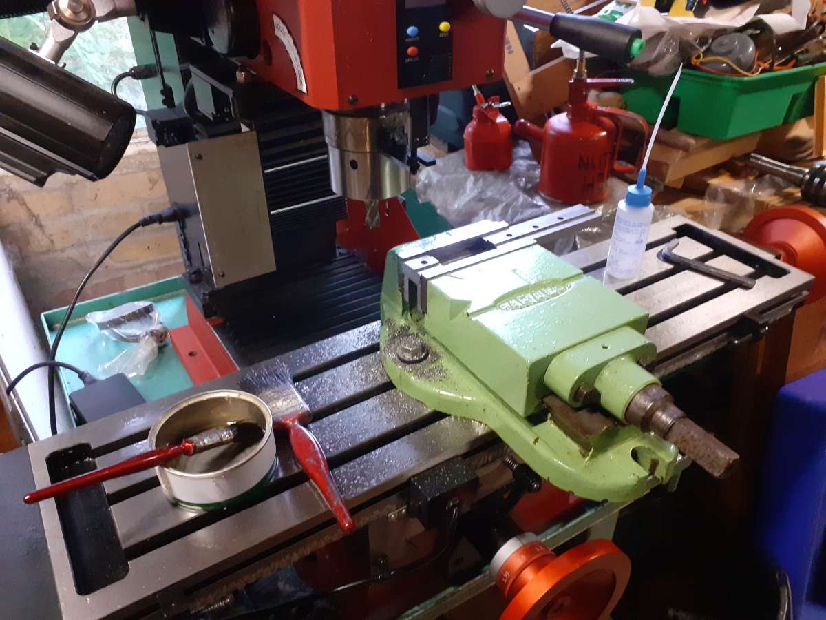

                                          #815670
                                          IanT
                                            @iant
                                            Well a quick update. I had to improvise some lifting bars to get the mill up on the cabinet without bending anything.
                                            Sieg_Lift_2
                                            Sieg_Lift_4
                                            Not her final resting place but I wanted to have a play…
                                            Sieg_First_Cuts2
                                            Upon which I discovered that the ‘safety shield’ very much gets in the way when you use end mills in a collet (and you don’t want to extend the spindle too much). So off it came and I side-milled the part without any problems…
                                            I’d like to keep the shield but not in it’s present form. I’ll have to think about some mods, possibly some kind of quick release I think…
                                            Otherwise everything seems fine!  🙂
