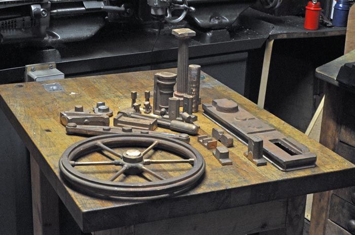

                                              #231489
                                              Roderick Jenkins
                                                @roderickjenkins93242
                                                Well, I had the drawings; now I've got the castings – from ebay
                                                smiley
                                                Rod
