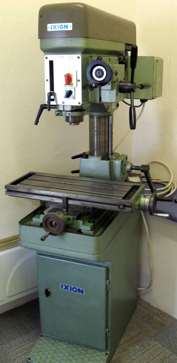

This was the mill I had in mind. One came up for sale used many years ago for a good price. Sadly too far away for me.
”However, they also made at least one proper, complete and very effective bench-top vertical milling/drilling machine, the Type BST-23. Weighing some 342 kg, the Ixion milling and drilling was very heavily built and modelled along lines established by Taiwanese and Korean makers – whose inexpensive and now ubiquitous Mill/Drills began to appear on the market in the early 1970s.”
https://www.lathes.co.uk/ixion/
A nice looking machine.

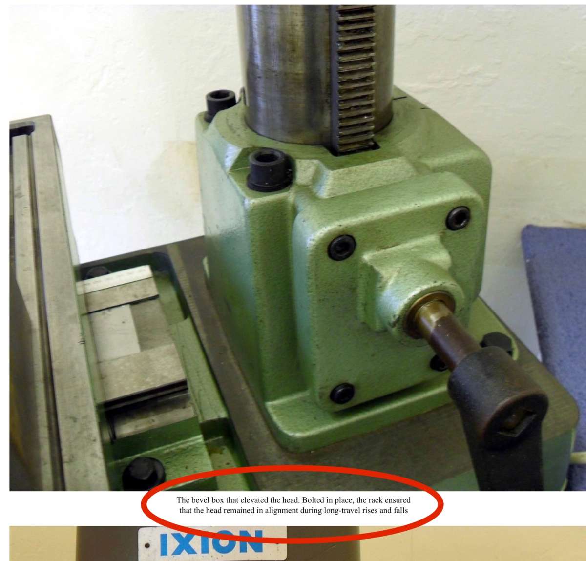

This was the critical feature the Chinese didn’t copy for some reason.
