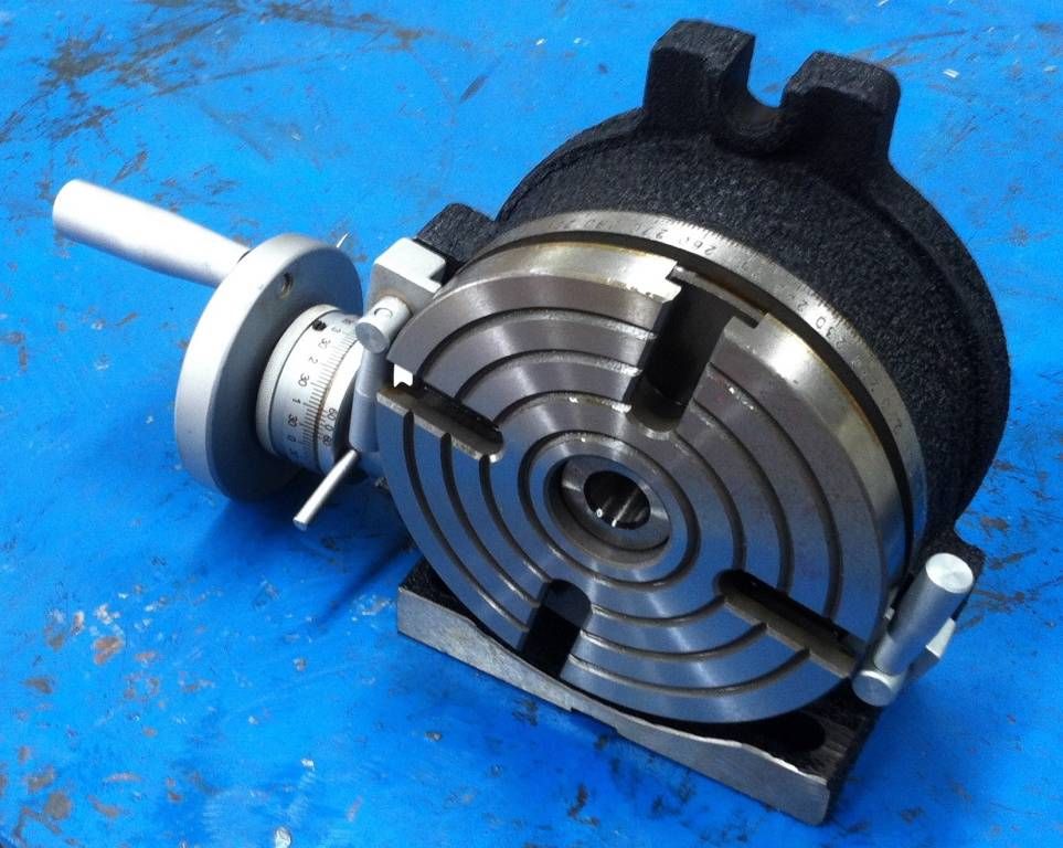

      Has anyone made a replacement crown gear for one of these rotary table. It is a 6" table made in Asia & bought on the internet from an importer in Australia who cannot supply spare parts. I imagine that I will have to machine a new one.  Paul.6in rotary table.jpg

        #207766
          I'm intrigued, Paul
          Is it really a Crown Gear that you need to make ?
          … I would have expected to find a WormWheel in there.

            Paul and Michael,
            I've had mine to pieces [for other reasons] and it is indeed worm and wormwheel drive in these tables.

                      The gear teeth are machined into a cylindrical inner part which is bolted to the rotary table. (appears to only be mild steel material and not hardened)
                      My table is similar to the Grizzley g1049 in the parts list which you called up but does not have ball bearings. Everything else appear to be the same so gear may be interchangeable.

                          Paul,
                          It looks identical to the one supplied by Myford which I bought some years ago.
                          I know it is a silly thing to mention but is the problem you have just simply sloppy meshing and are you missing the obvious in that the worm is on a cam to set the meshing? I can't really see why damage to the worm wheel will have taken place, the drive is so slow and lightly loaded and it looks well greased in your photo.

                            Paul, I couldn't see any damage to the gear in your photo. I take it you are aware the worm is carried in an eccentric sleeve so that the mesh between the worm and gear is adjustable. If the gear has slipped against the worm and damaged the tops of the teeth, there should still be enough material left to clean up without replacing the gear.

                              Dave,
                              There are about six teeth very badly damaged [roughly in the 310-340 degree area] … should be clearly visible if you click on the image to see it full size.

                                This is a generic style and there are going to be umpteen versions sourced from different factories in India and China, each with minor differences to improve the profit and compensate for errors in the patterns. Unlikely anyone would ever stock spares. Even a major importer probably wouldn't be getting them consistently from the same suppliers though their buyers wouldn't realise there were differences inside as long as the overall spec and price were met.
                                I should look at the options for grafting in a new worm and wheel from a standard gear supplier – if even remotely cost effective. Otherwise DIY or convert to a simple indexer.

                                  I think it is going to be a DIY.
                                  Will have to make a cutter the same profile as pinion and a jig to hold a new gear blank. Should be able to hold cutter in lathe chuck and mount gear jig on the cross slide. (a project which I did not plan on making)

                                    I was given a rotary table the same as this one that had suffered
                                    from some professional industrial vandalism and was slightly
                                    worse than in Paul's photo .I cut away the damaged wormwheel
                                    and loctited on a replacement ring and hobbed a new 1 module
                                    90 tooth gear .Hobbing unit in MEW 193 article ,similar hobbing
                                    system also in ME 108 by Brian Thompson. Cut away worm from
                                    original shaft new piece loctited on ,milled new worm in lathe
                                    using small cnc file and this cutting head ,no fiddling around with
                                    changewheels required. Lathe cnc convertion MEW 207 to 212.
                                    Photo's in album " Rotary table".
