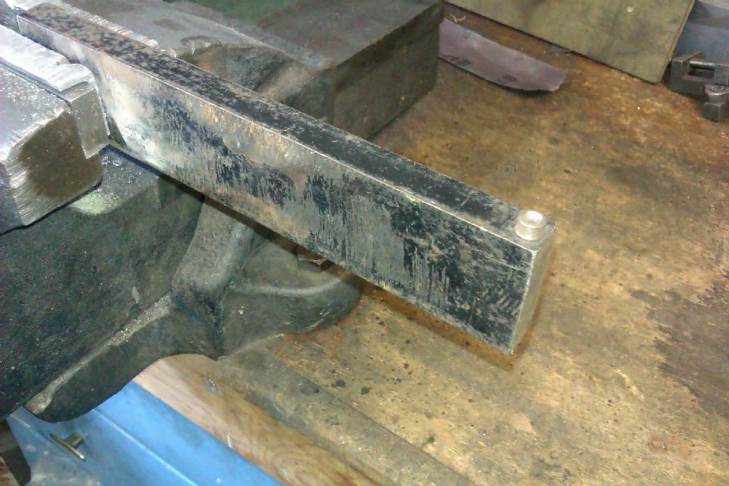

        i want to solid rivet a chimney, 6 inch diameter rolled stainless sheet, by about 24 inch long, close rivet along the londitunal seam, i'm gueseing i would need a jig , a beam going through with drilled dimples along it's top edje to locate the rivet heads ?
        anyone got any better ideas ?

          I use a peice of 3" diameter bar with a dolly in the end. You need a big vice to hold it though.

            Using some 6" tube and putting groove + some decorative rivets in would be easier
            Other than that, a couple of vices 24" apart with a length of barstock between them would give you a solid dolly to hammer on.

                As Boiler Bri says a bit of stout bar with a homemede dolly in the end is all you need. If they are very thick rivits you may need to put the dolly in the middle of a longer bar so the far end can be supported.
                If the chimney is going to get sooted up you can do it the other way with the factory head on the outside and just rough form the head on the inside with a lump of bar to pein it flat.

                  I sometimes made stove flue pipes by rivetting. Drilled the holes thru' both sides with a timber mandrel and jubilee clips to hold together. Slip of the mandrel ,put all the rivets in the holes, use a heavy pipe inside. the ends of this dolly supported. Easiest way is on two piles of concrete blocks, with a helper steadying everthing. Set the heads with a normal snap.

                    The rivits only need the raised round head on the outside, the head on the inside can be flat, look at an aircraft, its got thousands of rivits, both raised, and countersunk, the othe side is bucked up with a flat bar, seems to work. Although I was an engine mechanic, I still had to do some airframe work, like rebuilding wings fusilage etc. mind you we did use a pnumatic hammer/ rivit gun. Ian S C

                      thanks fellas, you have confirmed my idea, i'll post a picture of my jig, if and when.

                        Yes – react the rivets as per in aircraft construction. Any reasonably massive block will sufice to form the backs. No need for a jig, just a mate to hold the reaction block if you don't have a pneumatic rivet gun. Regards Mick
